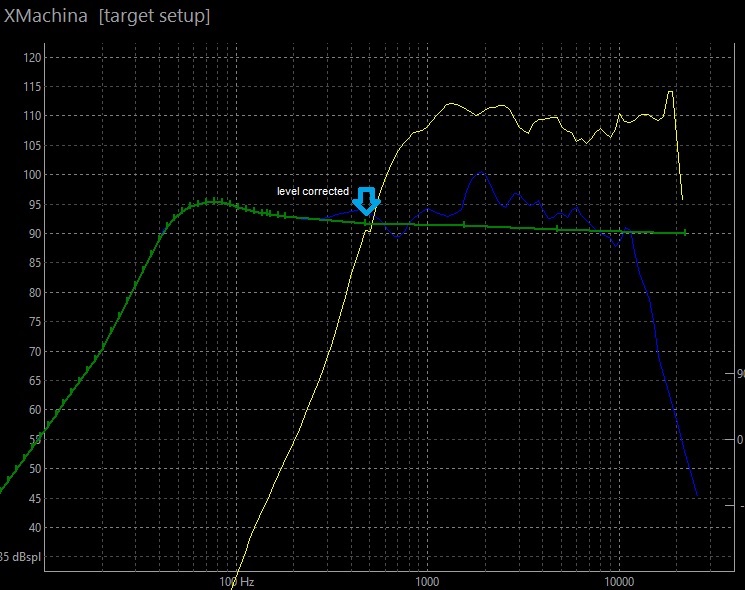

A quick filter synthesis for illustration. The blue curve is a system response for a filter designed with 5dB setting in "reverse phase dip required". The green curve is for 25dB. XMachina added 2 extra components to achieve this.
Use it or not, there is an option for such a target.
You can also find description for the "reverse phase dip required" parameter on page 24 in the pdf.

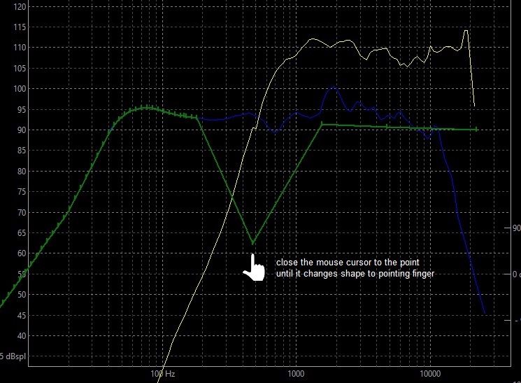

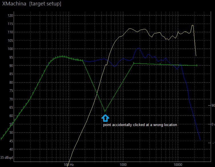

I'm dearly missing an undo function, especially in the target SPL setting. A click in the wrong place is made easily and results in having to redo the graph from scratch.
When you click a wrong place creating spl target there is really no need to redo the graph from scratch. The points of the SPL target can be easily corrected with the mouse. Let's take an example of a wrong clicked point:
940661d1618001463-automatic-crossover-designing-xmachina-trgcorr01-jpg
to correct this, at first move the mouse close to the point until the cursor turns into pointig finger shape:

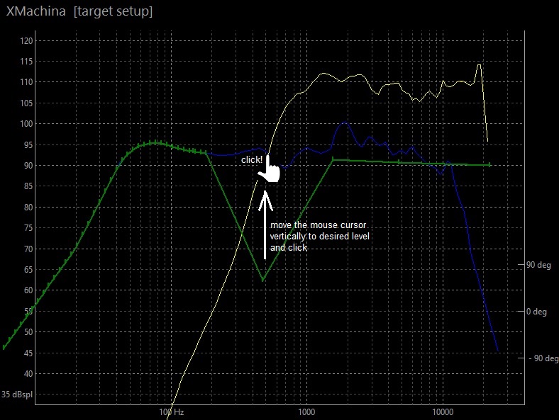

940662d1618001463-automatic-crossover-designing-xmachina-trgcorr02-jpg
move the cursor (do not drag) vertically to the desired position and click:
940663d1618001463-automatic-crossover-designing-xmachina-trgcorr03-jpg
the graph is corrected:
940664d1618001463-automatic-crossover-designing-xmachina-trgcorr04-jpg

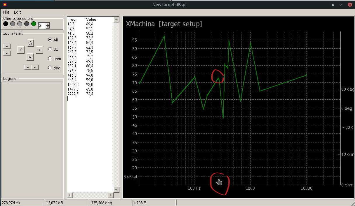

Maybe this is something that does not work under Wine:
1. Move mouse cursor near an existing point, cursor changes shape into hand
2. Left click and move mouse
3. After traveling a few pixels, cursor changes form back to cross; point is unchanged
4. On releasing mouse button, a new point is created in the new location
So it seems the 'grab' of the point is never performed and the click /release in its entirety is interpreted as creation of a new point.
Interesting thing is: if I click on the graph while the mouse is in drag mode (there is a small region around each point, the snap-in area), the point is moved. Due to the limited size of the snap-in area naturally only a few pixels.
After creating a lot of points by trying to drag them, I noticed another phenomenon. The snap-in is sensitive to the x-coordinate of the respective point, that is along a vertical line through the point.
attachment.php
That could be used as workaround to correct erroneous points :)
May I point out this again: do not drag the point. After the cursor changes into pointing hand just move the cursor up or down to desired level then make a single classical click. Be aware that the mouse cursor should be moved vertically so its snapping with the point is maintained. (This actually means that frequency of the point won't change)

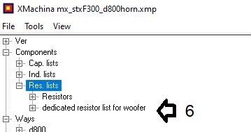

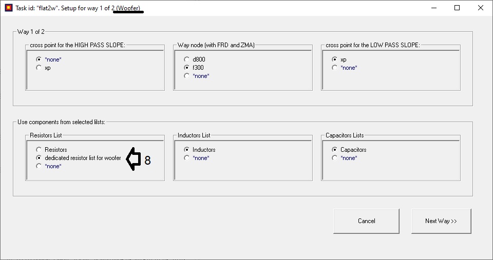

maybe an option "avoid any unbypassed resistor in series to the woofer" can be useful, just a though..
If a series resistor occurs, it usually has a reason. First it would be good to analyze what XMachina wanted to achieve applying it. Compare the system response with and without (shorting) series resistance, and how it relates to the defined FR and impedance targets. If this leads to any conclusions, make adjustments to the targets and restart the design process.

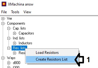

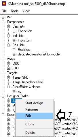

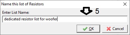

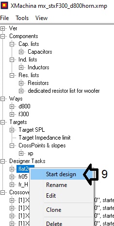

Or, you may try a workaround. Create a dedicated list of resistors starting with value of, say, 5..10 ohms (adjust experimentally). Then select this list in the woofer way settings and restart the design. Resistors with such values are unlikely to be used in series with the woofer because it would degrade the response too much. These values are still useful for other branches of the woofer filter.
