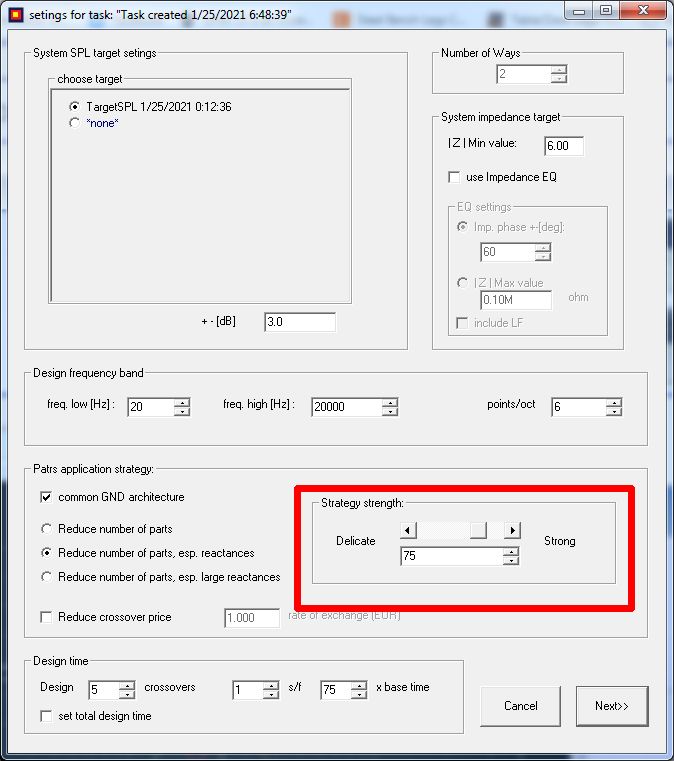

After a couple of years of using this software, I think this language change would really be helpful.
I think changing,
"Delicate" to "Complex"
and
"Strong" to "Simple"
would make a lot more sense.
Anyone else find the Delicate and Strong awkward/misleading/confusing?
Otherwise, great program!

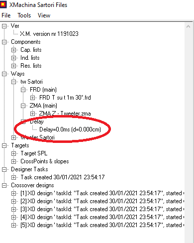

The process with using the actual measurements from each of the different drivers in the cabinet and use them in Xmachina is a very straightforward. Just one thing that is lacking is the distance from listening position to each of the driver (= actual driver offset).
It’s a little bit sad to read that the development of the software is under pause. Wishing for that to change. And wish for some offset management to be implemented. ��
I’ll need to measure them separately, and there are some different ways of doing this. As I have the exact different listening angles for both the tweeter and the midbass to the ear I could put the mic at exactly that angle for each of the measures. The tweeter at appr 1,29 degrees up and the midbass 4,26 degrees up at exactly 1 m each. That might do it. But that is because I have designed the cabinet so with a listening position of the ear at 1000 mm above floor there is no distance at a between the position of the different driver diaphragms to the ear. But with the ear or listening length to the speaker that will change. And if it’s a difference between the length from the different drivers to the ear it would be great if the feature asked for could to be there in the software. I think 🤔

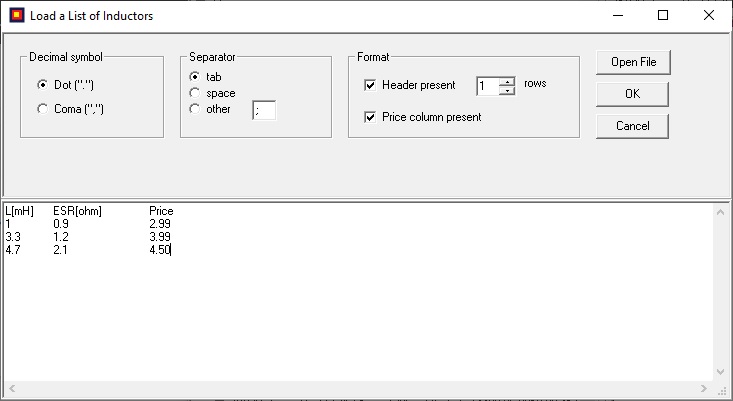

On Jantzen audios homepage there is an export for their (air) coils which is interesting. The problem is that they make thousands of different coils, which most of them are not sold anywhere I know of. So they have sorry to say no "Mostly sold" list. And trying to import it to Xmachina I got a thousand error messages telling me that the value wasn´t that useful in XO designs 🙂. So that seem not to be a good idea to import the whoel Jantzen audio air coil production list.

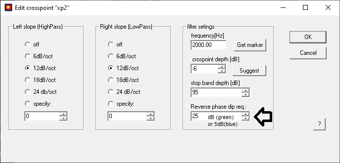

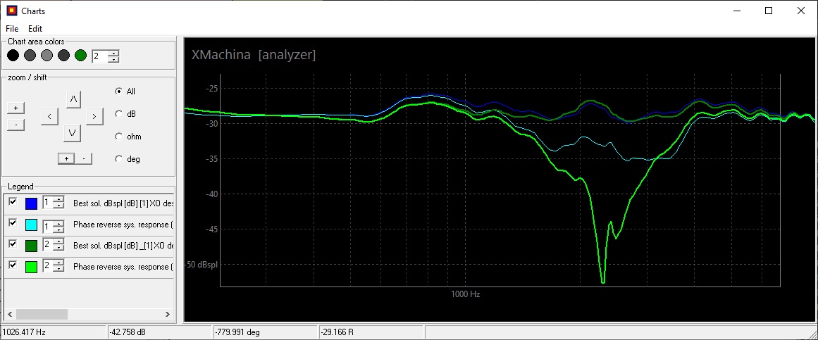

Hi there, can someone please explain what the "Reverse phase dip req." is for when setting left and right slope targets and what it's purpose is. I've been playing around getting some results but need to know what this actually is for. I've watched the YouTube example but it has no explanation.
A quick filter synthesis for illustration. The blue curve is a system response for a filter designed with 5dB setting in "reverse phase dip required". The green curve is for 25dB. XMachina added 2 extra components to achieve this.
Use it or not, there is an option for such a target.
You can also find description for the "reverse phase dip required" parameter on page 24 in the pdf.
Check the units. Consider a component table like this :
attachment.php
The intention of table creator is clear however the inductance values will be interpreted as 1H, 3.3H, 4.7H (i.e. 1000mH, 3300mH, 4700mH respectively). You probably won't be able to design any sensible crossover with components like these, hence the warning.
The solution is to change "1, 3.3, 4.7" to "1m, 3.3m, 4.7m" or "1mH, 3.3mH, 4.7mH"or 1E-03, 3.3E-03, 4.7E-03" as you prefer.
