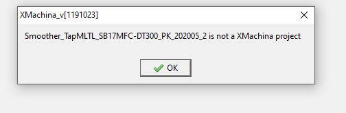

And also, all my previous designs are gone.
Can´t see/get the FRD and ZMA etc up, and the projects are no longer projects according to Xmachina. How do I solve that?

maybe the file was opened in a text editor and saved with non-ANSI encoding? ...
I doubt that. But I didn´t use the program for some months, the computer maybe was updated etc etc etc so anything can have happened. I can try to open them and save them with non-ANSI encoding (if I figure put how to do that) and see if things change.
