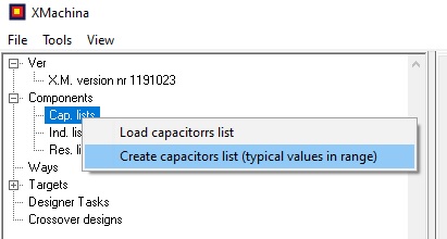

Generating component lists is fast and easy and quite enough until you're experimenting and playing with XMachina not willing to implement any of the results.Ok,
Are there any usable lists of components "out there" that you know of or do I just gererate one (which will not contain prices)? If there are lists it really doesnt matter if it is in the correct currency or even available here in Sweden as the price etc can be used for evaluation rather than buying.
I see the following benefits of using defined component lists:
1) it's possible use real values of coil inductance and esr in the design which are often far from typical values.
2) There is an option of optimizing circuit price.
3) Entering reference numbers in the component descriptions makes placing order easy and fast.

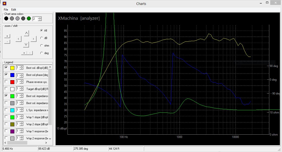

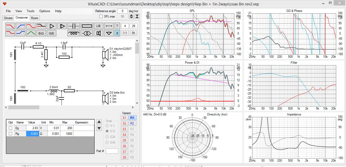

Some intersting results in the picture

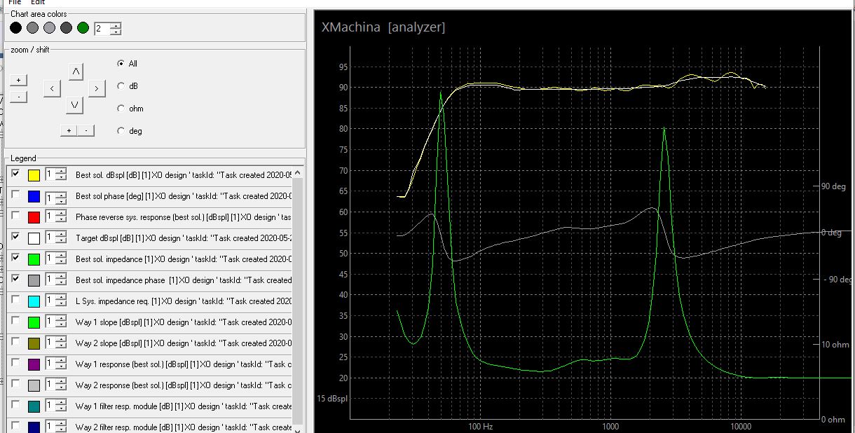

And now it´s gone again and there is no "Circuit" node in the Design task node for the ongoing design. So how do I then open the graphs that are constantly updated in the ongoing design task??????
the "circuits" sub-node appears after the design is finished. ongoing design characteristics are on the design chart window. if the window was closed you can reopen it choosing "options/show graphs" from the menu above the progress bar. It's possible to display characteristics of a finished design even if there is ongoing design. click with the right mouse button on the "circuits" node to see the options. The characteristics will appear in a separate window and won't mixup wit the characteristics of ongoing design.
That was the problem. I did identify this Options/Open graph directly but it didn´t work. Nothing happened!
It means that your window wasn't probably closed but just minimized. To restore it press this:That was the problem. I did identify this Options/Open graph directly but it didn´t work. Nothing happened!

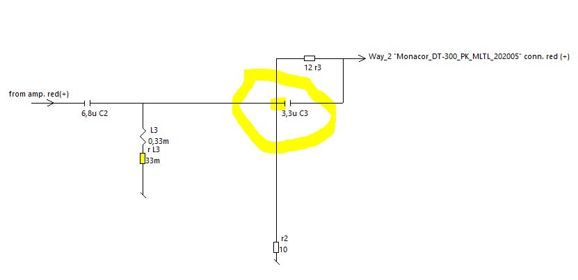

1) Is the yellow mark at the picture a connection point or just two wirings passing by each other?
There are no "floating wires" in XMachina. Any crossed wires should be considered as connected.
I was thinking of such feature but it wasn't eventually implemented. Possible reason is that crossover circuit is usually only a few parts and transferring it to any external tool takes a minute.2) Is it or will it be a way to export also the wiring diagram, and not only the list of material?

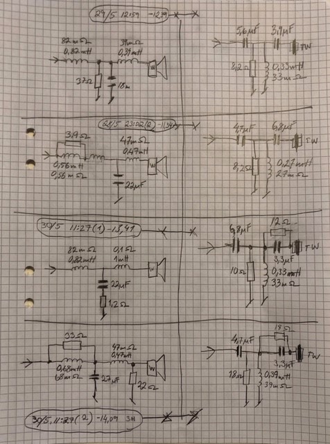

Also interesting after about 10 different run (with different 16 schemas) on the exact same set-up, except for different settings for time, and some smaller differencies in steps/oct I have now 4 very good different suggestions. These are all very good in response, phase and impedance - but very different. Interersting tast to select

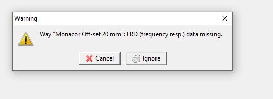

Once again I stumbled into a strange problem.
When I sat the offset to 2 cm I got an error that th FRD data is missing. Ok, then I change it back to 0 - But the error message doesn´t go away. THe system think the value still is set to 2cm, even after closing and restarting.
How do I to dissappear?
