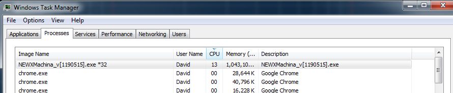

Is there any way to speed up XMachina?
I am using a 3.4 Gigahertz Intel Core i7-3770 with 8 gigs RAM and XMachina is only using 13% of the CPU while the remaining CPU power remains idle.
New version of XMachina [1190701] can benefit from multi-core architecture of a PC system. Usually, when working with XMachina, it is configured to deliver several solutions. They can be designed in the same time by different instances of XMachina working simultaneously on different cores.
It was also possible with the previous versions but it was required that each instance of XMachina had it's own copy of the design file. Keeping control over design when the data is spread on (for example) 8 files was problematic.
The problem is eliminated in the new version. Introduction of storage mediator allows that many instances of XMachina can write to the same design file.

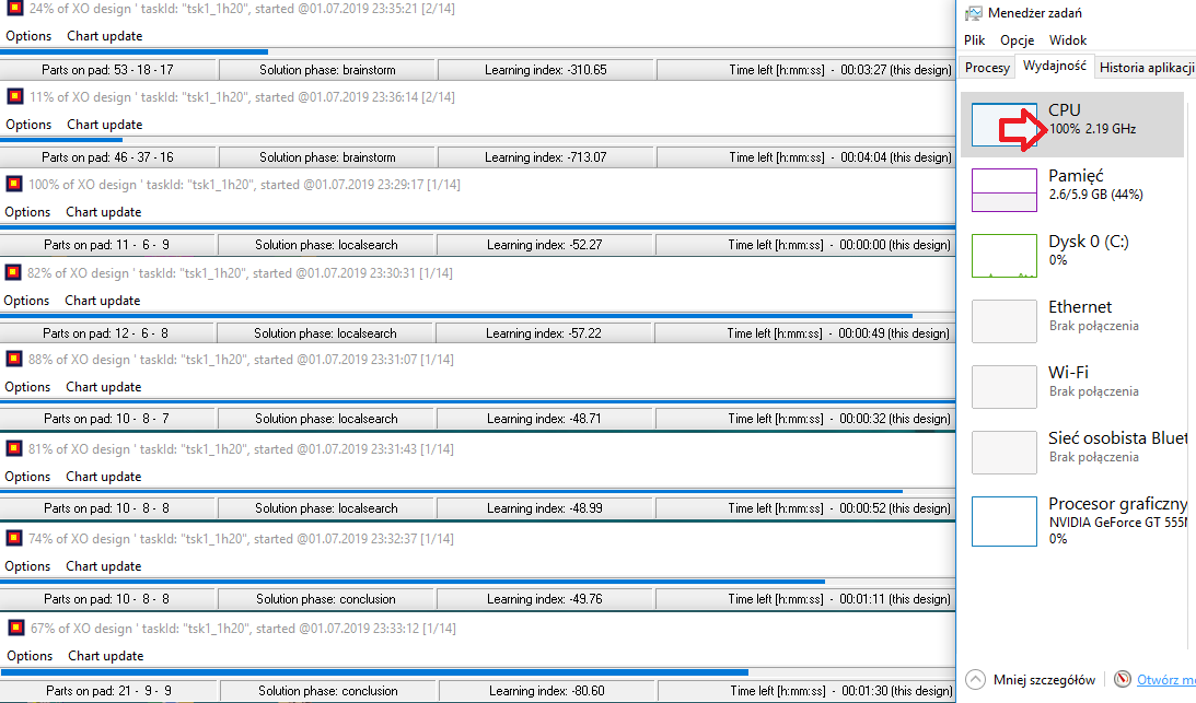

To benefit from parallel processing with XMachina_v[1190701], follow these easy steps:
- crate a design task and save the design file,
- start the design,
- start a new instance of XMachina, open the same design file and start the design,
- repeat the last point several times (but avoid starting more instances of XMachina than number of cores in your system),
- when all the instances are finished with their processing close most of the instances leaving only one,
- reopen the design file choosing the first position from the "File/recent" submenu,
- expand the "Crossover designs" node to see all the designs.
Attached: XMachina utilizing 100% of an 8-core CPU for designing several solutions for the same task:

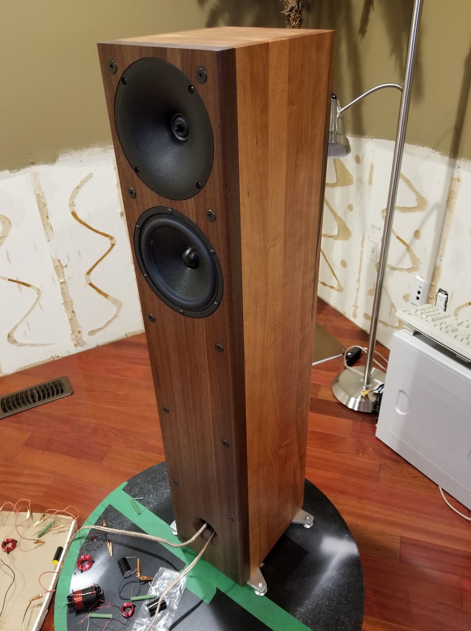

Thanks Xmechanik!

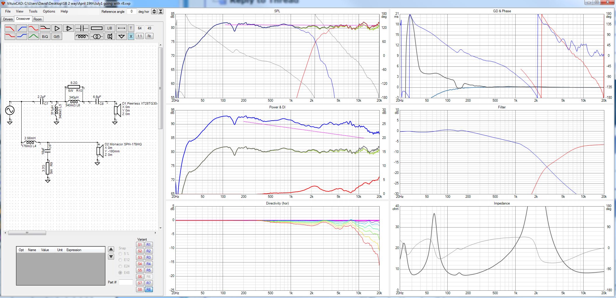

Here is what your program came up with transposed into VituixCAD for my latest build, a 1.25 cubic foot slim tower (yes, room is under renovation)...

The "number of cores" should be actually understood here as the number of physical cores. I've been playing with the parallel designing feature for a while and I've noticed that starting more instances than the number of physical cores slows down previous instances noticeably. The number of cores shown in the task manager window could the number of logical cores, that is 2 times nr of physical cores, if the HT technology is implemented in the CPU. HT can be ineffective with XMachina.

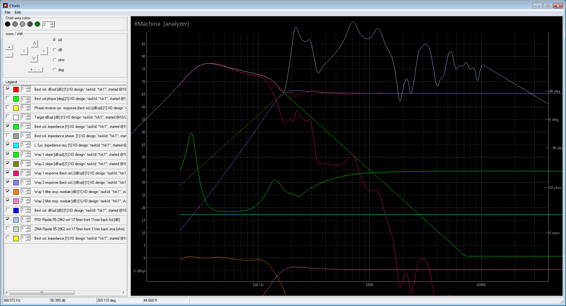

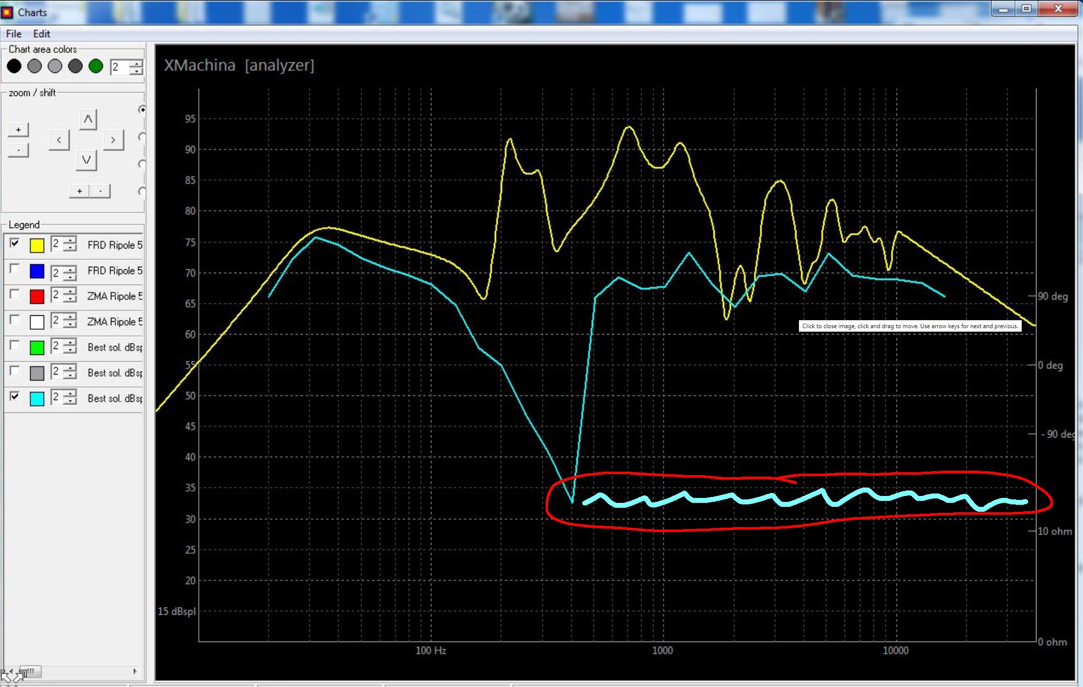

Hello,
I was using an older version of ZMachina and tonight I downloaded the newest version.
I am trying to see what it would take to tame this dipole woofer model and in the older version I was using the SPL didn't jump back up after the slope for the woofer, now it does.
What changed or what am I doing wrong?
Too little information to discern anything. Is the blue curve related to the whole system or a single way? Is the yellow one related to the woofer without a filter? How does the woofer filter look like? What about it's electrical response? What was the id of the previous version that was giving you different plots? Can you paste those plots for comparison? Wouldn't it be better if you attached the whole design file so that I could have a look and assess if it's a bug or other problem? (Or if you prefer you can email it to xmachina.ai@gmail.com)
Joined 2018

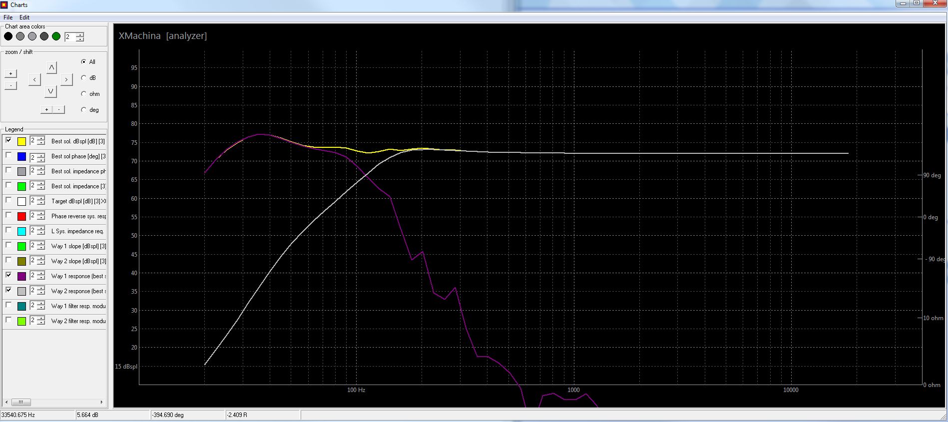

Here is the response with everything else the same in version 1181114,
I couldn't upload the saved file, so I will email it to you.
Ignore the version stamp on this image. I loaded the file from the image above into 1181114 and reran the program to generate what you see below.

I’ve got your attachment and here are some findings:
-only one way in the file (woofer),
-target curve is set in 20-20k range,
-a cross point created.
Nothing is wrong so far, but now there’s something that makes XMachina confused: the low pass slope of the cross point is attached to the woofer and it's pushing spl down. But there is no next way to keep spl on the target level behind the crosspoint (I will implement a warning for such situations). So either the cross point slope will be violated (exceeded) or the target spl won't be achieved.
My understanding is that you want to make initial experiments with the woofer, but not yet having chosen drivers for the next way. For such experiments you can substitute not existing way with a flat response frd and zma then try to cross it with your woofer. Creating a flat response is actually very easy, just add a next way then right click on the frd zma nodes and choose “set flat resp.” from the menu.
To see a result of this approach have a look at the attachment. Remember that when you have real Way2 frd&zma characteristics the whole crossover will have to be redesigned.
Just another technical comment that it’s better not to open a new design file with an old app version (unfortunately no warnings were implemented for this). In your case, the design file is pretty new (it has “common GND solutions only” feature) and it was opened with a version that is one year old. This may cause some unpredictable side effects as there are internal changes in the design file format.

Joined 2018
XMechanik,

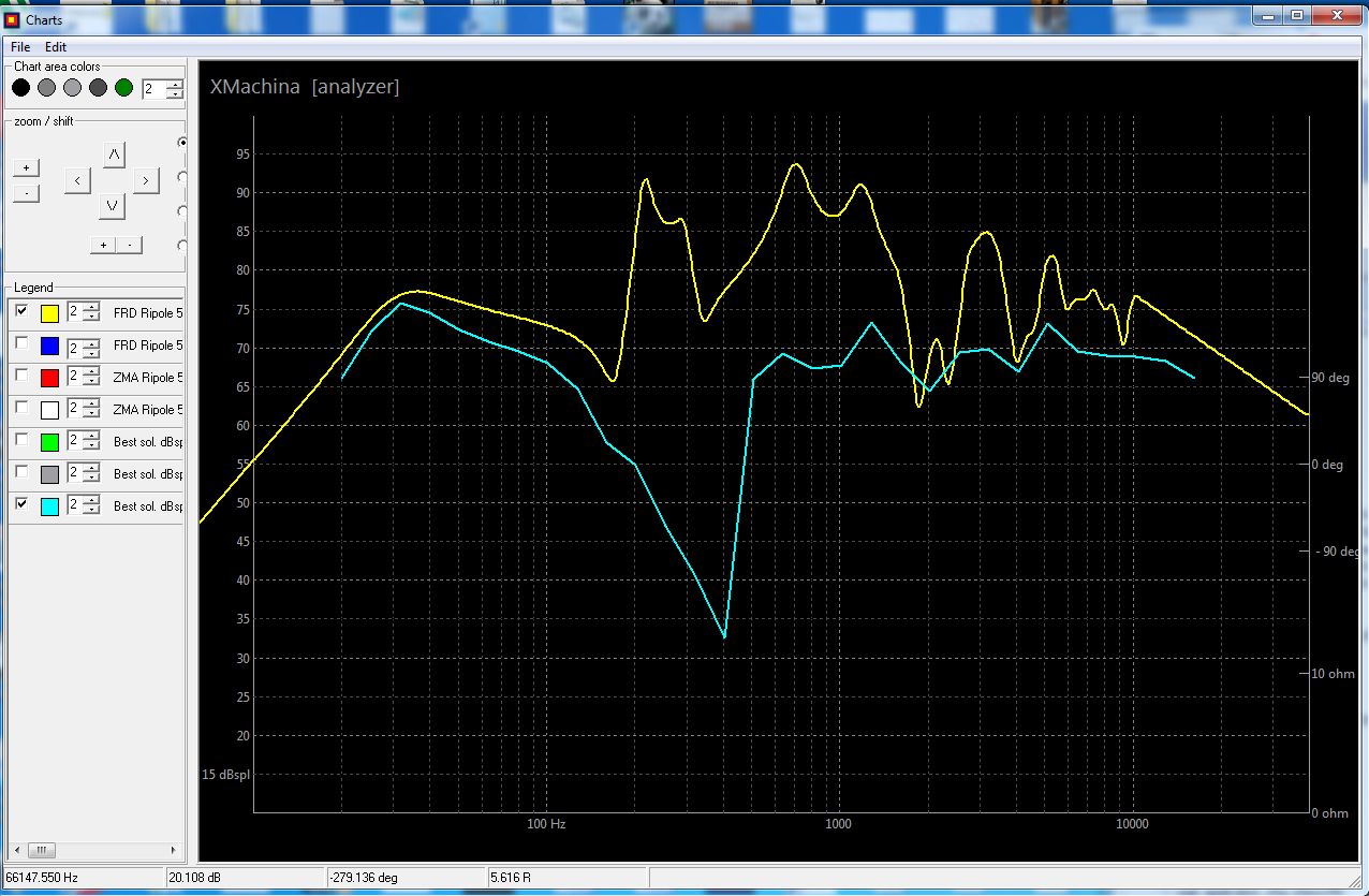

Thank you, I now have it working by making it a two way with the second way flat.
Yes, I was just testing what could be done with a woofer sim from AJ Horn 7 before I built the enclosure as it is unusual (four woofers in a stacked dipole).
I wanted to get a feel for what it might take in a crossover to tame the somewhat wild response.
Thanks again,
David.
