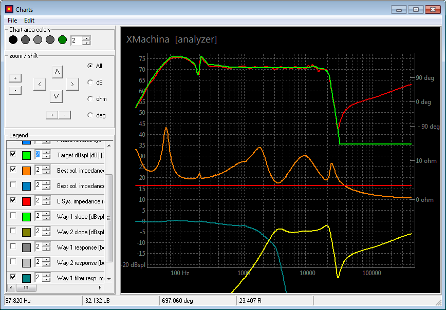

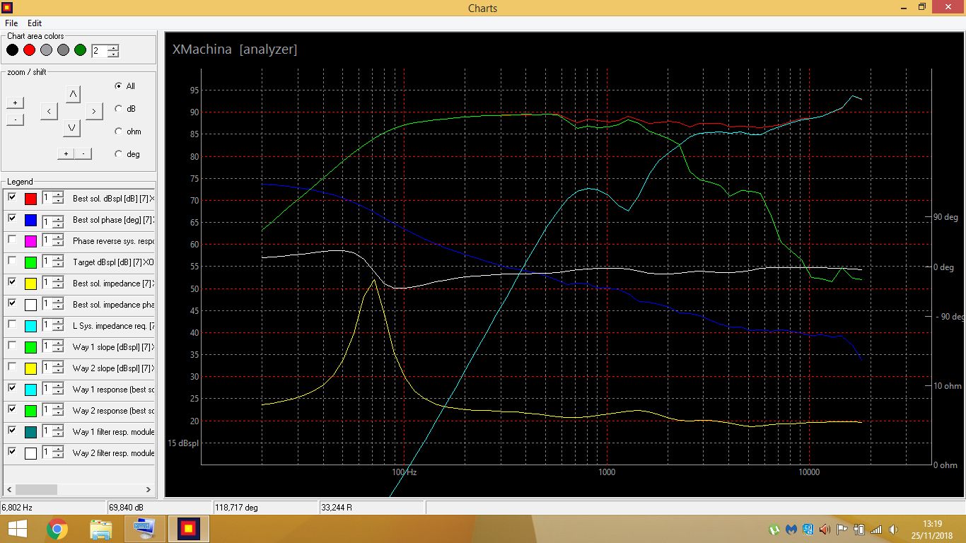

2) With the new version it’s possible to extend frequency range beyond the design range in the [Analyzer] window. Note that edge values of the characteristics are used, so it's only an estimation. It may help to spot some issues nevertheless. In the following example a low pass filtering was intended at the edge of tweeter band to suppress metal dome resonance at 26kHz. In the extended chart it appears to be implemented as a notch filter (green curve is the target, red is the result) which needs a slight correction to hit resonance frequency.
attachment.php
There is also an issue with the system impedance (orange), apparently filter circuit shorts amp output for high frequencies.
To extend freq. range for analyzer window right click on a completed design node then choose "Set freq. range for Analyzer" from the menu.

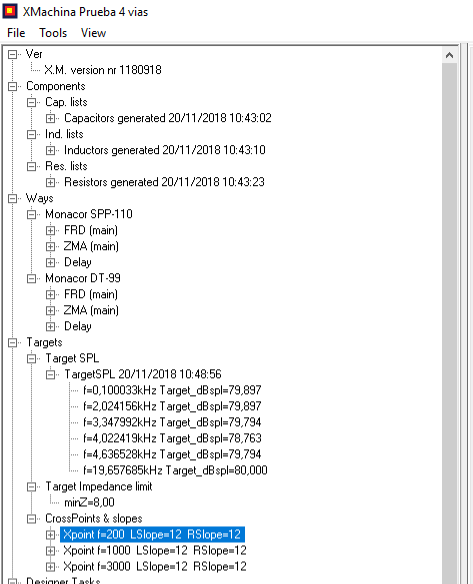

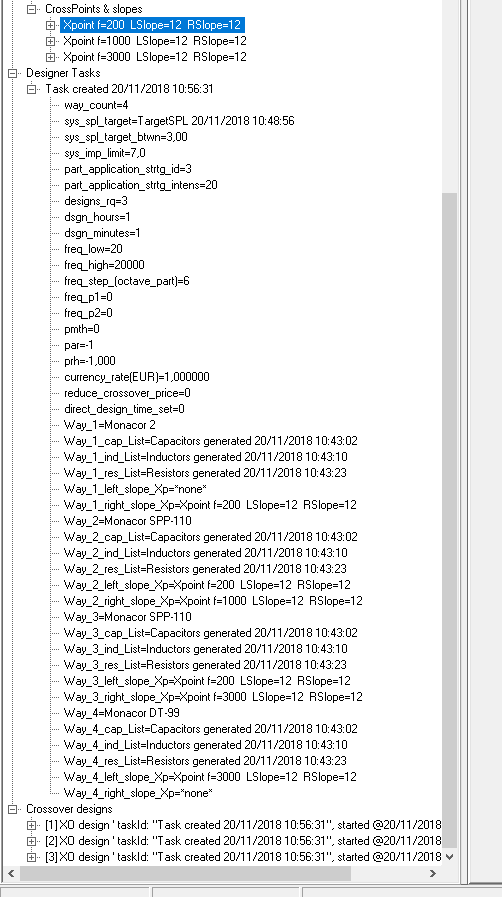

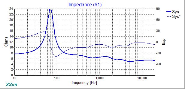

Hi all! Really a very interesting piece of software......I'm trying to simulate a very strange configuration and I do not know how to do it: the idea is two speakers in parallel to cover the lows, one speaker covering low mids, one for upper mids and a single tweeter. 2 problems arise, one is how to sim the pair in parallel and the other is that the software doesn't show the response from the 3 first speakers, actually shows like being disconnected. One picture is better to show it....
A few remarks on what I can read from the screenshots.
  • The dBspl target curve starts at 100Hz and the first cross point frequency is 200Hz. I would suggest to extend the target dBspl curve at least to 20Hz, where your design frequency band starts. You can just follow your woofer characteristic (it's in the background in the target setup window).
  • Creating low frequency cross points may require to extend component lists with appropriate values.
  • In components application strategy settings "reduce large reactances" is chosen which may not be the best choice for ~200Hz cross point. First or second options seem to be more relevant in this situation.
  • System impedance limit is set to 7R. Be sure to use 8ohm drivers for such setting, especially if you're aiming to achieve full dBspl from your drivers. If you want to use woofers in parallel you will have to apply 16R woofers. Or reduce minimum impedance target to 4R in case the woofers in parallel are 8ohm.
  • Using 2 woofers connected in parallel as a single way is OK if .zma and .frd can be measured for such configuration.
  • Possible reason for "disconnecting drivers": in 4- or more way system (I didn't try more than 5) there are usually large overlapping regions between drivers. Part reduction is one of the targets. If the filter slopes are moderate it may seem attractive for XMachina to remove the whole way, saving on components and making a small gap on the system characteristic. There are two ways to prevent such situation. Either reduce part removal intensity in task settings to keep moderate filter slopes, or increase the slopes so no way can be removed without making noticeable gap in the system spl.
  • For 4 way design use at least "average" design time for testing task settings. When the results start to be good, use "detailed" design time option to get final solution.

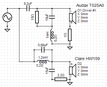

Joined 2018

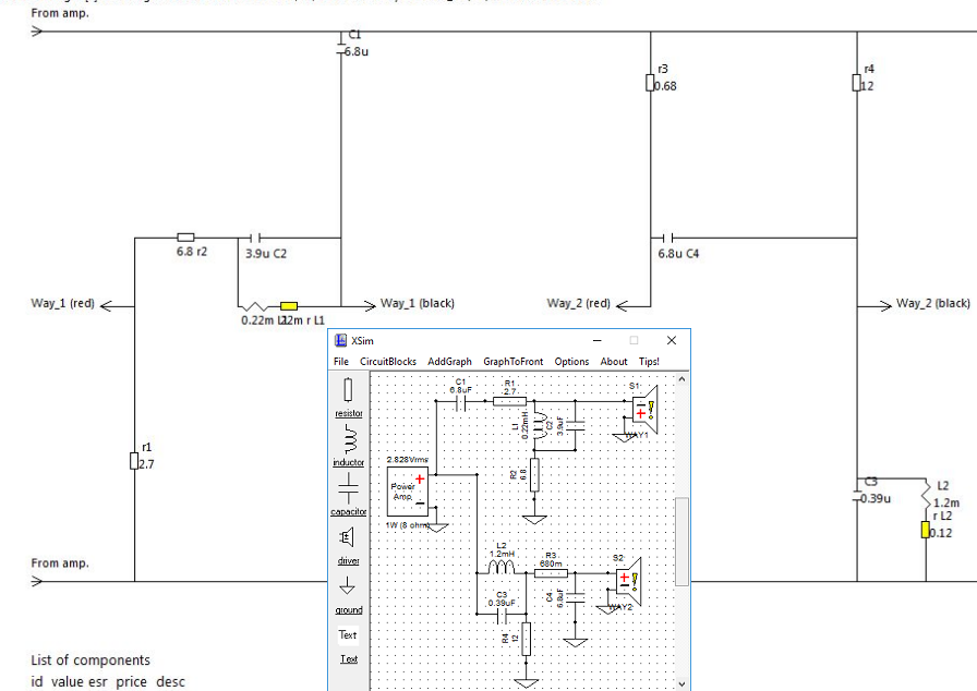

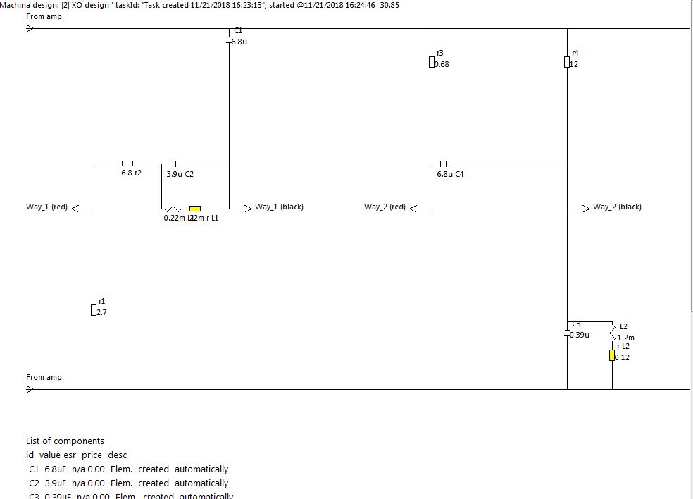

Confused about Schematic?
Here is the schematic from Machina and I cannot make heads or tales of it.
Can someone turn this into a schematic like I would use in Xsim or Vituix?
  • Nov_20_save_point_most_simple_yet_another_good_one_in_phase_yes_yes__XO-schema.jpg
Some transformations may be applied to increase the readability of the schema.
The following equivalent circuit was obtained by swapping places of few components in branches. One of the amplifier's output was grounded.

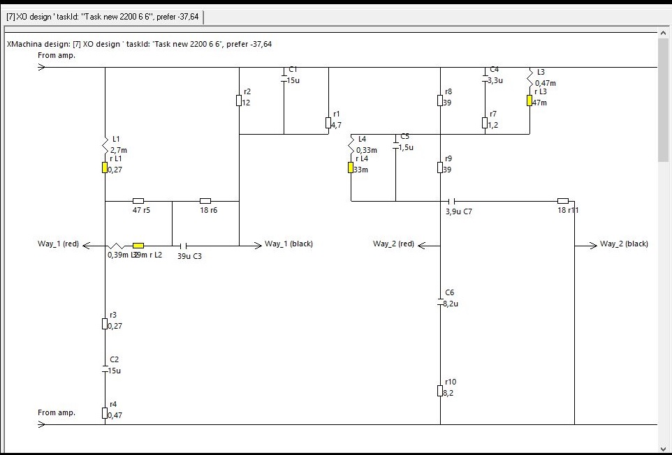

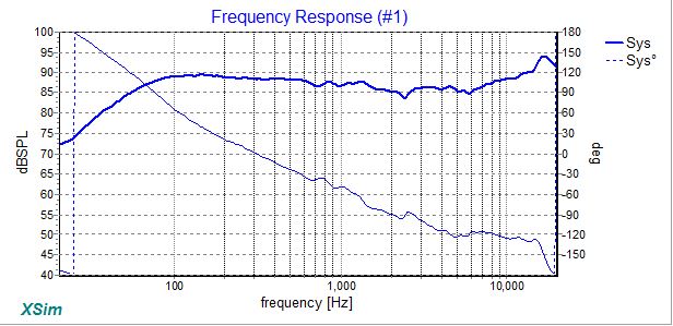

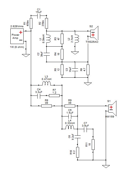

Xmachina can give solutions that a regular guy can't possibly come out with, not even in a million years. Then, is up to the user to choose the ones that are Ok, and discard the no-no ones (resistances in series with the woofer, very tormented Z module/fase, etc.) Besides, the filter presentation is a good oportunity to excersise into follow a circuit, what is in series or shunted with what, that you can re draw in a foil of paper, in Xsim, or other simulator.
