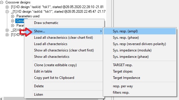

Would it be feasable to implement a feature somewhere in time that clear out the chart window?
Click on the "Legend" panel with the right mouse button then choose "Remove All" from the context menu.
It's also possible to remove a single characteristic: right-click on a characteristic name inside the "Legend" panel and choose "Remove".
When you compare different solutions it would be great to start with an empty chart and just add on the few things that are in focus for the selected one.
You can add characteristics one by one. From the "Circuits" context menu select "Show..." and you'll get a submenu where you can choose type of characteristic you want to display.

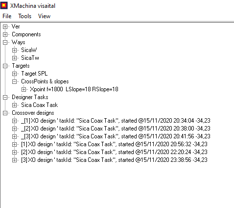

When I sat the offset to 2 cm I got an error that th FRD data is missing.
"FRD data is missing" is not an error it's a warning. When "create a new task" is chosen, XMachina prepares a list of Ways existing in the design file to make it available for selection in the design setup window. It is checked if all the Way nodes have relevant data loaded. If something is missing this warning appears. To make it disappear you have to load frd into the Way node. Or if you do not intend to use the uncompleted node you can safely ignore this warning.
I change it back to 0 - But the error message doesn´t go away. THe system think the value still is set to 2cm, even after closing and restarting.
The design file is autosaved just after starting design that's a possible reason why this delay value recovered after closing. But you should be able to change it after reopening.
I think that "missing FRD data" warning has nothing to do with "Delay" parameter issue, they came out together by coincidence.

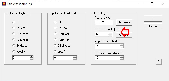

XO slopes above output
I have once again run into some mysteries.
Now when I am setting the slopes for the XO they always land above the output. Regardless of how I set the XO set up. Tried even both plus or minus of the same dB value but it came out the same. What do I do wrong ?
Left slope... is that the slope that slopes left or a slope to the left? 🙂 If only one slope?
Unconventional naming - seldom seen, if ever... maybe for a reason...
I found that interesting too. As I figured it out it is the slope that is "sloping to the left", which mean the right slope (High pass). 😉
Maybe it´s and English expression that we sweedes doesn´t grasp. 🙂

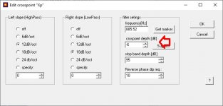

Check out "cross-point depth" parameter. It's -6dB by default so the slopes begin 6dB above the target, if it has positive value then slopes start below the target.
Ok,
But for me - (minus) mean lower. So -6dB is 6 dB lower than the output. But that´s just me 🙂
Also I did change to both plus and minus but couldn´t see a difference. Must have made something wrong apparently.
This is an "edit crosspoint" window, so the "left slope" is on the left side of the crosspoint and the "right slope" is on the right. I thought (mistakenly, as it turns out) naming it in that straightforward way makes everything look clearer.
After changing input parameters you have to start a new design to see any effects.
Well you are right if we wright in this way:
The High pass slope (that belongs to the tweeter) of the filter is on the left (leaning left) side of xo position in a chart/diagram because it is there it should NOT let tweeter frequencies pass.
The Low pass slope (that belongs to the woofer) of the filter is on the right (leaning right) side of xo position in a chart/diagram because it is there it should NOT let woofer frequencies pass.
But I agree, it gets a little bit confusing in the Edit crosspoint window. In a chart/diagram the tweeter frequencies are to the right but in this menu they are handled to the left. Although the naming is correct in each part of the menu. Maybe just switch places of the two (in a 2-way) menu parts.
There is a small button with '?' at the corner of the crosspoint editor window. Press it to get quick sketchy reminding of what's what.But I agree, it gets a little bit confusing in the Edit crosspoint window.
