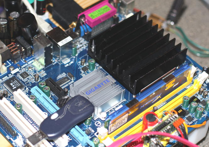

It uses E2140 and the system is based on manual posted here: http://photos.imageevent.com/cics/v... art of building Computer Transports v0.3.pdf
In my main setup, I switched to E7200 chip with Gigabyte motherboard, which is better. It also runs very cool and only small heatsink is required (no fan need).
Peter,
I'm very interested to see where you go with your main system unit.
I was inspired by your earlier version and recently powered my cMP2 with 4 seperate linear supplies... two based on 100VA Hammond transformers powering the PicoPSU and the P4 connection on the motherboard and two smaller ones powering the harddrive, USB, and touchscreen. Adding these provided a significant improvement in sound quality.
I'm currently sorting out my D-to-A conversion optionstrying a few options, but one of my next goals is to make a case that will do a better job than the Zalman in controlling vibration and shielding the various sections from each other.
Thank you for providing the link to cics's work and for your inspiration in how to improve it further!

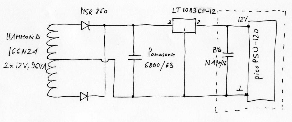

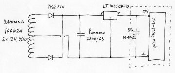

There were some inquieries with regards to linear PS I used in this setup: http://www.diyaudio.com/forums/showthread.php?postid=1787133#post1787133 so here's the schematic.
LT1083CP-12 seem to be hard to get these days; I got mine directly from Linear Technology as samples. Both the regulator and diodes need to be mounted on a heatsink.
I remove two small caps from picoPSU and installed there single BG N 470/16
