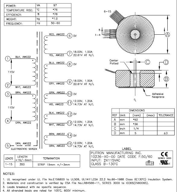

Peter Daniel said:Here's a more detailed view, not all components are installed yet.
Hi, Peter
I got one plitron 97w transformer. It has 18V*2 and 12V*3. Can I use it build your buffer?
you can draw a continuous 300mAdc from any or all of the 12V windings.
Similarly you can draw a continuous 370mA from either or both of the 18V windings.
This will easily supply a few buffers and headphone amplifiers.

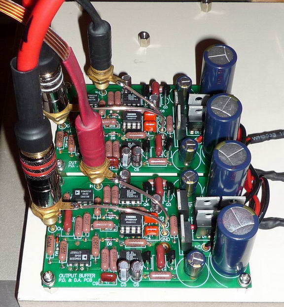

Hi,peter
i finished my buffer got from you.
i running it over 50 hours. sound like you said.
but, i feel the middle range sound density less than to connect USBDAC directly.
