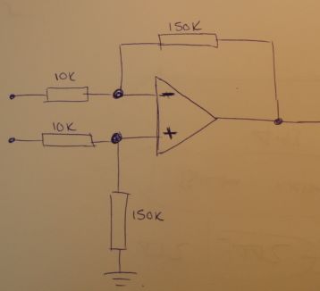

balanced input
I thought this might be a simpler way to do balanced in
mike 🙂
nobu said:Peter, If I wanted to add a balanced input to your amp, how and where would i do this?
mike 🙂

Re: balanced input
The inverting input impedance is 10k.
The non inverting input impedance is 160k.
no.mikelm said:I thought this might be a simpler way to do balanced in

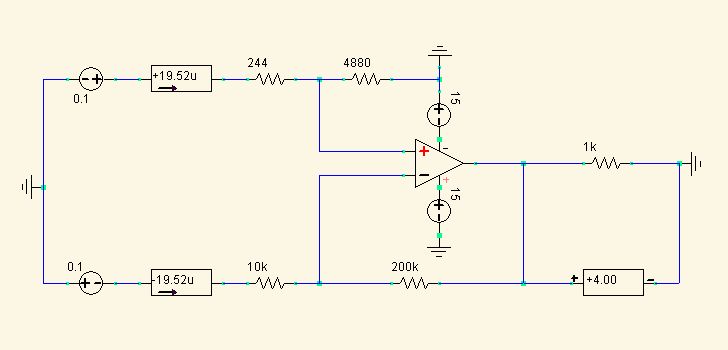

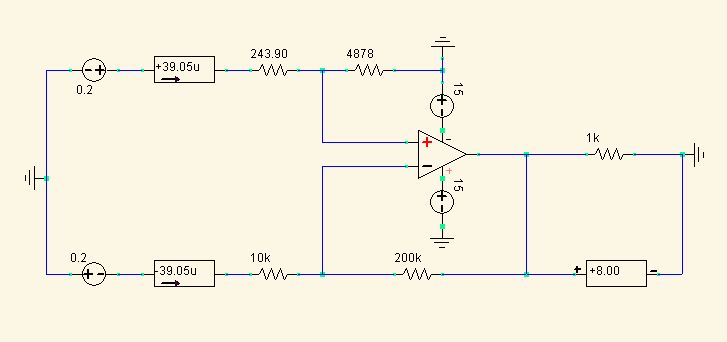

Re: balanced input
Yeah your right - I played about it spice and came up with this. It seems weird but the current meters on the input seem to be indicating equal i/p impedance.
i/p impedance = about 5.123K ohms each leg
Can you see any problems with this ? I can't but perhaps Iv'e lost the plot somewhere.
mike
AndrewT said:The inverting input impedance is 10k.
mike

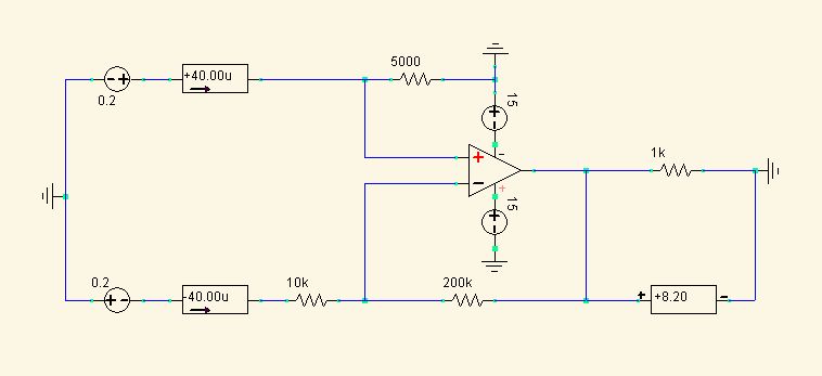

simpler method
This however is a simpler and more practical circuit.
Sorry to clutter your thread up with this stuff Peter but I just figured this stuff out and although it may be old hat to some of you guys for me it's breaking news.
Of course this would only work from a low impedance source so perhaps it is not as simple as I originally thought but hopefully it may be of some interest
mike
mike
None of those are balanced circuits.
All have a higher impedance at the inverting input (about 2times) than at the non-inverting input.
edit:
it's more usual when using both inputs for the inverting input to be the lower impedance, your's are swapped and relatively easy to make near equal impedance. But, never accurate enough to give effective balanced operation.
edit:
Hi Andrew,
I'm grateful that you raised this because there were several issues that I was not aware of so I spent quite a while last evening playing in spice and doing some calculations and now these issues are quite clear to me.
For the last two spice diagrams I have posted I can assure you that the i/p impedance for a differential signal is equal for both legs - this is evident by the fact that you can see I applied equal & opposite voltages & measured equal & opposite currents.
I checked the maths on this and it checked ok
However these circuits do not have equal impedance for a common mode signal i.e. noise and more importantly common mode noise does not cancel so even though it was interesting to check out these ideas I do not believe they would practically sound very good either in applications were pick up was trying to be avoided or where pre-existent common mode noise needed to be canceled.
The first circuit I posted ( hand drawn ) gives more or less perfect common mode impedance & cancellation so even though the differential currents where unbalanced I suspect that this cct would still sound very good where it is important to cancel common mode noise e.g. from a balanced DAC o/p especially if leads where short and pick up was not an issue.
In this circuit one can add in a resistor from the non inverting i/p leg of about about 5K to ground - this gives good differential balanced impedances and amplification and common mode cancellation but not common mode balanced impedances This option might be worth checking out for sound quality.
So that's that ! I suspect that different versions would sound best with different applications but in the true sense, none of them are perfectly balanced in all regards. For that one would indeed need a either two separate amplifiers with identical inputs as Peter suggested or a transformer.
I appologise again to for inserting all this OT stuff in the middle of Peter's thread but hopefully it wasn't only me who learnt something
