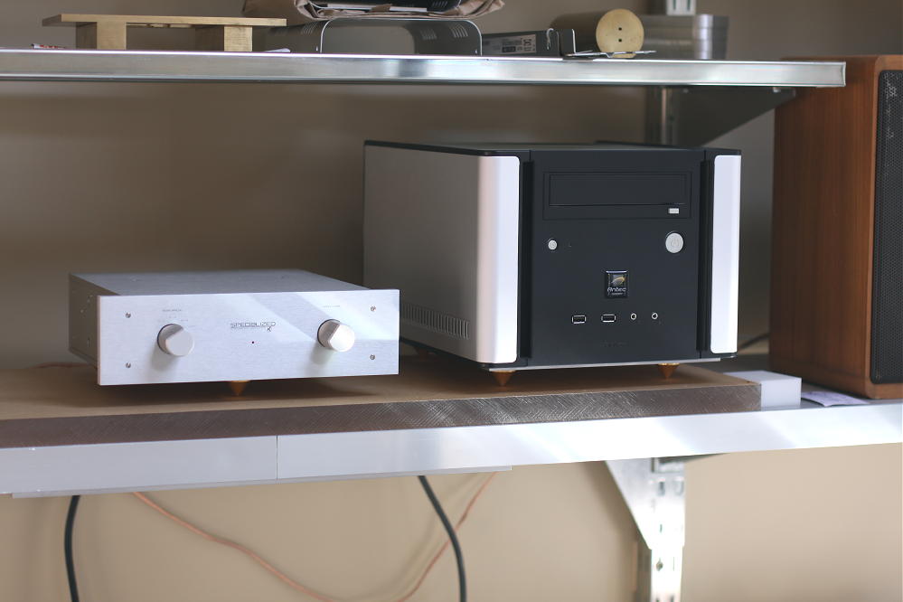

I just finished few days ago a small PC for my workshop. It came out really nice and I can't complain.
I decided to use Antec NSK1380 case, which features three-layer sandwiched side panels (aluminum, plastic, aluminum), is relatively small and looks good enough (sort of like Levinson 😉: http://www.antec.com/Believe_it/product.php?id=MzA=
Since the MoBo is installed on a bottom, I decided to reinforce bottom panel by adding 3/16" aluminum plate attached with double sided tape and 4 cones:
Although the case comes with pretty nice PS I decided to remove it and in its place install linear supply based on 100VA Hammond transformer, 2 x MSR860 diodes, 6,800uF cap and LT1083 high current regulator. The custom aluminum bracket added on top supports the new PS components:
Here's the closup of transformer assembly, the rectifiers are installed directly to a bracket as they run very hot:
The 12V regulator has it's own heatsink attached to bottom panel. It does not run that hot but just in case I added small fan with reduced speed and now it's only slightly warm. A PICO PSU is installed directly on motherboard, the only modification was removal of two roiginal caps and putting BG N 470/16 in their place:
Here's a view from a top, some damping material was added to a bottom and I use Freezer LP to cool down the CPU. In Smart mode the fan is quiet and can't be heard after case is closed. I didn't even consider any means of passive cooling:
Originally I wanted to use full size HD (WD 640GB Caviar) but it put too much strain on PS and in the end I went with 2.5" WD Scorpio which is much smaller; I made custom brackets to install it in a drives compartment:
All in all, I'm very content with that unit and I use it in my workshop for music, internet and video. I have another, more serious project coming up soon.
