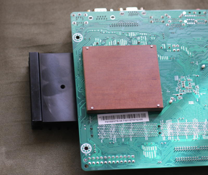

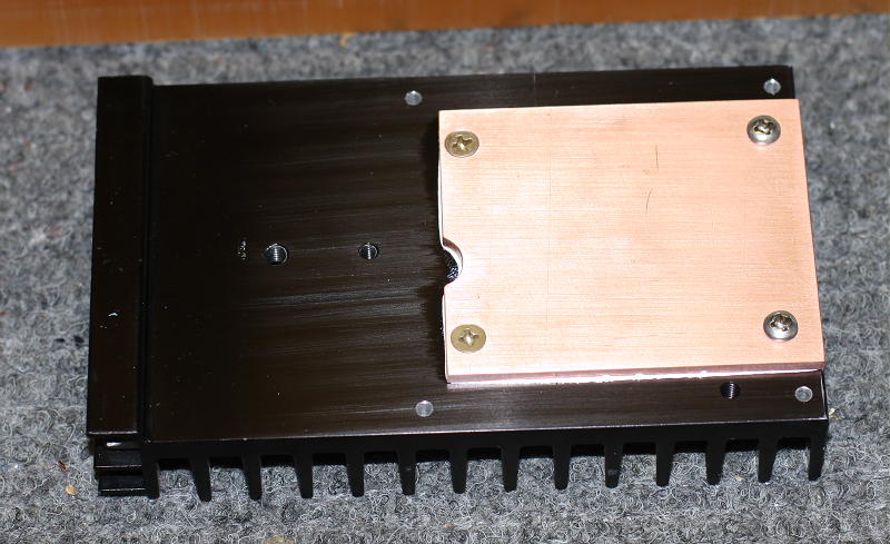

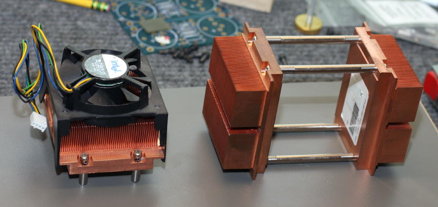

Peter, how did you go from the Freezer LP cpu cooler to the large heat sink on your PC as source project. i.e. how did you connect the sink to the top of the cpu?

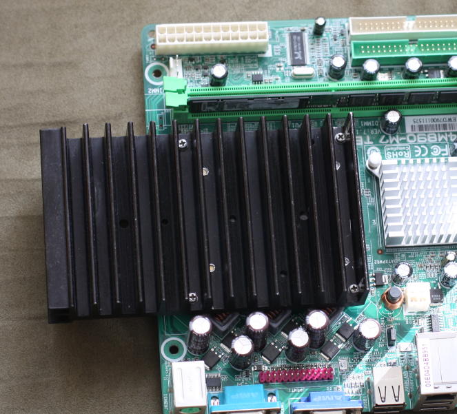

Thank you, I looked at a couple of my newer boards and there are cap's that would block your solution. So why not just a fanless cpu cooler?
CPU cooler wasn't sufficient on E2140 but it seems to be just fine on E7200. OTOH, those thin heatsink blades may resonate a bit that's why I chosen the conventional sink. The 1/8" copper spreader was also helping to achieve reqired clearance from surrounding parts.
If that is the GIGABYTE board ...
how do you connect the 12 volts four pin connector (whose proper name has eluded me)?
It looks completely blocked.

That was Biostar Mobo and 4 pin connector is just right to the bottom corner of the heatsink. I just checked Gigabyte board and it would work fine too, as the heatsink is not that big.
Another option would be soldering power cables directly on a bottom from one connecotr to the other and I might do it anyway to reduce cable mess.
