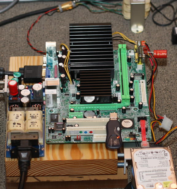

You can still get all the out of production stuff off an ebay, that's were I do all my shopping. Just the other day I received brand new GA-G31M-S2L (sourced in UK) and I'll be setting another system.
My present one is quite satisfying though, and runs fanless.
Hi Peter,
and why are you using exactely that kind of motherboard?
What CPU and what ram are you using?
Greetings Ulf
Greetings Ulf
I'll be using in system described in this post: http://www.diyaudio.com/forums/showthread.php?postid=1689863#post1689863
The CPU is E7200 and 1G of KINGSTON HYPER X RAM; couldn't source 512M but will also try regular Kingston RAM which in my current setup doesn't sound bad either, and RAM seems to make a difference indeed 😉

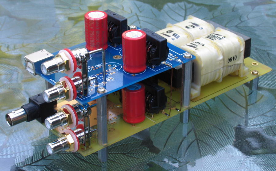

I am one of your many satisfied customers (using your Chip amp, phono stage and DAC). Is there, however, a possibility to add a USB input to the NOS DAC in addition to the ordinary input? Since the possibility of listening to music on the Internet is increasing, I want to connect my lap top to the DAC. Could it be possible to add a switch in order to move back and forth between the ordinary input from CDplayer/DAC-combo and an USB input?

Well, the easiest way would be adding HagUsb and selecting SPDIF inputs to your NOS DAC: http://hagtech.com/hagusb.html
There are certain compromises here though, and if you want to do it really well, another option would be adding USB DAC front end board on top of your SPDIF DAC section and power both boards from a same PS. You can use two separate RCA pairs or just one and select either output with a toggle switch.

Thank you Peter,
And your USB dac front end will set me back $ 250?
Regards
Jan Ove
$250 is for complete USB DAC kit. The ad on will not include 8 diodes and two caps and for people who are already using my SPDIF DAC I can do it for $200 (RCAs are extra).
