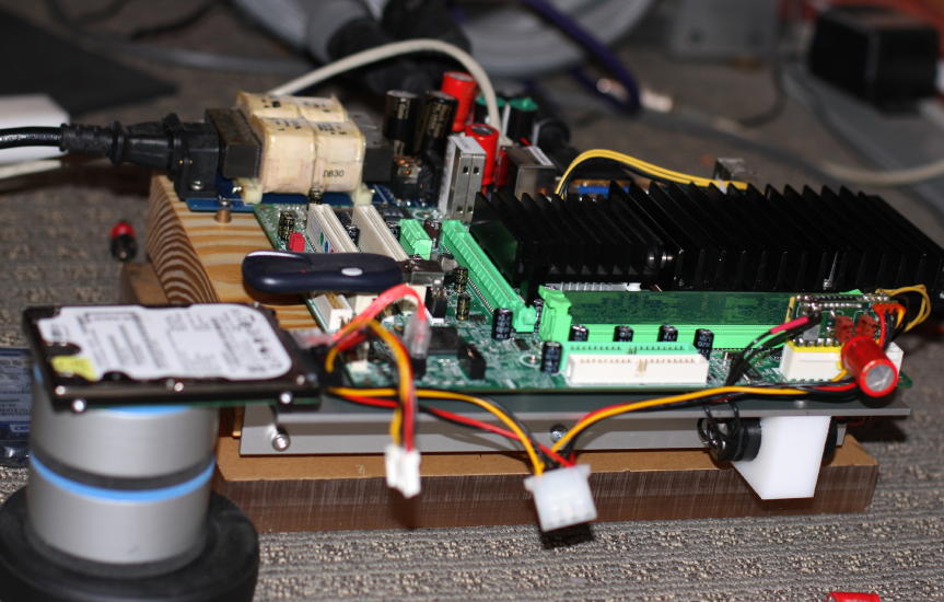

My computer setup looks like in attached picture. I installed motherboard on a spruce board with an aluminum angle attached and working as heat sink for LM7812 regulator. I’m still using PICOPSU and the cap installed there now is BG N 470/16. There is another cap attached to the angle and it provides filtering before regulator (Panasonic Audio Grade 6800/63)
It’s still not clear to me if computer is an improvement over Shigaclone: in some ways it’s seems better (mostly when it comes to technical side of a sound) but in some ways it’s still behind. I find the system to be a bit on a bright side and lacking smoothness I so much enjoy with a CD player. But all the changes I did recently improved computer playback substantially and I don’t have problem listening to it all day long.😉

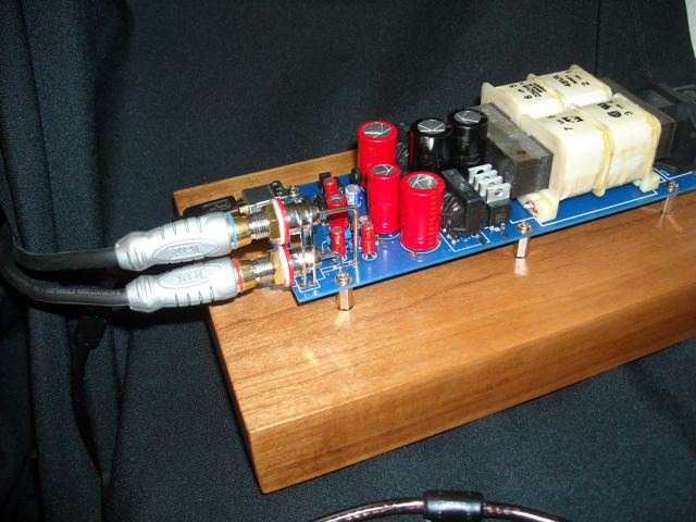

Pics of my DAC
Trying to upload a photo of my DAC...let's see. Okay, that worked. I wanted to say thanks to Peter for the fabulous kit. My version here worked first try (Peter soldered the surface mount components). I put the system (described in the next paragraph) together in one go so I don't have proper before-after comparisons. All i can say is that it sounds great.
The DAC is mounted on a solid piece of what started out as 8/4 cherry. My source is iTunes with lossless files feeding the DAC. The DAC supplies Pete Millett's hybrid headphone/pre amp which in turn drives a Decware Zen experimenters Tube Amp (built from kit... I can supply photos of the whole set up if anyone is curious.) Those 1.8 watts drive some vintage Klipsch Heresys.
I'll stop there. As I said, it all sounds fabulous. Life is good.
