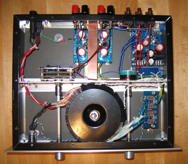

Another successful AudioSector project. I've had my LM3875 amp for a few years now. After I built my F3, it was just sitting there and begging for a new home. I purchased one of Peter's USBDACs and decided to combine the two (copying the master as he had done previously). I put in a pot while I was at it to make it a true integrated for my office system.
Thanks Peter!
Thanks Peter!

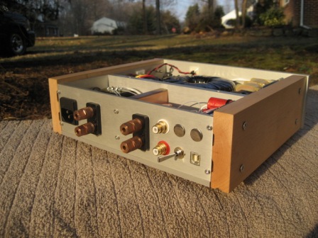

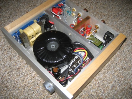

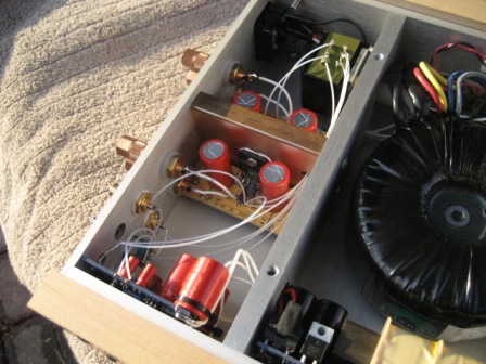

As long as we're showing off our handiwork, here's my latest gainclone, built using most of Peter's parts and grounding recommendations, along with an integral USB DAC. Details and lots of higher rez photos here:
http://mpbarneyamps.googlepages.com/gaincard-usbdac
This setup sound great, and along with a PC based music server, I'm listening quite a bit more now.
Thanks very much to Peter who's been very generous sharing his knowledge and techniques!
Mike
Mike
