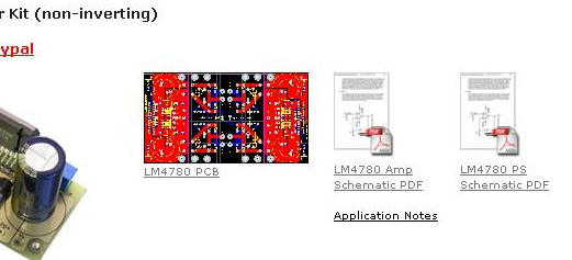

It's pretty old amp and I was using it few years ago. It is still in use in my secondary workshop system. The balanced signal was provided by ML380S preamp.
I've built the amp to check the potential of LM4780 kit.
The amp was described here: http://www.diyaudio.com/forums/showthread.php?postid=636575#post636575
BTW, from kit ordering page you can get directly to forum discussion (on the particular kit) by clicking Applications Notes link, as below.
