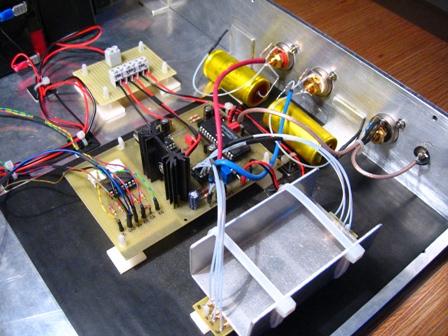

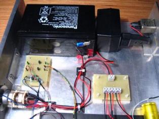

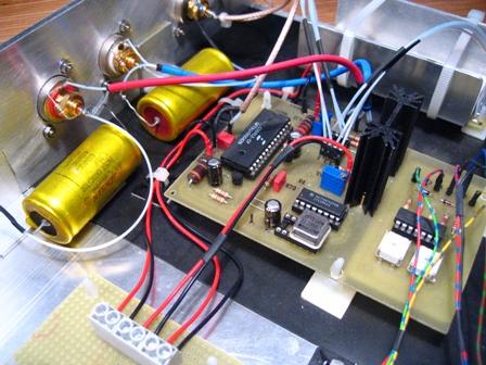

Hello All,
I'm reading this forum about the gainclone with intrest.
I also read that people are building DAC's here, well I also build one using the "same" components. My DAC uses 8 TDA 1543 [paralel] and the CS 8412. Also I use a clock to reclock the signal the clock is from TentLabs [www.tentlabs.nl]. The design of the DAC is from Doude Douma [http://www.dddac.de].
The DAC works on a battery so no dirt from the net 🙂
It's really a good DAC, great sonics en luts of detail.
I have enclosed a picture of the PCB
Kind regards,
Arjen de Boer
