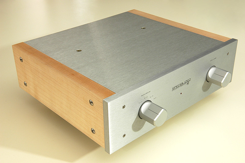

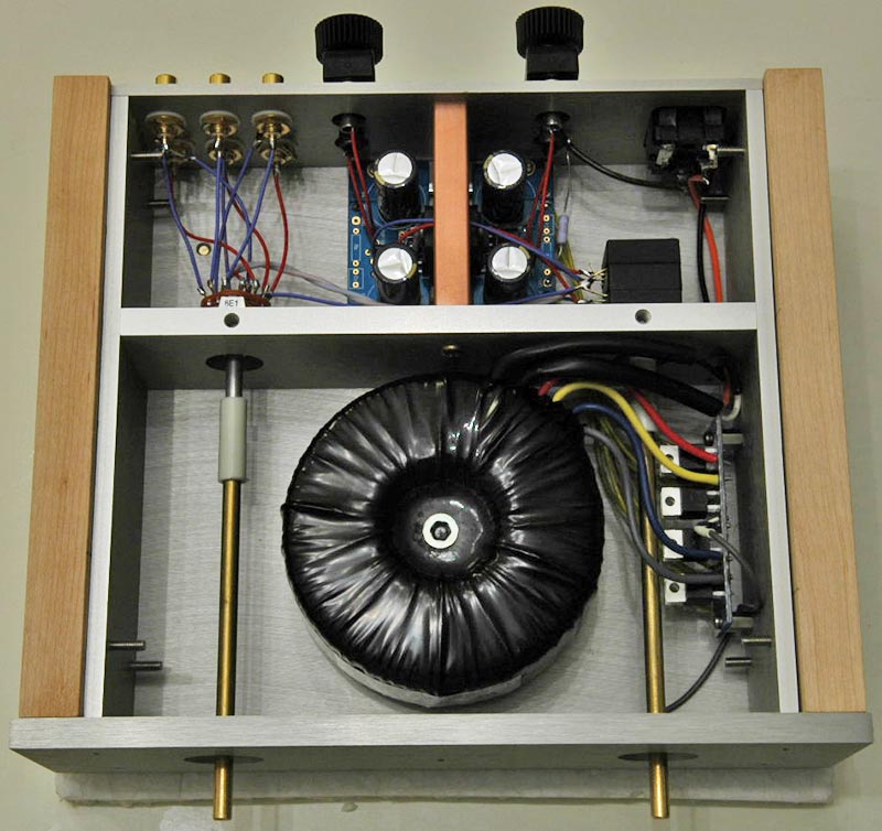

Yesterday finished the intergrated amp from Peter.
It was more easy than assembling an Ikea closet.
The chassis is fitted with Peters premium 3875 kit as I was not satisfied with previous gain clones, they did not come close to my Aleph 30.
This amp is already in a different league. The sound is so clear and delicate already! It's still a bit raw with the only 5 hours of playing it performed, I expect that will fade away a bit.
The soundstage is huge. Good recordings get even better.
I am very happy with this amp.
I was also a bit concerned of leaving this amp turned on all time because both my previous normal 3875 as well as the 6DJ8 buffered chip amps produce quite some hiss all the time. Peter's amp is however dead silent when required.
The wiring is all pure silver, except for the supply, which is some wire we use at my work to calibrate automotive sensors.
Thank's Peter for making this excellent piece of equipment available for the 'poor' man!

Hi Hanz!
Good work
How much did the whole unit cost you? I think the enclosure is very nice and only $250.

I'm slowly raising the price of the enclosure due to weaker USD, now it's $280, soon it will be $300.
