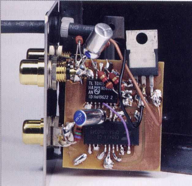

The DAC output section of my DAC is very similar to 47Labs DAC, which was measured by Stereophile: http://stereophile.com/digitalprocessors/800/index5.html

The 47Labs DAC is pretty close to this design: http://www.fedde.nu/audio/images/nonoz3.gif and if I'm not mistaken they use 3K resistors for I/V as in attached pic.

Never give up!
One final comment, if that pic of Peter's is a genuine 47 Labs Gaincard interior, then I for one am appalled at the constructional quality and layout.
Compared with anything you ever see of Peter's own work, that looks more as if it has been put together by a real amateur. Also, using parts 'flying in the air' like that is sometimes beneficial to keep certain signal-paths short etc., but this has hardly achieved anything worthwhile in this regard, if at all.
It just looks like a haphazard 'first-attempt' for an initial circuit-trial, like a prototype breadboard design.😱
