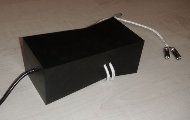

That is a thing of beauty!!
Can you post some close up pictures? It really does look like a work of art.
I use his USB DAC with silver interconnects, so I know the sound is wonderful.

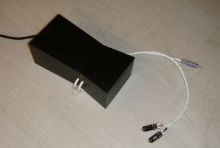

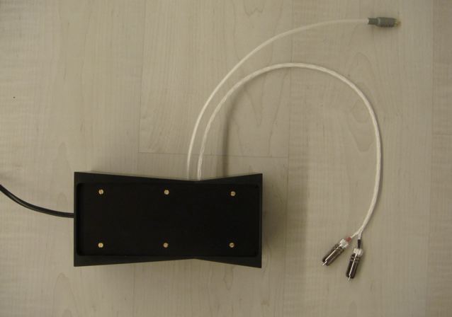

neil_kaye said:I have been working on this for a while:
Peter's NOS DAC housed in a CNC milled aluminum chassis (milled from a single billet) with pure silver digital and RCA out wires.
It sounds fantastic.

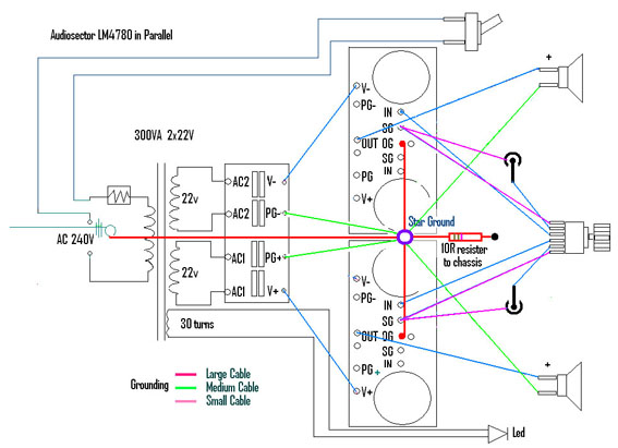

Im a little confused... Does anyone have schematic or pictures of the connection using dual supply transformer to the 2 rectifier board and to the 2 amplifier board.

Ming,
A single transformer with dual secondaries will create the V+ and the V- for a single rectifier board. The V+ out and V- out go to the V+ and V- in on the amplifier board.

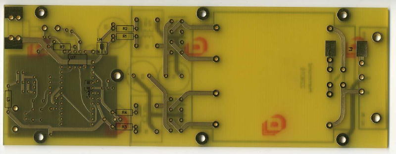

Hi Peter: I am presently fabricating an enclosure for my gold PCB DAC. While laying out and drilling holes, my hole pattern (in my gold DAC PCB) does not match your hole pattern info above.
The PCB is 187mm x 68mm, and the first set of holes are 18 mm from the front edge, but the 94mm and 170.5mm dims seem incorrect. My center holes are more like 97mm from the front edge, and the rear holes are approx 165 mm from the front edge. I have 6" calipers so the last # is a little +/-.
The 61mm width spacing appears correct.
Do the 97mm and 165 mm dims look at-all familiar?

If you already have the PCB why not use it as template to drill the holes? That's what I always do.
The previous board version, with through hole CS8412 chip has a different hole spacing, but that board was discontinued at least two years ago and I didn't expected that's what you have. The other two holes are indeed 94 and 165.5mm from the front edge.

I apparently have the older gold DAC pcb with the DAC chip on the bottom....I ended up using a transfer punch to get the hole pattern on my aluminum base, but the board is a little wobbly/inaccurate due to the components on the bottom. The hole pattern came out fine, though.
Since I have a plotter at work, I prefer to layout the hole patterns in SolidWorks and plot a paper template, fast and accurate.
I'll post pics when the enclosure is completed.

The AC ground (pre transformer) should be directly and mechanically fixed to the chassis. it should not go to the circuit ground.
also, if you simply use all the marked inputs on the boards you will have a low noise circuit. then you only need to have the chassis ground (CG) from each board come together at the star ground connected to the chassis by a 10R resistor.
