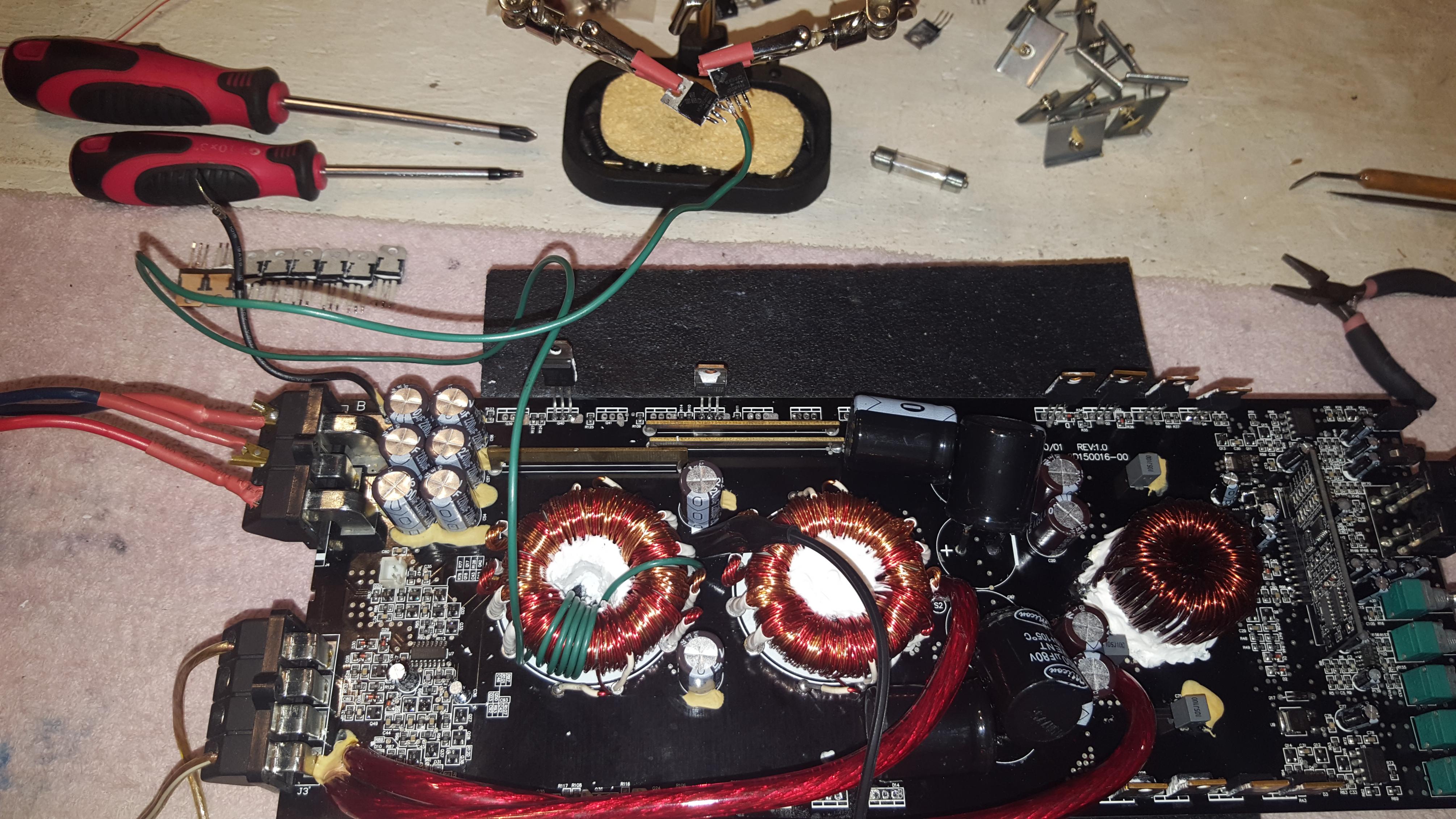

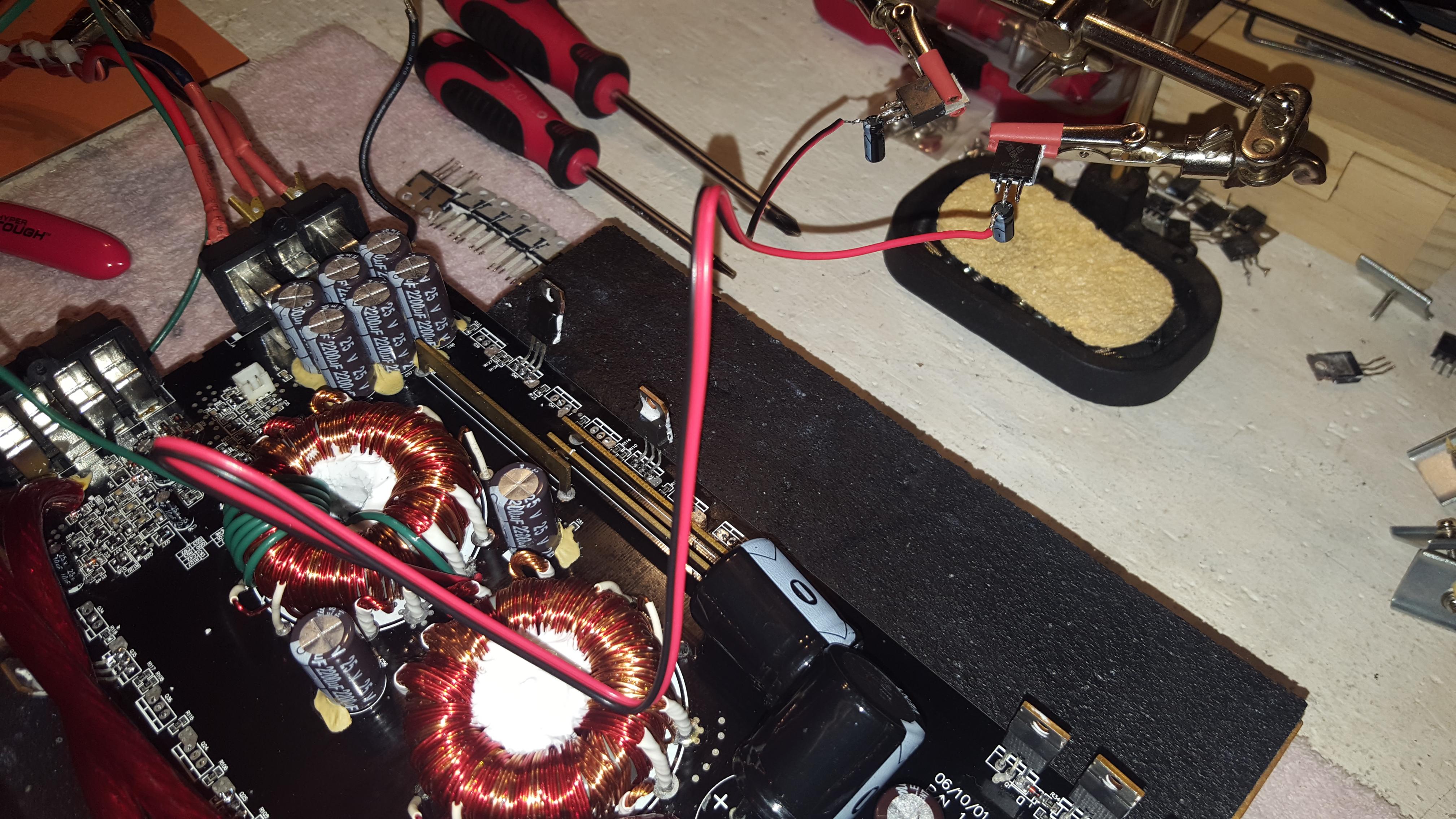

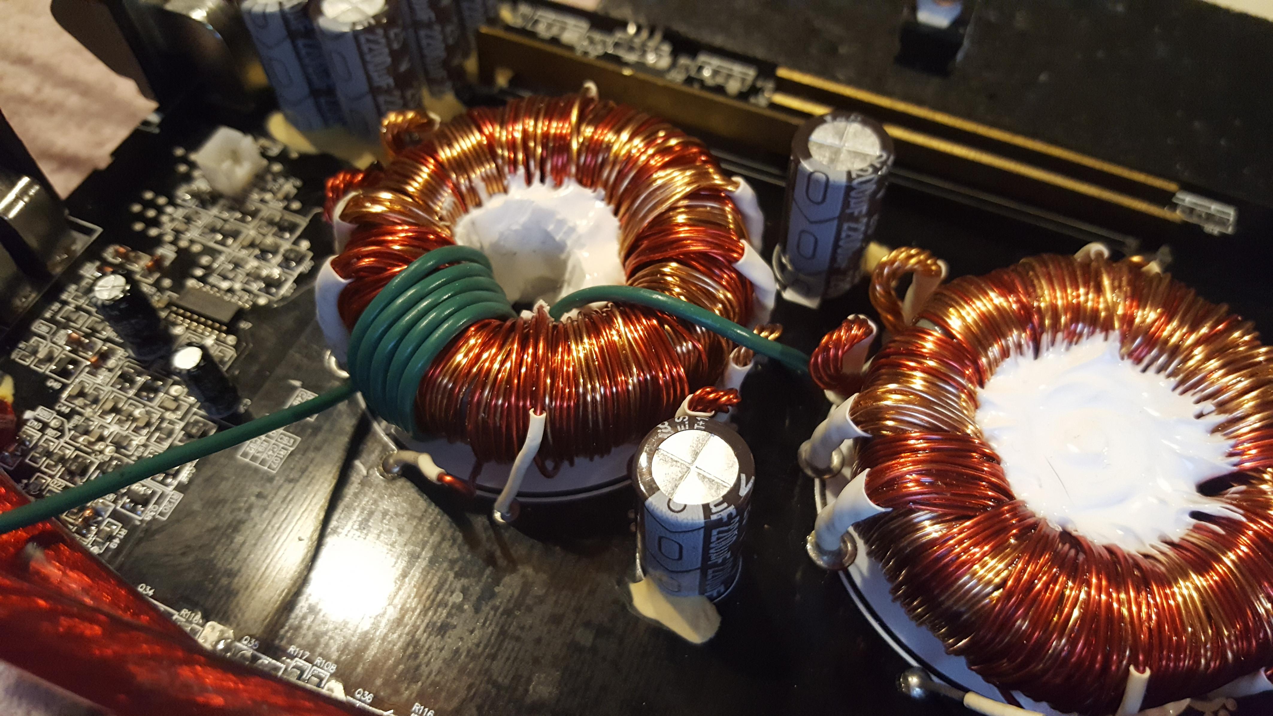

Sorry perry for all the questions but am I using the right wire because I have 5 turns around the transformer one end on secondary ground and I'm not getting any voltage near 15v?
Pic below
I have five turns around the Transformer one end to the secondary ground the other end is in between the two rectifiers.
the rectifier on the right is the positive rail and a rectifier on the left is the negative rail.
Perry you lost me brother I'm very confused at this point sorry I'm just having a hard time following what's happening.
I thought I had to get the voltage to 15+/- then run the lamp in series with one of the rectifiers and the output of the rectifiers would go to the rail caps.
Generally, I suggest the limiters in both rails, connecting this to the main board (caps in the main board) and them powering up. No one has ever tried doing it piecemeal. Having the limiter in only one rectifier should still be safe.
If you want to get the ±15v off of the board, you'll need to connect some capacitors between the rectifier output and the secondary ground. Without any capacitance, it may be making the meter read wrong.
