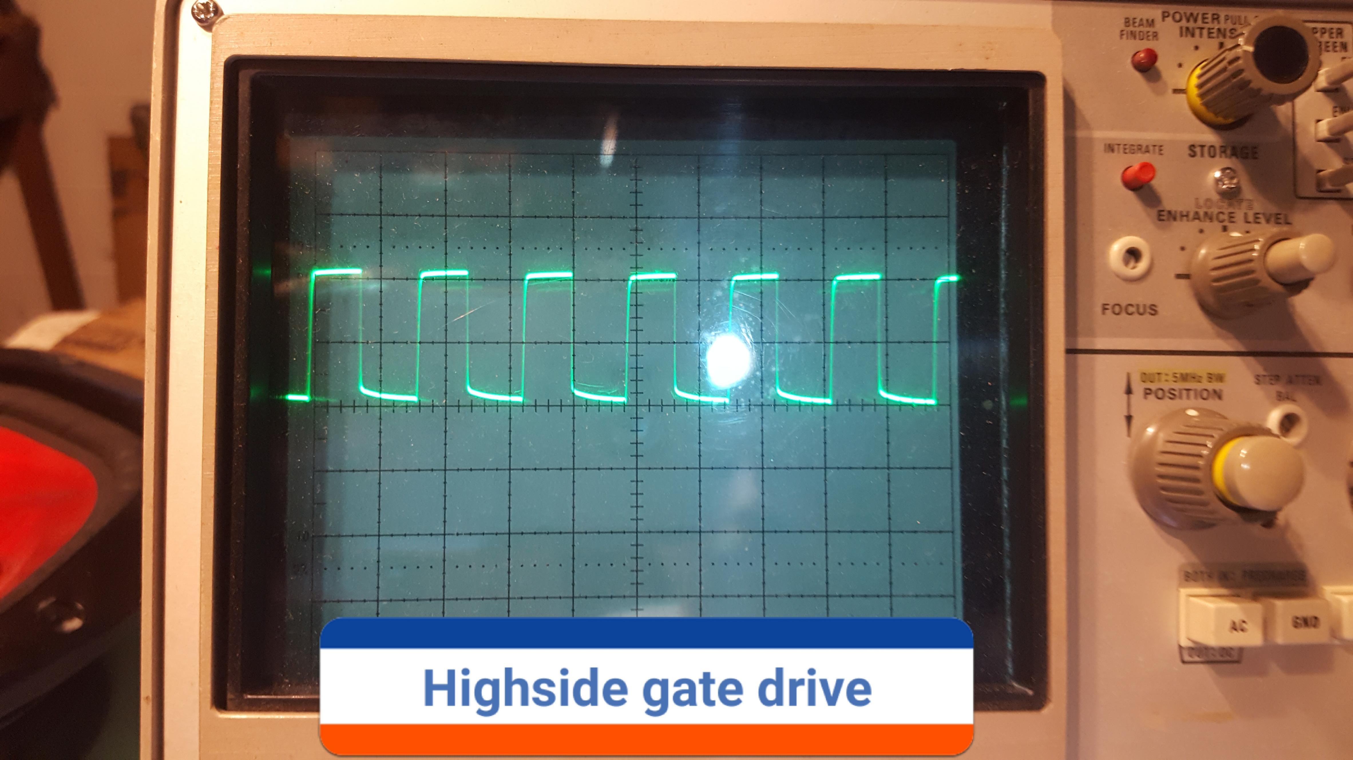

Perry when I scope the output for the low side if I put the probe ground to the source leg the amp goes in protect as soon as I touch the ground to the source leg.
That's why the low side was grounded the amps Ground Terminal that's the only way I could read the low-side waveforms.

What's the DC Voltage (black probe on the main ground) on the low-side source leg of the outputs.
Okay black probe on Main ground Red probe on the low side Source pads I get a measurement of 10v then it drops to 9.79v then back to 10v.
It repeats that bouncing voltage.

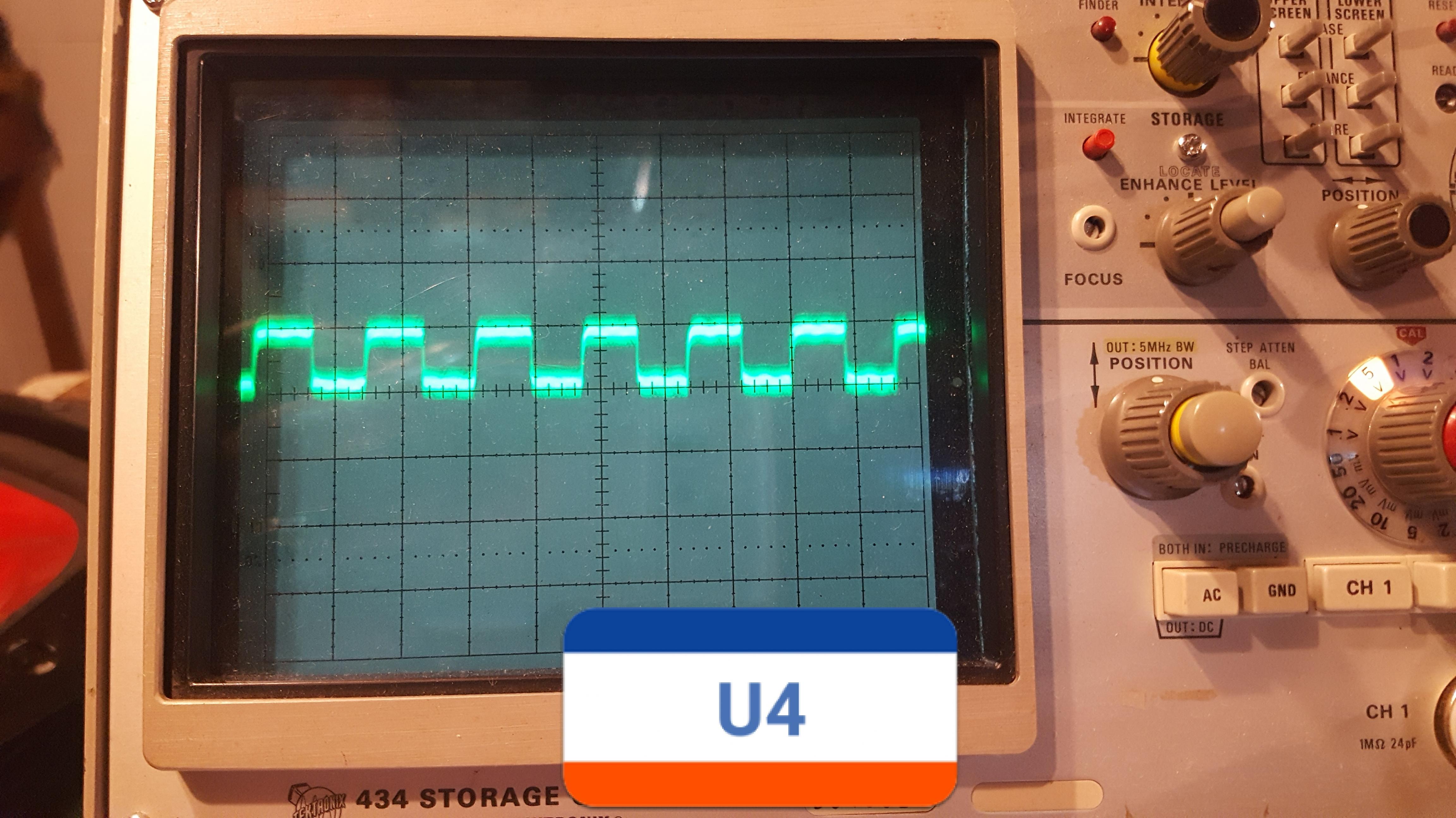

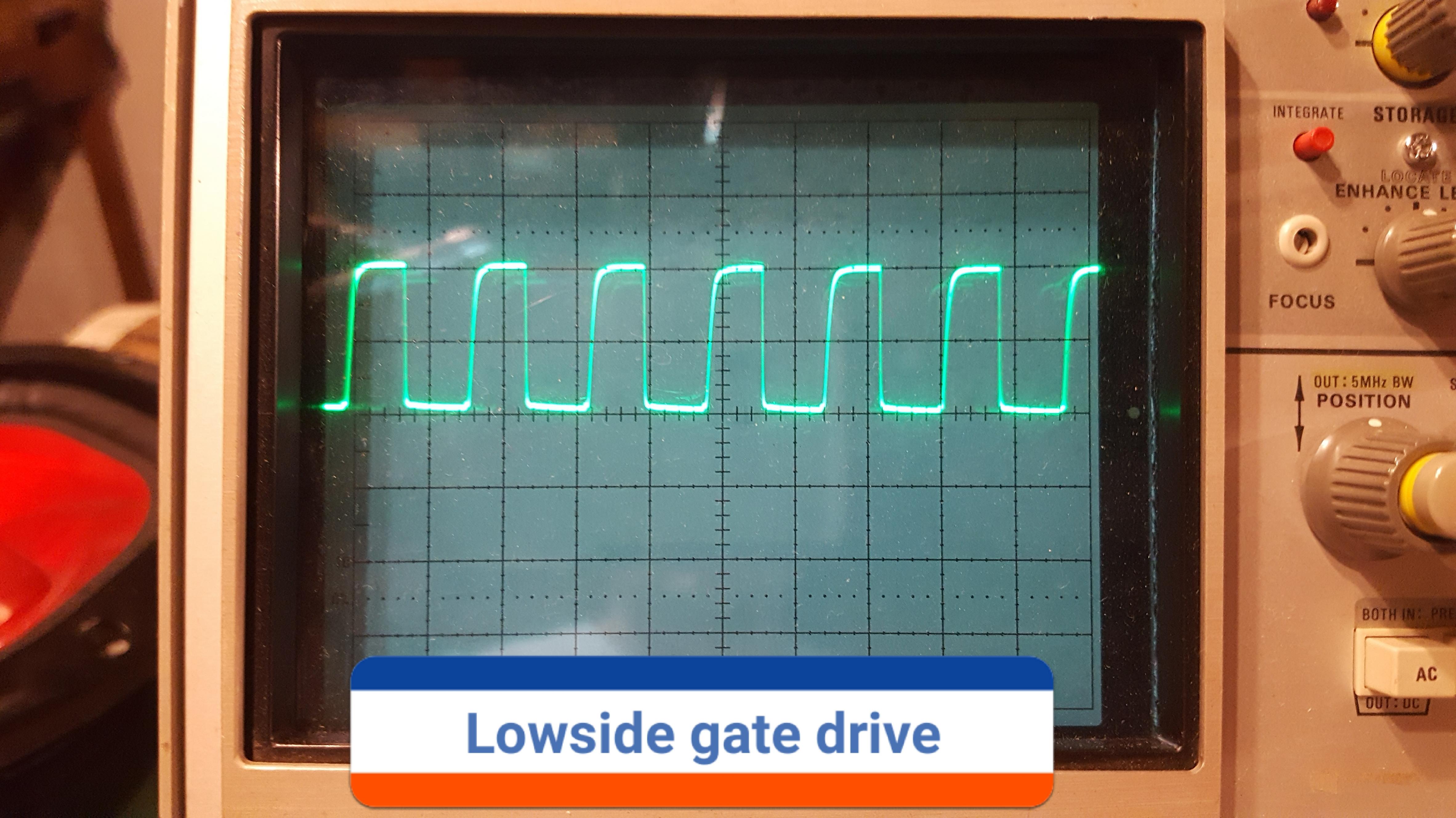

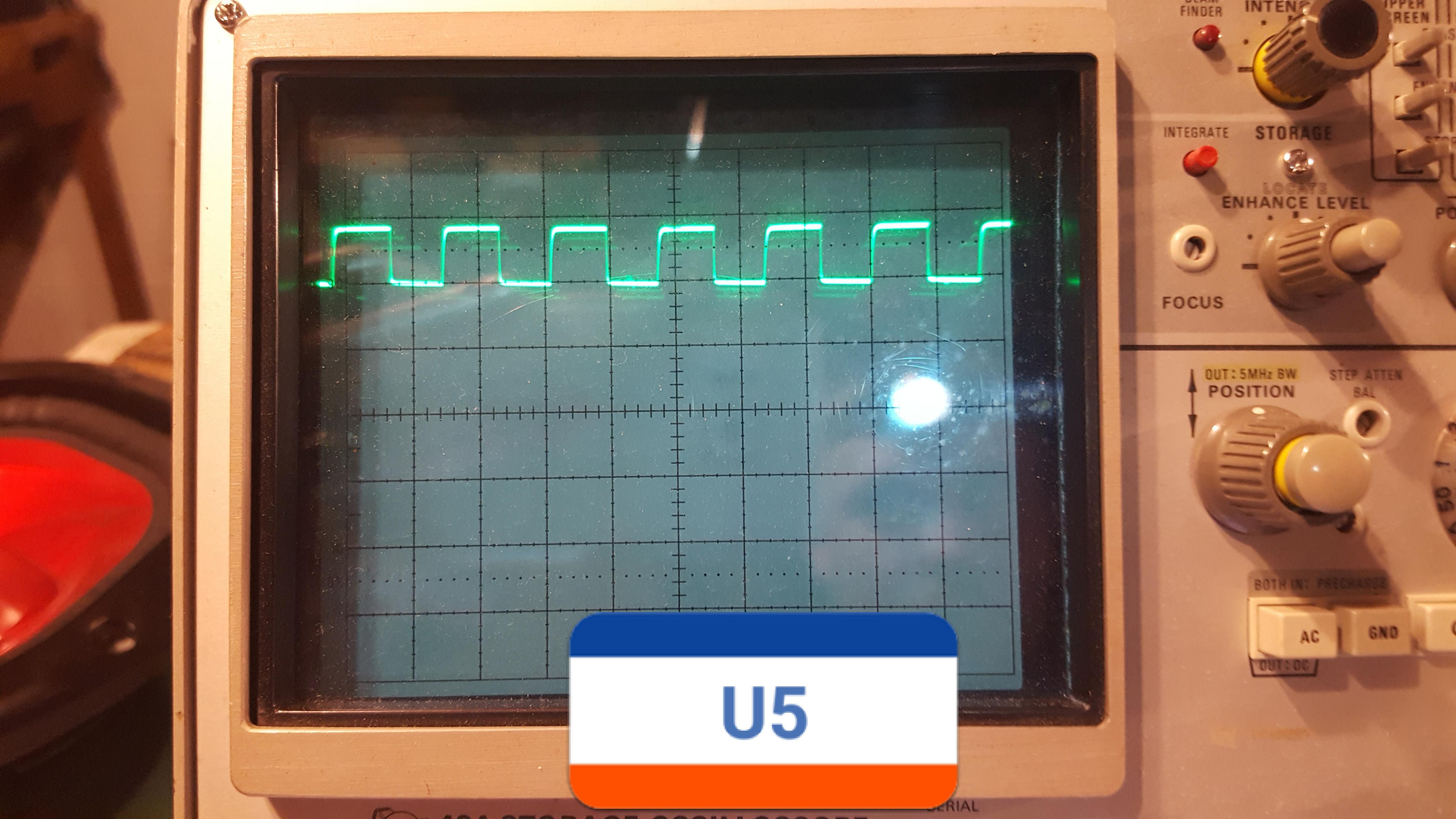

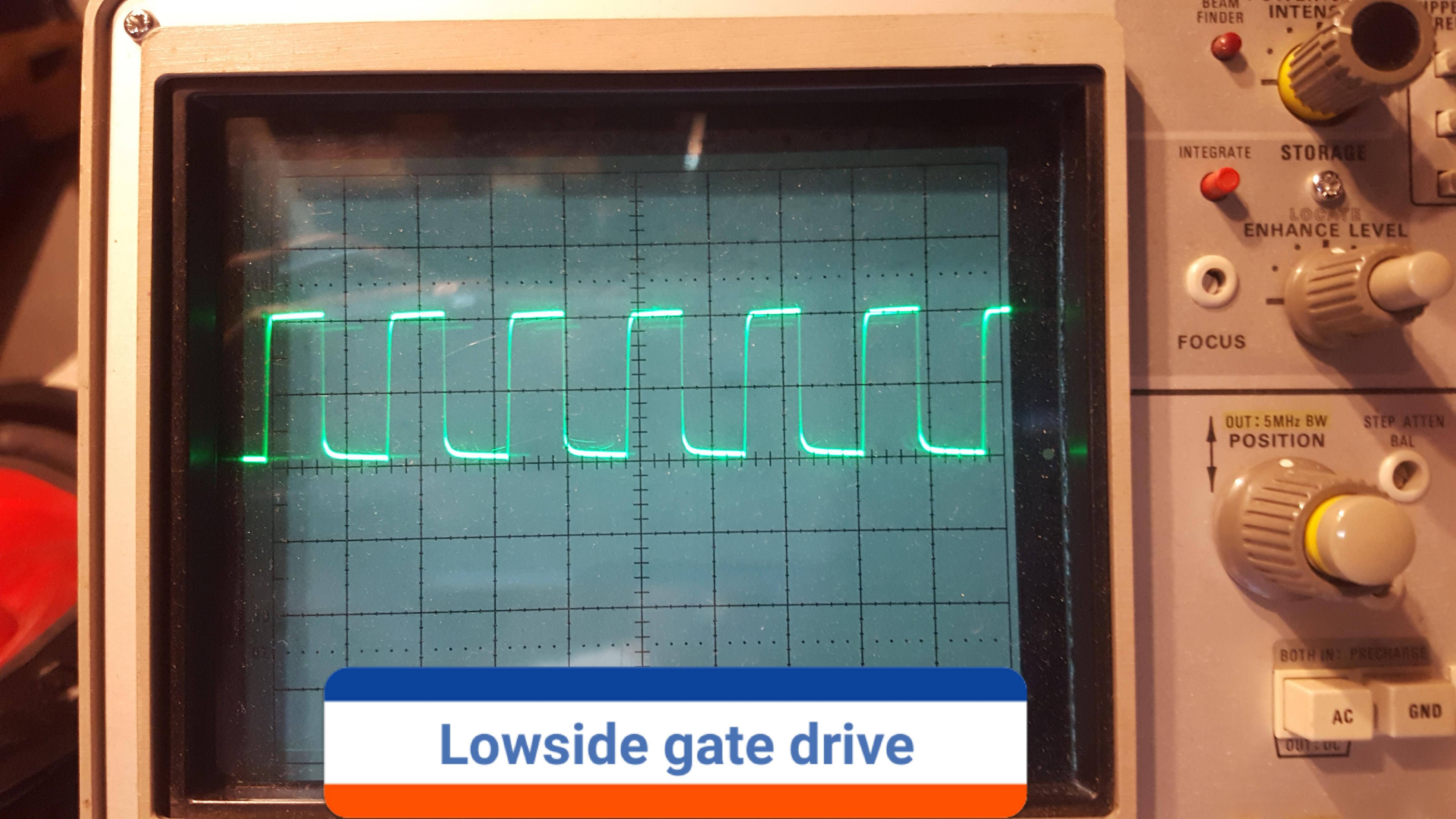

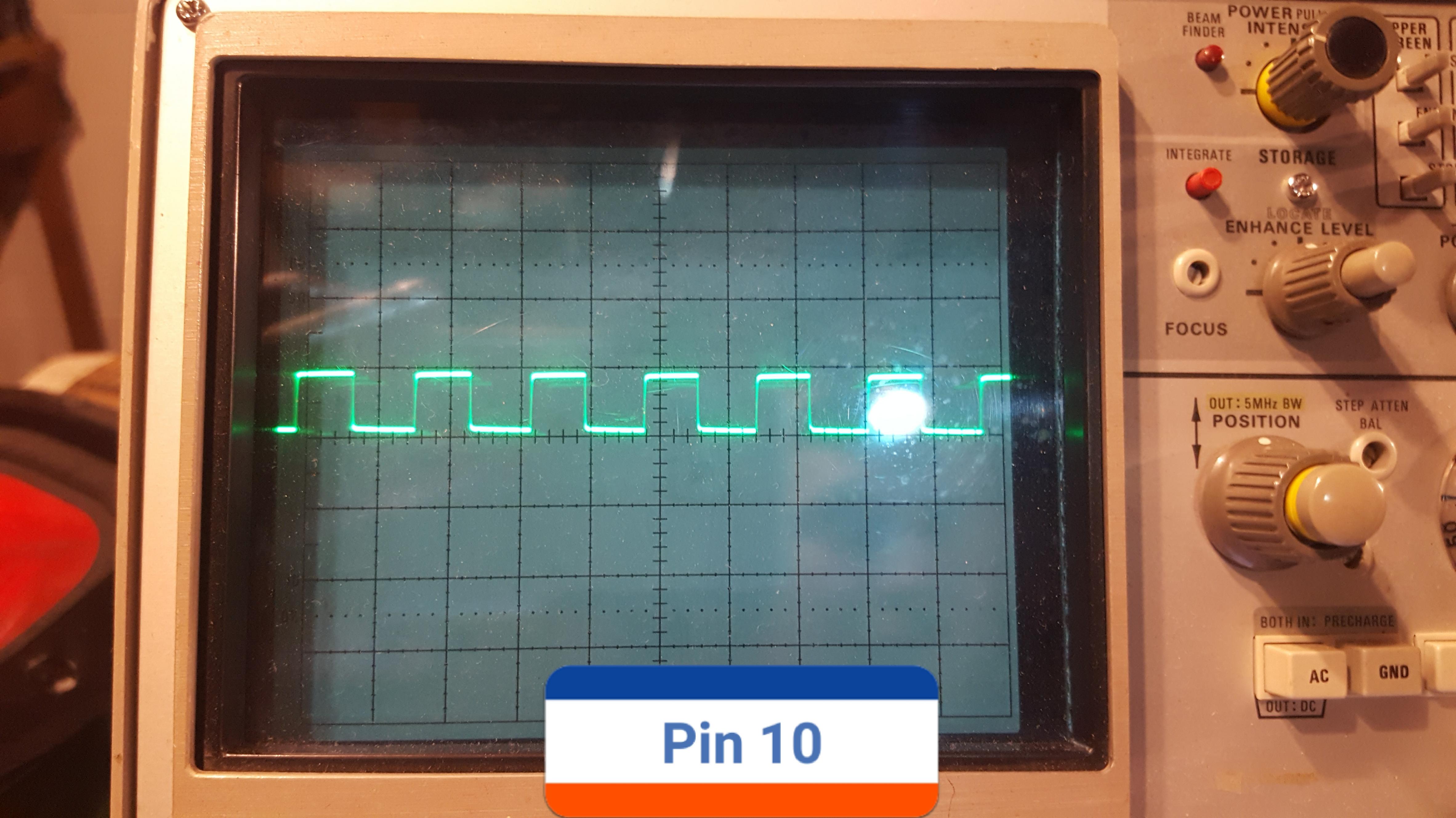

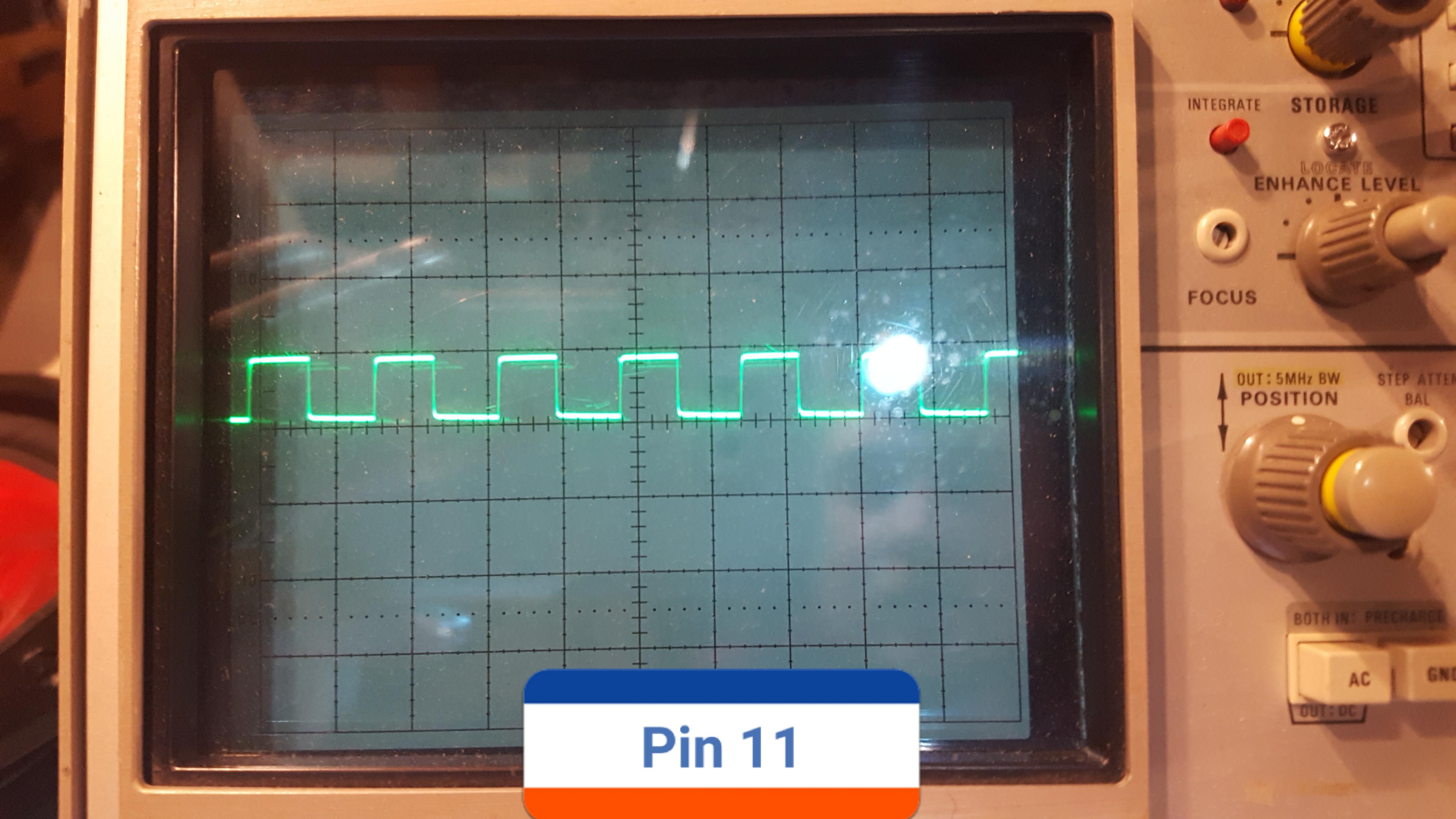

Ok both waveforms are in .5v 5us probe x10 pics below.
Ground reference source pad for high and low side.
