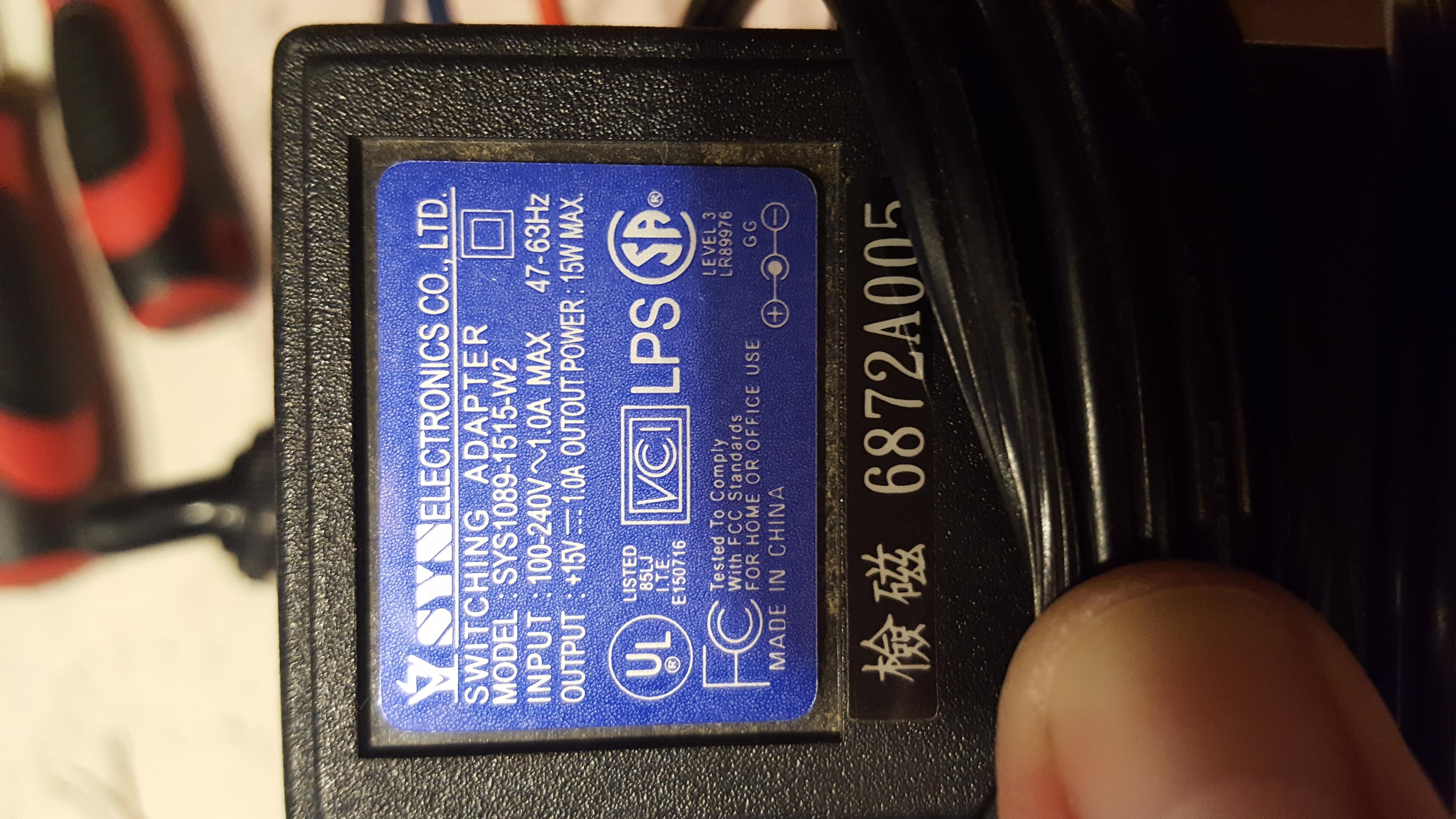

The supply that I was referring to would have a ground, a positive 15v output and a negative 15v output. The actual output would likely be adjustable.

I don't have supply like that sorry.

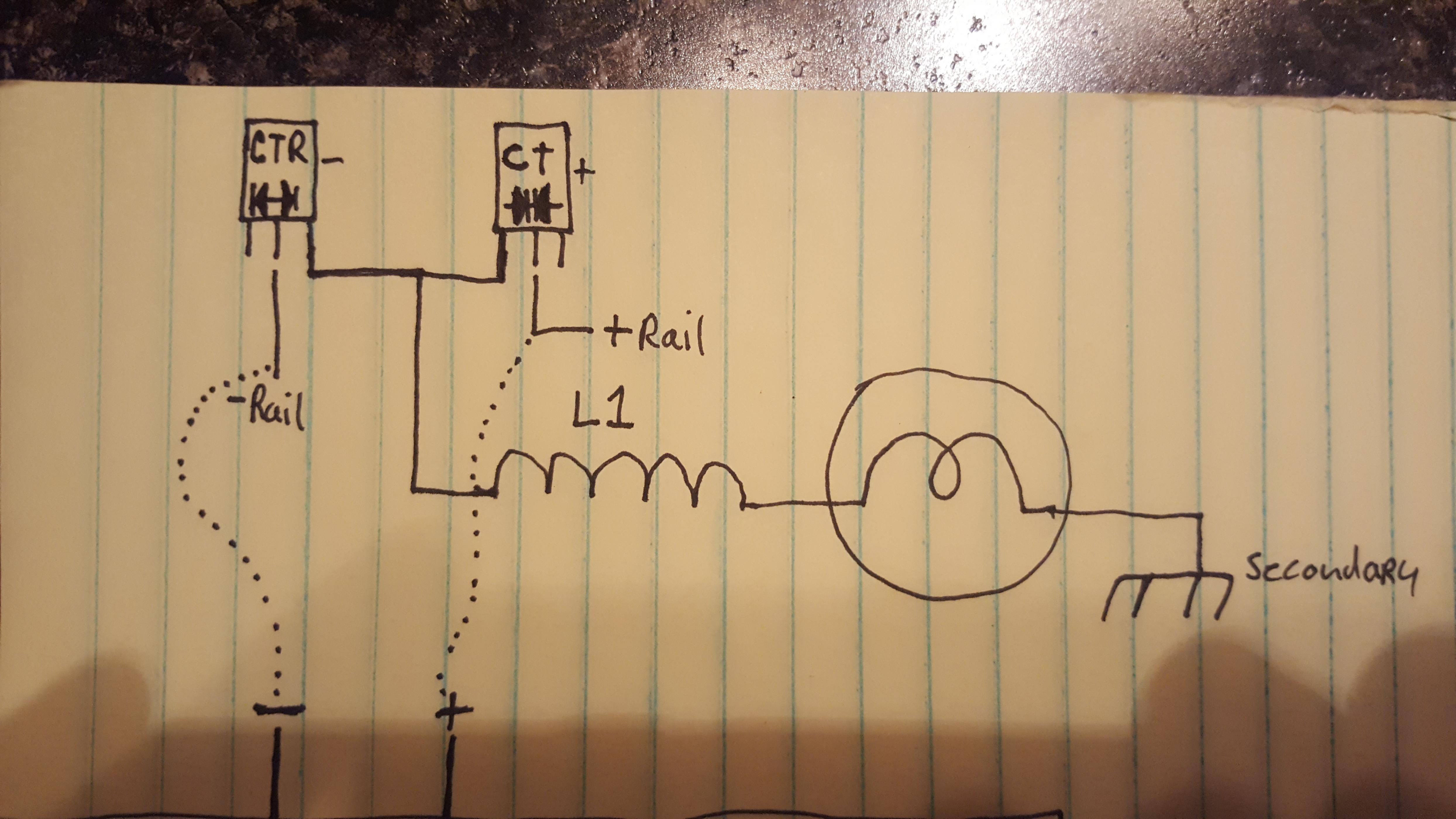

All you need to make the low-voltage supply is a few windings on one of the transformers.
You can use external rectifiers like shown in the thread I posted or you can use the rectifiers that you pulled from the amp. I generally don't recommend using the rectifiers from the amp because some can be hard to find. I'm not sure what they're using in your amp.
The 1157 lamps are just for added protection.
You'll have to decide which way you want to do this.

The other end of the winding will go to either outer leg of each of the rectifiers.
The output leg of the rectifiers will go to the terminals of the rail caps that are not connected to the secondary ground.
It's better to solder to the caps than to risk damaging the pads for the original rectifiers.

I didn't see the photo of the circuit. The lamp is better in series with one of the rectifiers instead of ground because if there is a problem, it's likely to cause the current to flow between the outputs and not to ground.
