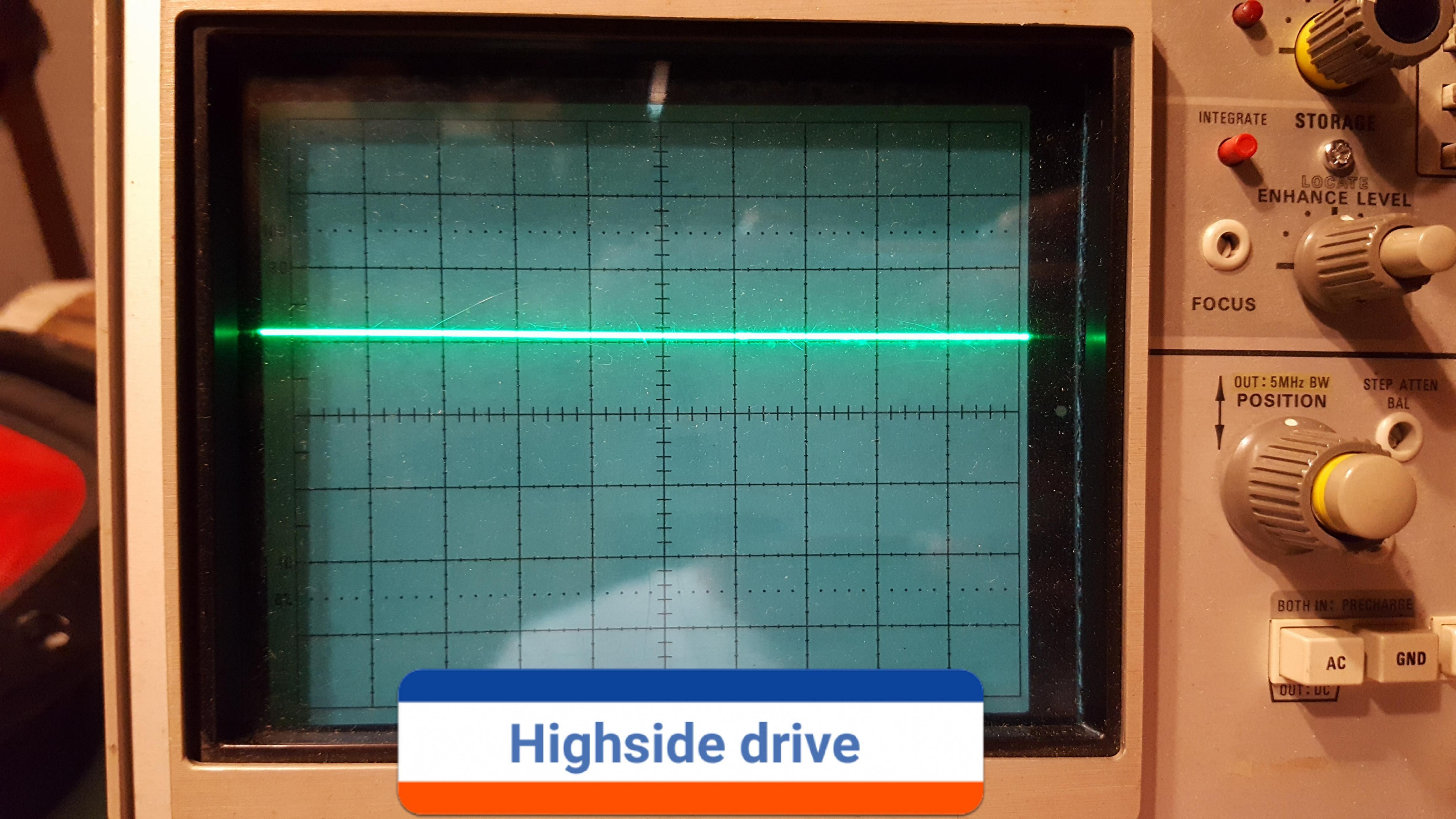

Yes I know it's not in protect at the moment I took the rail caps out do you want me to take the measurements again with it in protect.
The previous Gate Drive signals I sent you pics of was with the amp powered on with no rectifiers, rail caps, outputs in it that's the only way I can get it to power up
On the highside Probe ground on Source leg and probe on the gate I get a little over 1 volt see picture below.

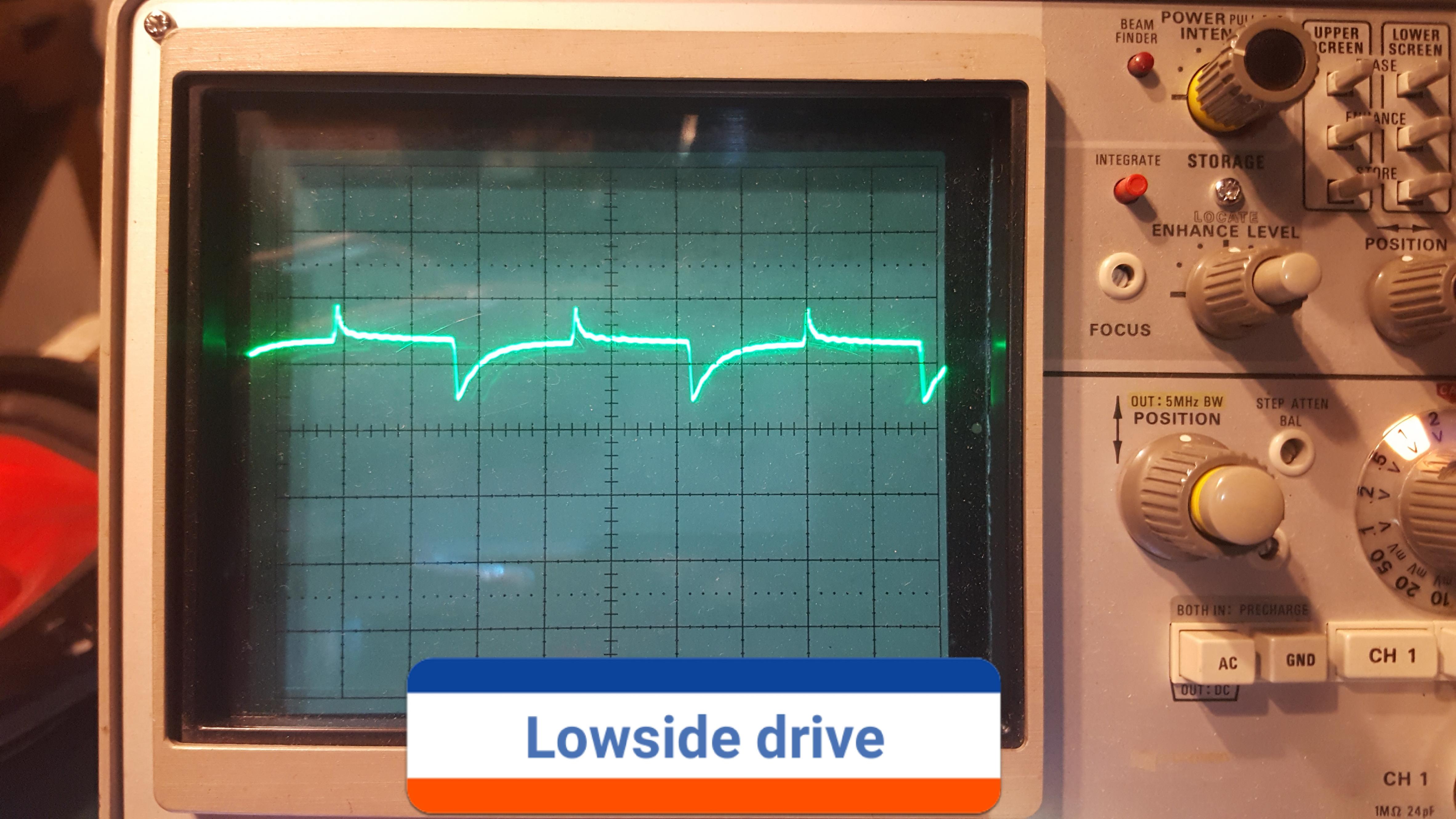

On the lowside Drive if I put the probe ground to -12 volt terminal I get what's shown in the low side pic below.
If I take the low side Drive with the probe ground on the source leg the amp goes in protect as soon as I touched the source leg with the probe ground.

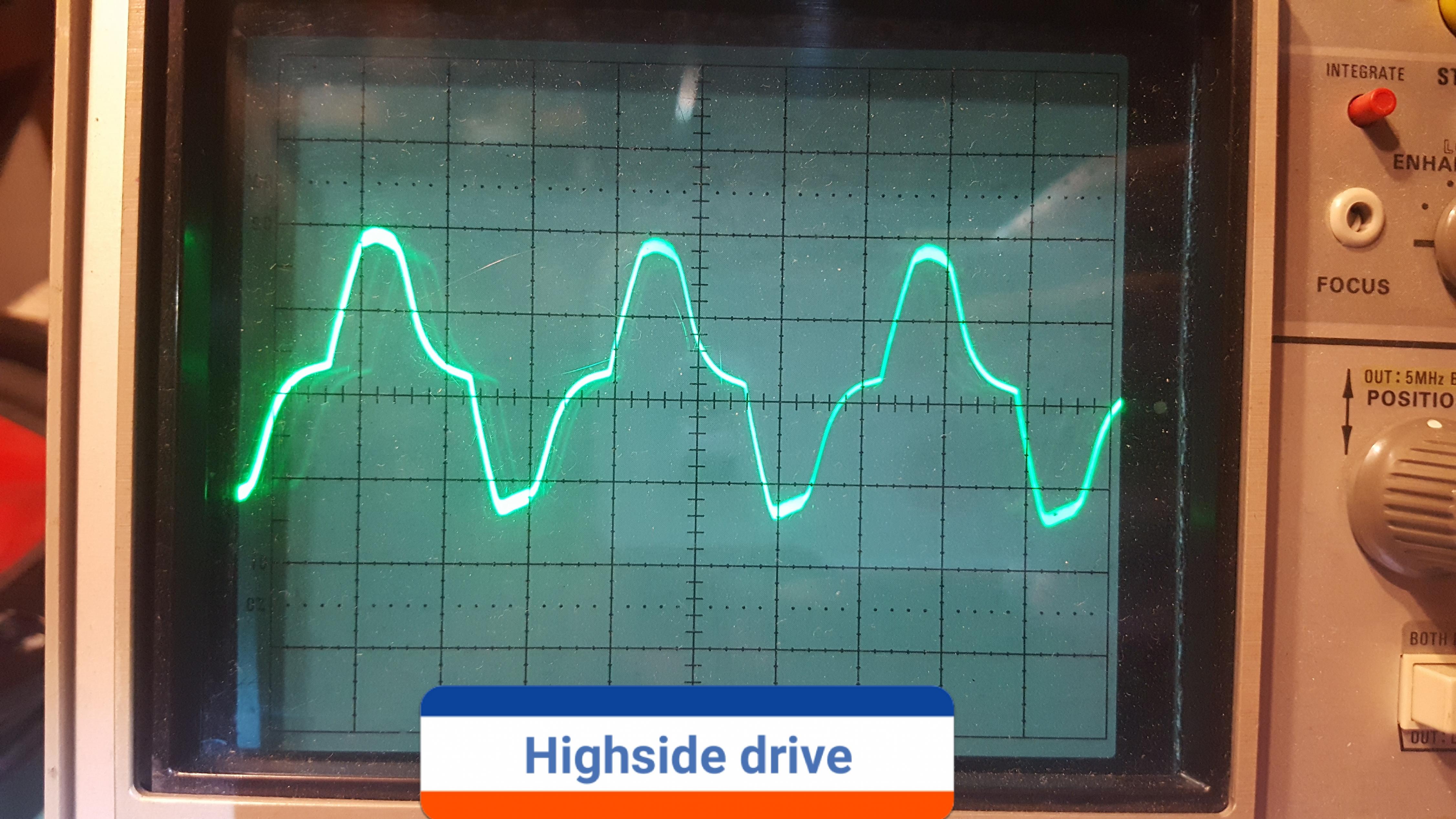

Okay I pulled q21 and the 3 volts on pin 3 of the driver board header is gone.
The low side Drive still looks about the same probe ground on -12 volt terminal and Probe on low side Gates.
1v 10us x10
The high side there is a waveform now probe ground on Source pad and probe on high side gate pad.
5v 5ms x10
Pics below of waveforms
1v 10us x10
5v 5ms x10
What does the signal look like on the output (pin 6) of the optocouplers? Ground the scope to the source leg for each side when scoping the output.
What does the signal look like on pins 10 and 11 of the driver board?
