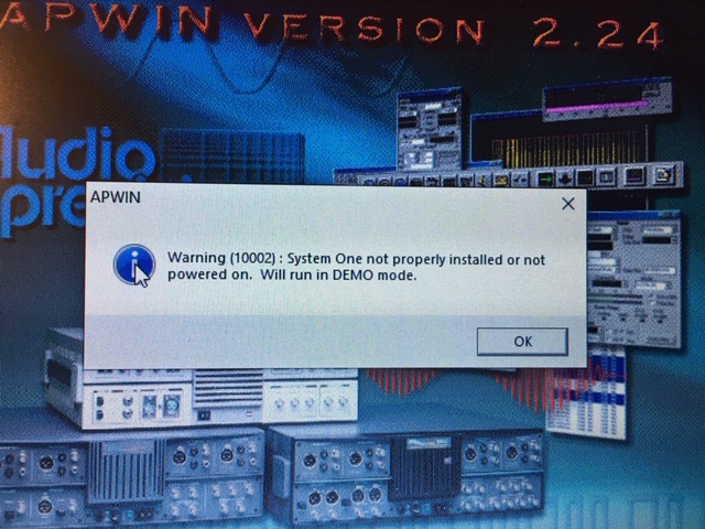

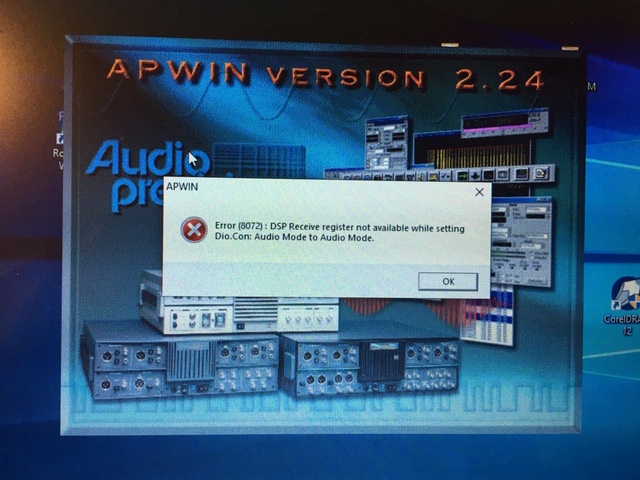

Hi
I am going to installa the SYS one by usb cable on laptop win10 64 bit
With win 7 it was running fine but now the new installation was wrong
In attach two screenshot of message i got
Any idea?
Many thx
Any idea?
Many thx
