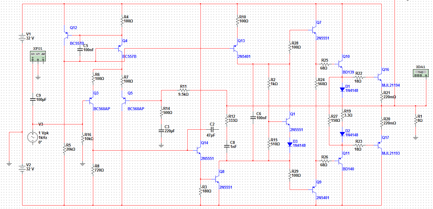

thats a faulty comparison - TMC is a "2-pole" compensation – TMC should be compared with other 2-pole schemes – TMC requires the same level of knowledge, skill to safely apply as other 2-pole compensations
2-pole could be done with “MIC” and then the "extra" loop gain that could be equivalent to some tuning of TMC would be available to the entire amplifier, input and output - just like the conventional Miller position TPC
I am afraid the "single pole" appearance of the global loop with TMC is deceptive - leads people to think TMC is "trivial" - to think incorrectly that TMC stability is some how better than other 2-pole schemes, that it is fine to recommend to less sophisticated builders without the inclination or skill to use other 2-pole schemes
we apparently need to keep repeating the warning that TMC is 2-pole
I do not agree that TMC is 2 pole.
TMC is 1 pole system. It is more like that one pole is nested in another pole. There are 2 poles, but they are not 2 pole system. The pole around output stage is nested in the Miller compensation, so it is 1 pole system.
You can nest 1 2 3.. even more, but it is still 1pole system.
It does cause some stable issue, but it is different from 2 pole system
Doesn't matter if you agree or not, it's still a second order system. Use the search function and read the posts about in the last year or so.
What about output stage inclusive compensation (a la Cherry). Is it single pole or two pole? Provided that the whole thing has been made stable, I'm inclined to call that also two pole compensation.
Including the output stage in the Miller loop does not lead to a second order system. Break the loop using the Miller theorem and you'll find out why. The output capacitive loading is very small (almost equal with the compensation cap) and combined with the low output impedance of the emitter/source follower creates a pole that is to far away to have any effect.

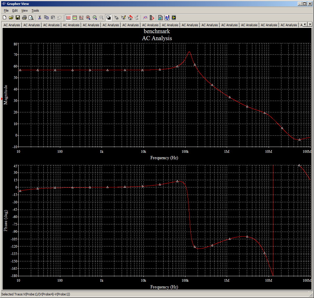

Yes, I know you will see 2 pole like frequency response if you put a probe correctly.
The problem is what cause it?
I believe even you remove Miller Capacitor. You will still see that behavior. 180 degree phase dip, and rise up to 90 degree at high frequency. (Thanks to all software for letting us able to see frequency response without Miller Cap)
That's is caused by the R & C in series connected to input&output of EF stage.
The CURRENT gain of EF stage is like a 1-pole rolling down system(it is related to Ft of the transistor you use). The input impedance of EF stage will decrease as frequency climbing up. Let's assume it is 1 pole like rolling down on input impedance. That means, as the same amount current driven from VAS, the open loop voltage gain will 20dB/Oct rolling down.(V = RI)
If you put a capacitor between input/output of EF stage. The capacitor will suck more current from VAS as frequency climbing up, it will cause additional 20dB/Oct rolling down. So far, you get 40dB/Oct rolling down. What if you put a resistor in series with that capacitor. It creates a ZERO at high frequency. That's how you get that 2 pole like Frequency Response!!
The 2 pole like response is caused by RC network around output stage, if it is driven by current source. (low gain VAS with small Miller Cap is good example for current source.)

I've done some sims of the global loop for resistors in series with the MIC capacitor - schematics and results attached. The two circuits are a basic three-stage amplifier with discrete components and an amplifier built with ideal opamps. In both cases, the ULGF without MIC is ~10MHz. I included the opamps as I've seen Walt Jung use MIC with them a number of times.
The first set of results shows the global loop gain without MIC (upper traces); and the global loop gain with the ULGF aimed at 500kHz by the 17pF MIC capacitor and the 19k feedback resistor (lower traces). Green lines are the discrete circuit and blue are for the opamps. They show MIC working as predicted.
The second set of results has the MIC resistor set to three times the feedback resistor similar to the JLH circuit that dadod posted. It appears that MIC doesn't adequately compensate the global loop on its own in this case, as the loop gain plateaus at ~9dB before falling to unity at the original 10MHz.
My gut feel is that making the MIC resistor 1/3 of the feedback resistor would be good but needs more simulation which will have to wait.
"TMC" is a single pole system from the perspective of the input stage, but it is a double pole single zero system fro the perspective of the second stage and the ouput stage. viz. it's simply double pole compensation applied around the second and output stages.
Page 263 of D.Self's APADH 5th edition will lead you to the answer, eventually. Read it four or five times and meditate upon the ideas. You will holler Eureka!I for one would like to know those reasons.![]()
The voltage difference between VAS and output stage is negligible. It is unable to form another pole.
Here is what I am talking about at http://www.diyaudio.com/forums/solid-state/230492-audio-power-amplifier-design-book-douglas-self-wants-your-opinions-77.html#post3465453
2 pole is there, but it is not because of TMC network.
I simulated TMC without miller capacitor connected. Here we got 2 pole.
