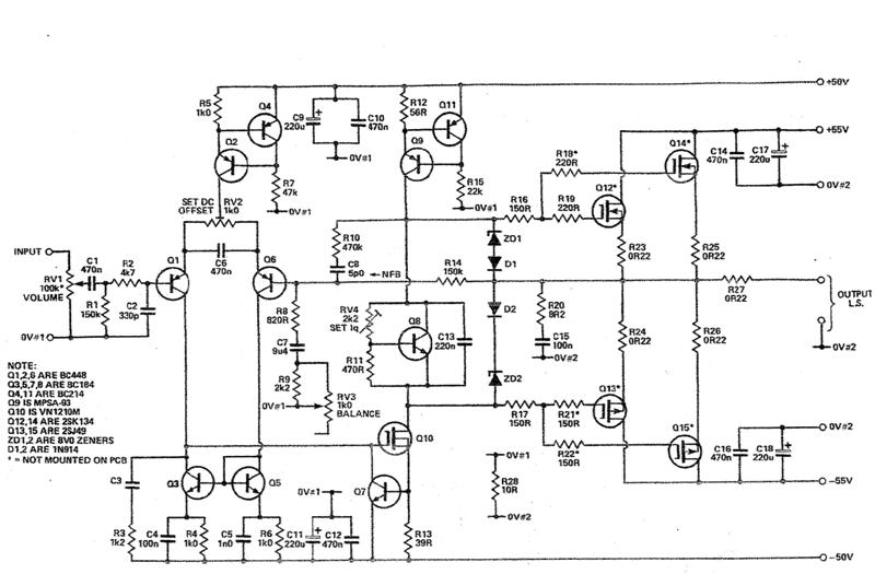

If I remember corrrectly, J. L. Hood used 220p MIC on his MOSFET designs. I am not certain he degenerated his input stage though.
Nevertheless, 220p is too high; should have been more like 22p methinks.![]()
JLH used 5pF in series with 470k resistor in his 80W MOSFET amp, but he used RC network too, C3, R3.
Damir
Damir

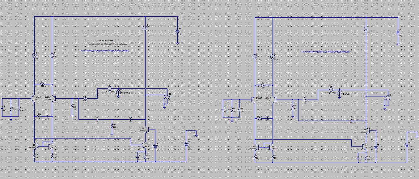

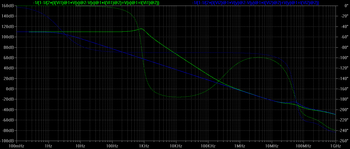

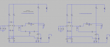

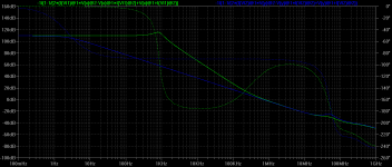

Does it still work the same as MIC? With R10 > R14, the series impedance of the MIC compensation components is never <= the global feedback resistance.
I believe its still MIC, in sprit, if not in actuality. C6, along with Rdegen=5-- Ohms, R10 and C6 form the comp.
The LTP degen is pretty drastic, and this is why he got away with a high value for R10. I suspect the mosfet TIS transistor (Q10) gate capacitance also played a role here, but am open to correction on this one.
I think I would have done things a bit differently, but of course I have the benefit of a very good simmulator (LTSpice) and all the learning thats taken place the last 15 years or so in this field.
Oh dear - I am going blind 😱 - yes, those networks across the LTP mirror and the mirror ballast resistors. He must have had his reasons . . .
