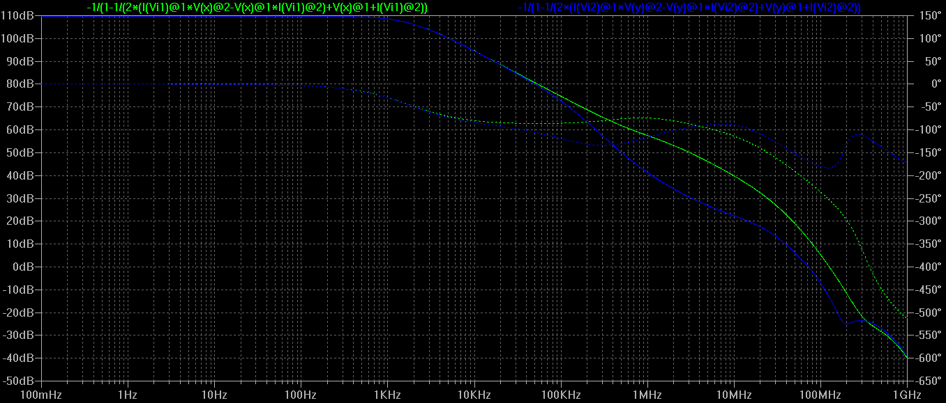

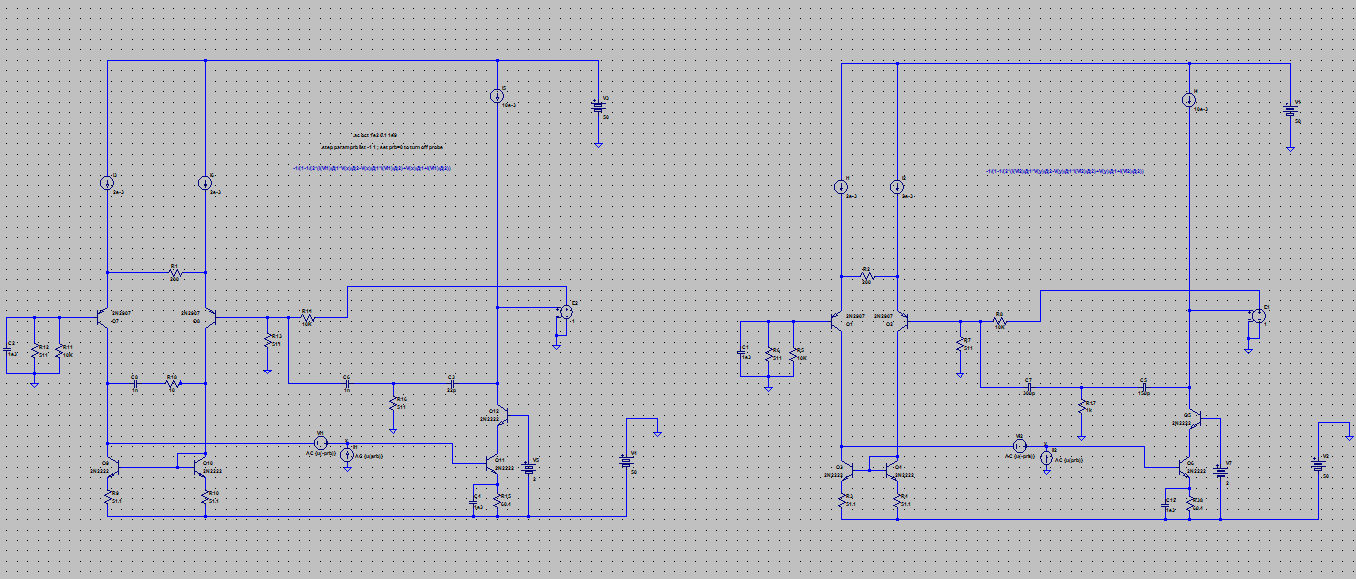

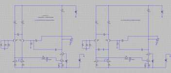

Profound apologies to you bob, Bonsai and others! I have run the simulations with LTSPICE stock BJT models and have found the following:
1) Pole splitting does occur in fact with MIC, which is correctly so-named by Bob.
2) Only a fifth of the compensation capacitor used in ordinary Miller compensation may be used with MIC for the same loop transmission. I don't know at this stage why this is the case. Any ideas anyone?
3) MIC is NOT lead compensation at all, although it appears to produce a zero far beyond unity loop gain frequency that does not occur with ordinary Miller compensation.
4) The MIC local loop is unstable and requires compensation.
Now, why I obtained results in 2004 that suggested that MIC is lead compensation with the output stage excluded and did not cause pole splitting, I don't know at this stage; I must have made an elementary error with my simulations. Apologies to all.😕

You are exactly right regarding the need for compensation of the local MIC loop. The shunt lag-lead compensation across the LTP collectors I have used in the past was the best I could come up with at the time for the differential topology I was using. As mentioned above, it would be nice to come up with a more elegant way to compensate the MIC loop, such as with an embedded Miller loop. Not sure how to do that with the differential IPS/differential VAS topology I've been using, but there may be a way to do it with more common topologies.
As with other amplifiers I have designed with an EF-preceded VAS followed by an output Triple, sometimes a series R-C shunt to ground from the VAS output node is needed for best stability. In one case, I used values on the order of 100pF and 200 ohms in series for this shunt network.

I think this is the best you could do with your differential topology.
Out of curiosity I also simmed the MIC loop without shunt compensation: ULGF = 38MHz, PM = minus 86 dgr. and GM = minus 16dB. IOW, highly unstable and one definitely needs this shunt compensation.

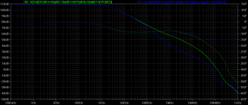

You're absolutely right. The shunt RC network adds a pole zero pair with the pole lowering the loop gain rapidly and the zero coming in before unity loop gain frequency to increase stability margins. Simulation is absolutely essential to fix the location of the pole and zero. Action of the pole-zero pair on minor loop gain response is shown below; phase shift at unity loop gain frequency is roughly -169 degrees with the RC network in situ and -254 degrees without it.
Bob, also note that only a fifth of the value of the compensation capacitor used with ordinary miller compensation may be used with MIC for the same loop gain. (do you know why this is the case?
This is excellent: slew rates are now comparable, potentially, with those obtainable with so-called "current feedback" arrangements.😎
We can now use "TMC" or TPC in a MIC configuration, I think (not tried it yet), to produce a potentially magnificent amplifier. 😎
We now have to derive the agebraic expressions relating to the loop gain and the RC network to quantify the design process.

Bob (and Andrew?) seem to have taken my point that the MIC loop needs some compensation but perhaps not this shunt compensation.
Ordinary Miller is better than shunt so nested (inner) Miller looks potentially better than an inner shunt.
The idea looks reasonable even if inapplicable to some (Bob's?) circuits.

The MIC loop will need compensation. You have a wide band LTP pair feeding a high gain voltage stage (I'll resist the temptation to call is a TIS ) with an HF pole due to Cob nestling inside a global FB loop. As Bob indicated earlier a ULGF of about 10 MHz for the MIC loop delivers good results.

Well, I think you would want to set the pole corner frequency low enough to ensure that the ULGF of the MIC loop occurred at 20 dB/ decade. You could TPC it I suppose, but my goodness why would you want to- just for a few more dB of loop gain?
Hi Michael
I suspect that zero may be a product of the capacitor in parallel with the TIS emitter resistor, but I can't read the value from your picture. What is it?
It's not in Bob's schematic but I had planned to add this to cancel a pole. What was your reason to include it?
Hi David,
No, the zero has nothing to do with the capacitor shunting the TIS's emitter resistor. The value of that capacitor is 1K, and is only there to prevent the resistor having any effect on loop transmission.

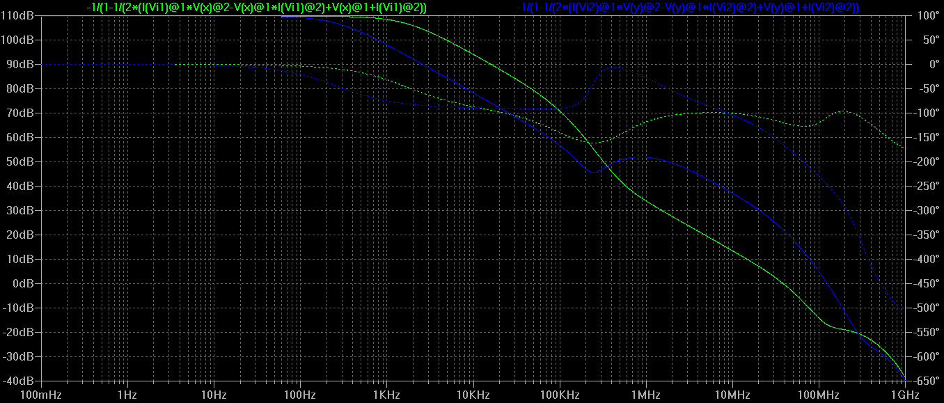

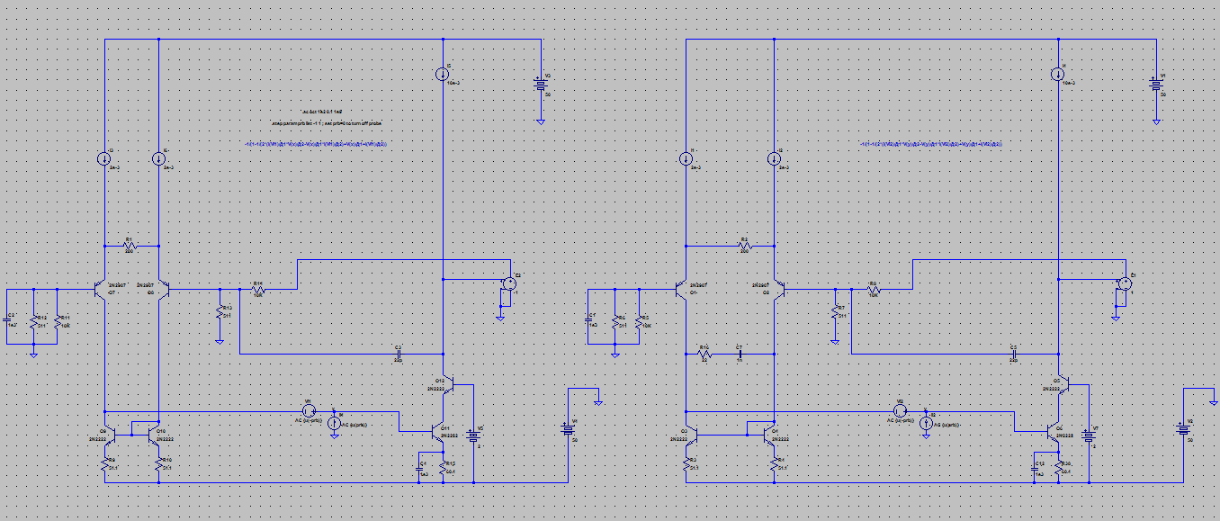

Ok, here is the minor loop simulation with TPC MIC compensated with shunt lag pole-zero network and ordinary TPC MIC without the pole-zero shunt compensation network.
The compensated TPC MIC gives phase shift of -119 degrees at unity loop gain, while the uncompensated TPC MIC minor loop gives a phase shift of -247 degrees at unity loop gain. The later is clearly unstable, while the former is very stable indeed.
It would appear TPC MIC with a compensated minor loop is a trully excellent idea indeed!😎
