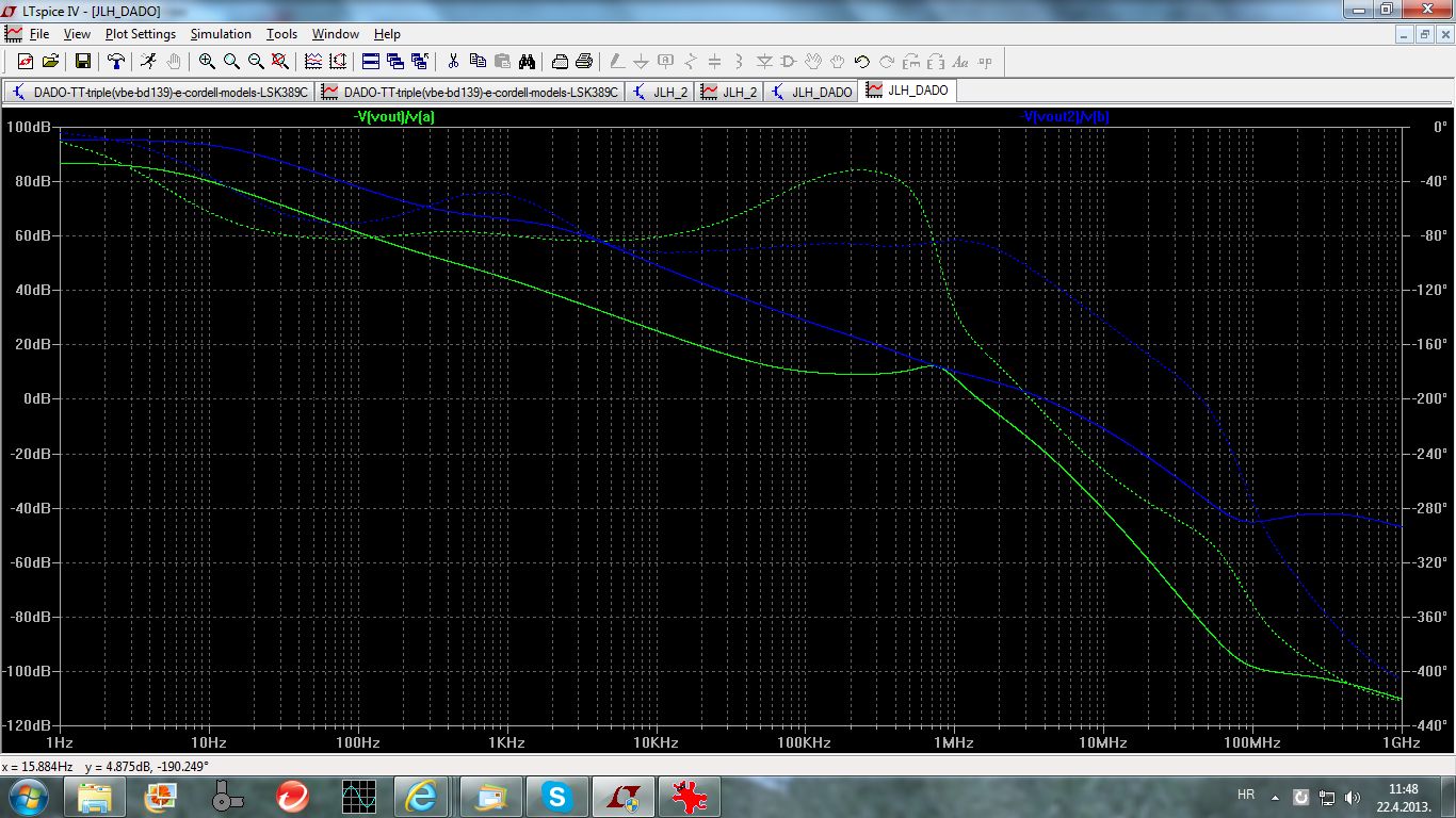

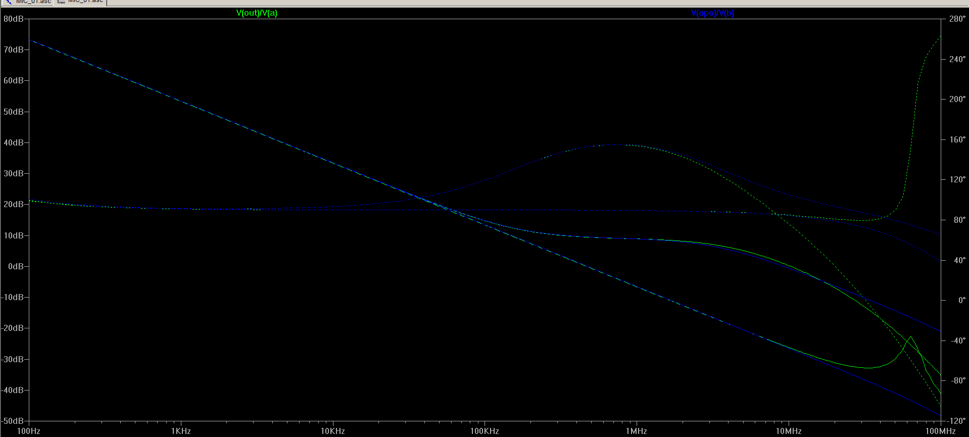

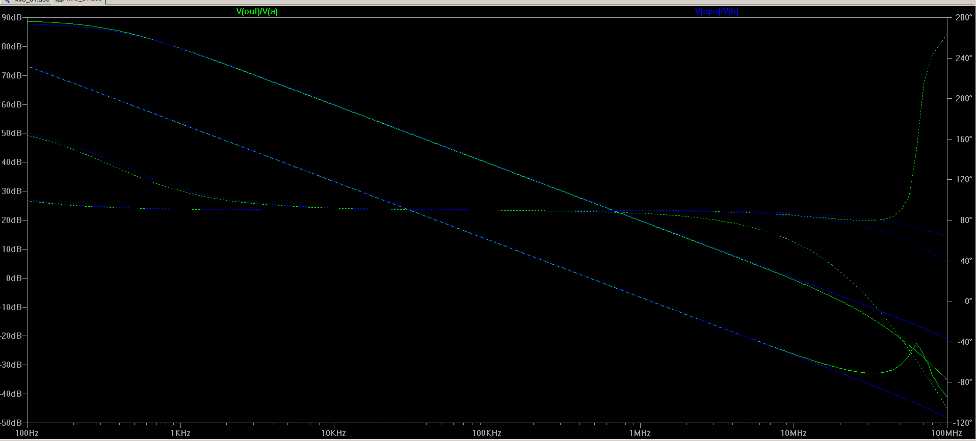

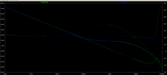

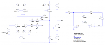

This blasphemy, probably, but I was not satisfied with the sound of the JLH 80W MOSFET amp, something was wrong. That was long time ago, and when finally I've got an oscilloscope I noticed small oscilations sometimes, and I did not like to high gain and to high value resistors used in the NFB, so I modified it.( http://www.diyaudio.com/forums/soli...power-amplifier-modifying-11.html#post2794339 ).
It is not anythig close to MIC anymore, but I like it better now. I used different small MOSFET as I don't have VN1210 model, used BSS123, so it could be some differnces there.
LG picture, green original JLH, blue modified.

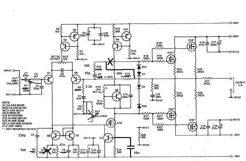

If I remember corrrectly, J. L. Hood used 220p MIC on his MOSFET designs. I am not certain he degenerated his input stage though.![]()
I've just checked the few JLH articles I have. The MIC components were:
- 1982: 5pF + 47k; cf 33k feedback resistor
- 1989: 10pF; cf 56k feedback resistor
- 1993: 5pF + 120k; cf 39k feedback resistor
Perhaps the 220pF was only very early on in his writings, or you have misremembered?

In at least one article he suggested the resistor be "tuned" for best squarewave shape, using a pot wired as rheostat.I've just checked the few JLH articles I have. The MIC components were:
This implied that different builds would require a different R even though all were supposed to be using the same PCB and the same components.
It seems clear that he recognised that the stability margin does vary with device parameters.

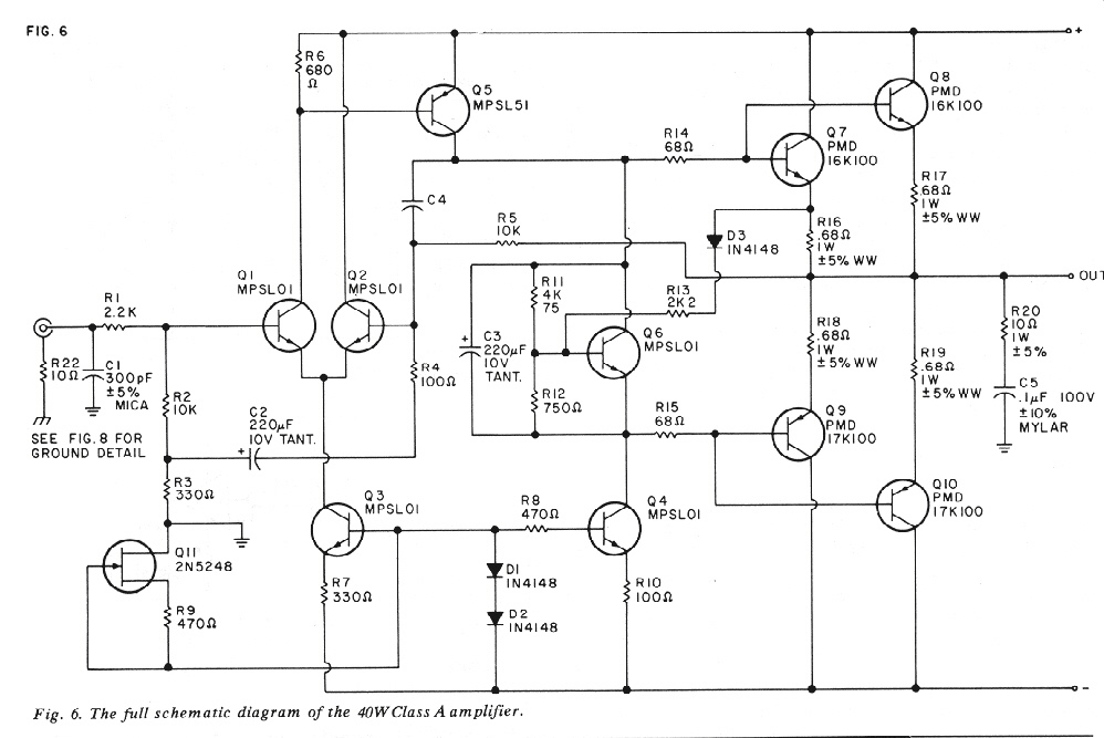

I'm sure y'all are aware of the A40 (40 watts class A) amplifier that Nelson Pass published in Audio Amateur (1978). Here is the full article and the circuit schematic is below. Please note frequency compensation capacitor C4.
JLH used 5pF in series with 470k resistor in his 80W MOSFET amp, but he used RC network too, C3, R3.
Damir

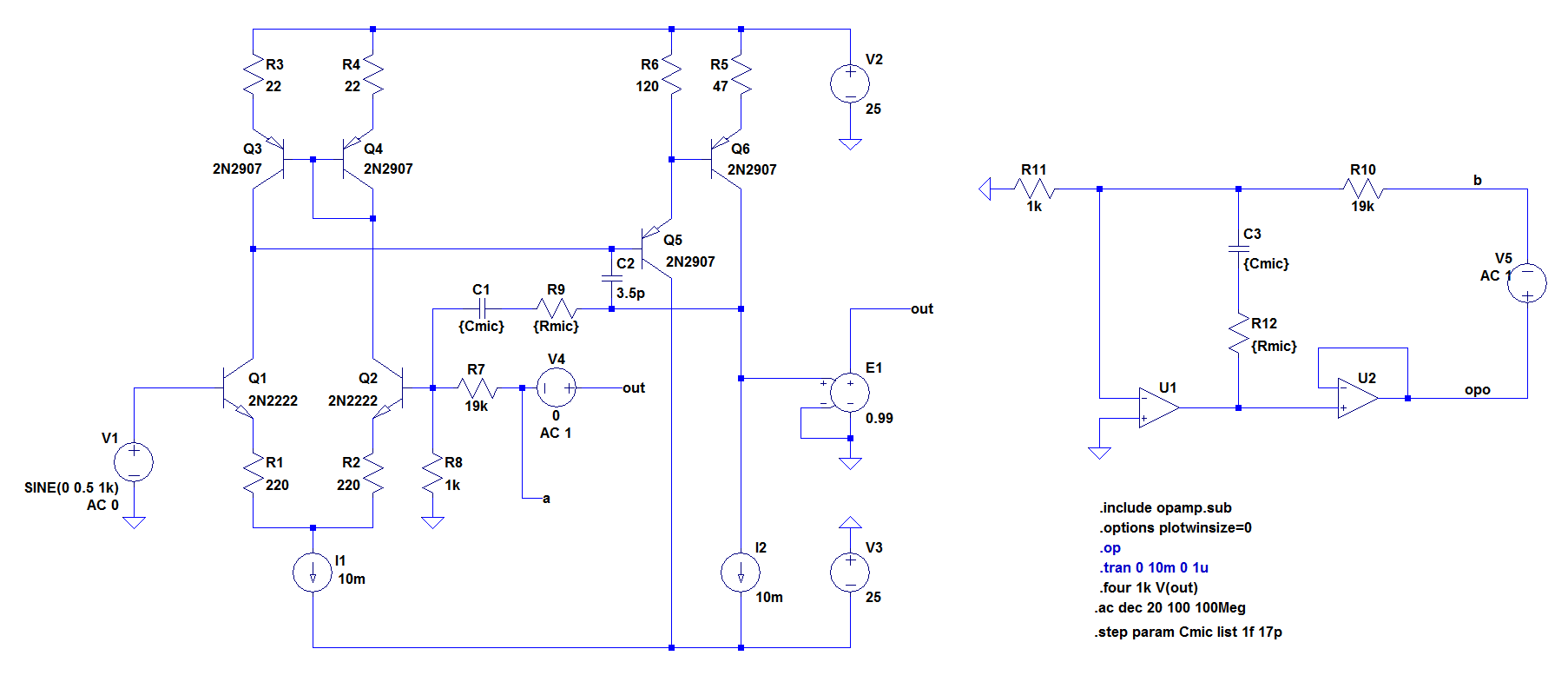

Does it still work the same as MIC? With R10 > R14, the series impedance of the MIC compensation components is never <= the global feedback resistance.
I've done some sims of the global loop for resistors in series with the MIC capacitor - schematics and results attached. The two circuits are a basic three-stage amplifier with discrete components and an amplifier built with ideal opamps. In both cases, the ULGF without MIC is ~10MHz. I included the opamps as I've seen Walt Jung use MIC with them a number of times.
The first set of results shows the global loop gain without MIC (upper traces); and the global loop gain with the ULGF aimed at 500kHz by the 17pF MIC capacitor and the 19k feedback resistor (lower traces). Green lines are the discrete circuit and blue are for the opamps. They show MIC working as predicted.
The second set of results has the MIC resistor set to three times the feedback resistor similar to the JLH circuit that dadod posted. It appears that MIC doesn't adequately compensate the global loop on its own in this case, as the loop gain plateaus at ~9dB before falling to unity at the original 10MHz.
My gut feel is that making the MIC resistor 1/3 of the feedback resistor would be good but needs more simulation which will have to wait.
The 220p and discussion was in his 1972 HiFi News 75W amplifier article. I may have the instructions for the Powertran kit which has a full reprint but it might be difficult for this beach bum to find.I've just checked the few JLH articles I have. The MIC components were:

He has the circuit in his "Valve and Transistor Audio Amplifiers" book.
http://books.google.com.au/books?id...r_esc=y#v=onepage&q=jlh 75w amplifier&f=false
Its fig 8.12 on pg 154 if you can persuade google books to show it.

The 220p and discussion was in his 1972 HiFi News 75W amplifier article... He has the circuit in his "Valve and Transistor Audio Amplifiers" book. Its fig 8.12 on pg 154 if you can persuade google books to show it.
It's shown as 220uF in that book, but I have another version of the schematic that confirms 220pF was the value (I thought maybe 22p was intended but misprinted as 220).
The feedback resistor is 22k in that design giving ~30kHz ULGF for the global loop. JLH says the design was good for 0.01% THD at 75W/8R (frequency not stated). Is that realistic for a class AB quasi-complementary output stage with bugger all feedback around it? Perhaps I'm missing something in the details...
