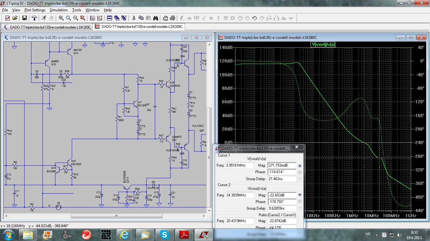

The voltage difference between VAS and output stage is negligible. It is unable to form another pole.
Here is what I am talking about at http://www.diyaudio.com/forums/soli...-self-wants-your-opinions-77.html#post3465453
2 pole is there, but it is not because of TMC network.
I simulated TMC without miller capacitor connected. Here we got 2 pole.
What you need to simulate is the total loop gain enjoyed by the second stage and the output stage with "TMC". Try in in LTSpice; i doubt that it can be done accurately in Multisim.
Is this correct way to simulate TMC?

I've already done the simulation as indicated here:
http://www.diyaudio.com/forums/soli...-self-wants-your-opinions-73.html#post3463332
See below:
.....I am also a bit dubious about the utility of the 680 ohm (R13) in series with the MIC capacitor. The resistor adds a zero to the major loop gain response that is far beyond unity loop gain. The value of this resistor should have been in the region of 2.2K to bring the zero closer to unity loop gain frequency so as to enhance stability margins. Moreover if the zero is placed just before unity loop gain frequency, it has the effect of grossly extending the unity loop gain crossover, which may again compromise stability margins.
2.2k MIC resistor is about half the global feedback resistor so the gain margin for the global loop would be ~6dB. I guess this is OK since it's set by resistors rather than less-reliable components. Is this the best value, or just the limit of how far you were willing to push it?
Additionally, care must be exercised as inclusion of R13 in series with the MIC capacitor compromises the MIC local loop's stability margins.
Did you vary (increase) the MIC capacitor to keep the ULGF constant while increasing the MIC resistor? Was the compromise to the MIC loop's stability due to the lighter load on the VAS/TIS due to the increased MIC resistor?
Never mind this part - I thought the resistor would start to affect the global ULGF at lower values than it actually does. The MIC resistor has to be almost equal to the feedback resistor before the effect is significant.
Still interested in this part though. How does what follows match your results on Bob's amp?
For the discrete amp from post 751, I set Rmic to 6.8k (~one-third of the global feedback resistor). For 10MHZ ULGF of the MIC loop, it needed an 8pF Miller cap around the VAS/TIS. MIC loop phase margin was 68 degrees and gain margin was 14dB.
Without MIC resistor, 8pF Miller cap gave 18 degrees MIC loop phase margin (at 50MHz) & 3dB gain margin. A 22pF Miller cap was needed for 68 degree phase margin (at 22MHz); and 43pF Miller cap for 10MHz MIC ULGF (at 105 degrees margin).
I kept the input inclusive Miller compensation capacitor constant. At this stage I am not certain why the resistor increases instability in the minor loop. I suspect it's due to the fact that the zero introduced by the resistor in the major loop appears as a pole in the minor loop.
