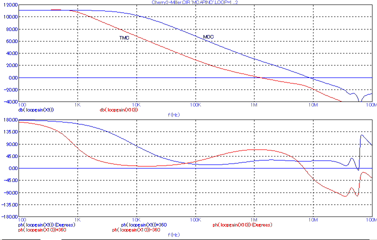

So far I got little response on my question. Presumably, most people had a feeling that it is a catch question. Indeed it is so. Have a look at the following picture, which depicts the gain and phase response of a TMC respectively an OIC amplifier. The one side of gain probe was put at the output, the other side connected to the FB resistor and compensation stuff (TMC resistor respectively Cdom). The TMC amp, as expected, shows a roll-off of near 12dB/oct, which indicates it's a 2nd order system (nothing new under the sun). The OIC amp on the other hand, which seems to have a 1st order compensation, also rolls-off with near 12dB/oct.
So we have the funny situation that the one amplifier with a 2nd order compensation scheme shows (basically) the same behavior as an amp with a 1st order compensation. Shouldn't we call all amplifiers a >1 order system, instead of only TMC or TPC amps? But if we reject this idea, then we could call, for the same reason, a TMC amp a 1st order system.😉

When you say that you mean the system then the answer is "it depends".
Since OIC amplifiers are notorious for instability some presumably have more than two poles.
Even Miller compensated amps have second order behaviour, just not where we normally care.

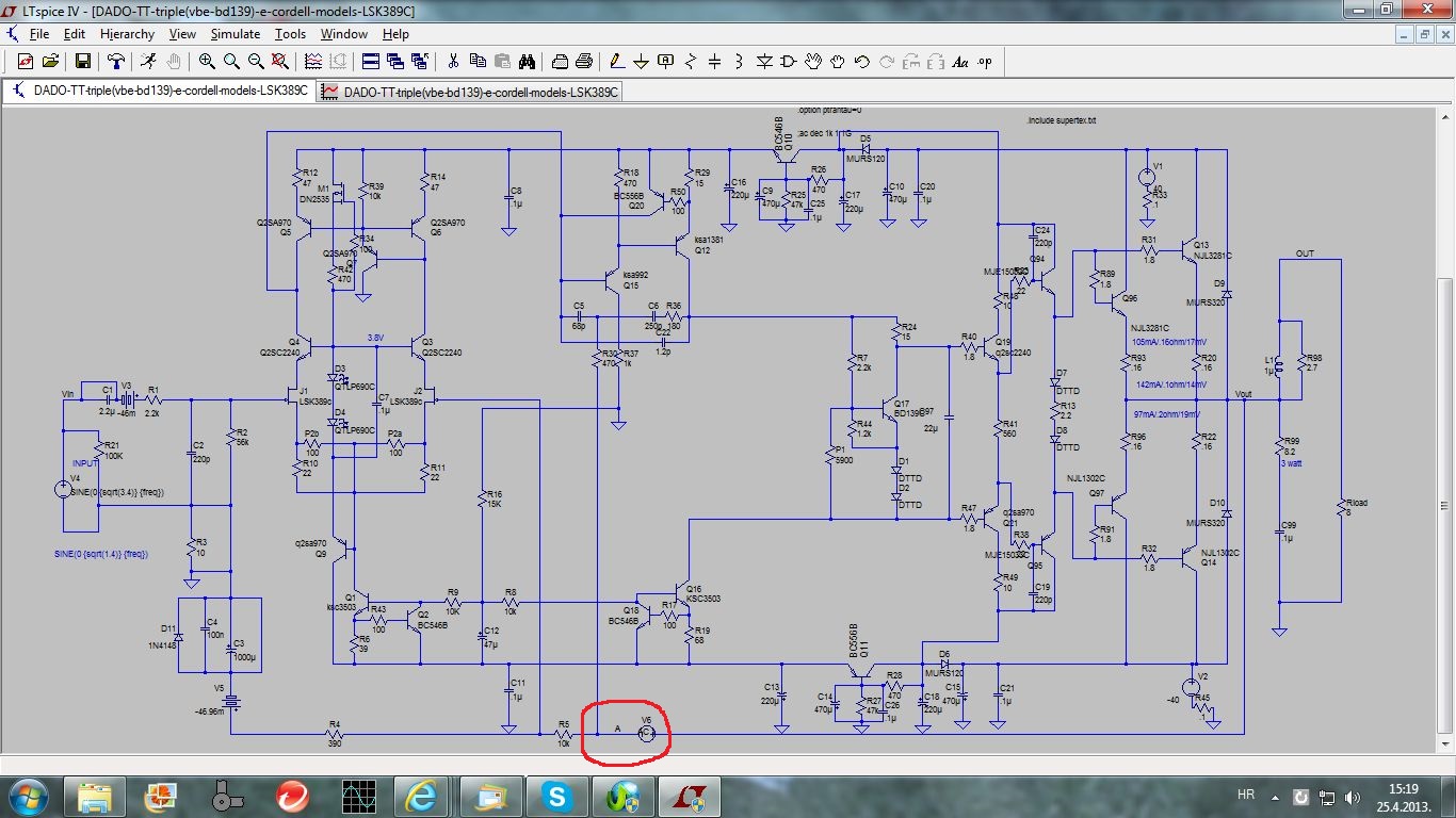

Hi Edmond,
As I am not getting any answer on my question about TMC simulation http://www.diyaudio.com/forums/soli...-self-wants-your-opinions-79.html#post3466242, and for me, your TMC simulation, according to your description, was done in the same way, I would like to get your oppinion if my simulation is good enough to evaluate TMC amp?
Regards Damir
Regards Damir
Hi Edmond,
Regards Damir

I'm wondering if you have ever read the answers you have got so far, both at Andy's place by me and syn08 and at this place by eg. jcx.
First of foremost, Edmond (jcx, syn08 and I) use Tian probe, not a simple probe.
So the first thing you should do is is using a Tian probe, maybe it would be easier to see what you are doing and analyse your results.
Secondly you don't show what you have in front and after the amp (LPF a.s.o). (in my opinion, everything in front and after the amp should be removed when you do an AC analysis (everybody don't agree about this)). In my opinion local oscillation may not show up if you strangle the analysis by external components. (The same with transient analysis of clipping and square wave, (if ringing shows up, it's better to analyse it then hiding it)
If you look at Edmond's site you will see where he puts the probe for analysing the different loops, both the whole amp and the inner loops.

Sorry if my simulation picture was not clear enogh. Yes, I could use Tian probe, but just to show how to get a TMC amp Loop Gain, were TMC second order slope is shown, simple voltage probe is good enough.
Here is whole simulation picture with the probe position encircled.
BR Damir
BR Damir
Okay, that's one way to do it, in particular if you want to prove it's an 2nd order system.
The other way, i.e. R30 directly connected to the output, 'proves' it's a 1st order system (which it isn't), though it nicely explains why you don't get overshoot. I think you should simulate both loops and both of them should have sufficient phase and gain margin. Also check the Miller loop itself (put the gain probe between Q15 & Q12, for example), so that makes three of them.
E.

Thanks Edmond,
Yes I simulate both way, R30 connected to the output, but this loop gain shows to optimistic phase margin, I think, and as you said, 1st order system which it isn't. And don't need to prove that it is 2nd order system, but to see what phase and gain margin I could have.
I never saw in this thread TMC simulation in the way that TMC resistor was connected after probe and I was afraid that I do it wrongly, or could be that I missed it here.
E.
NB: The amp was a blameless one with a cascoded TIS.
The output stage itself is a one pole system(it is related to transistor ft), when it is under current driven. I mentioned this in orther threads. Without miller cap directly connect to vas output, the vas behavior is just like a current source! Thus, sometimes you will find some 2nd order behavior in a one pole system.
That's exactly my point! Also with a TMC amp you will find 'some' 2nd order behavior. Therefore, it is still debatable whether such an amp should be called a 2nd order thingy, that is, for as long we call a Cherry amp a 1st order system.

Edmond, I'm having trouble visualising all this. Could you post the exact circuit with these probes please?... depicts the gain and phase response of a TMC respectively an OIC amplifier. The one side of gain probe was put at the output, the other side connected to the FB resistor and compensation stuff (TMC resistor respectively Cdom). The TMC amp, as expected, shows a roll-off of near 12dB/oct, which indicates it's a 2nd order system (nothing new under the sun). The OIC amp on the other hand, which seems to have a 1st order compensation, also rolls-off with near 12dB/oct.
Where do you put the Tian probe to look at this? Someone mentioned you have a web page with this & more pearls of wisdom... The other way, i.e. R30 directly connected to the output, 'proves' it's a 1st order system (which it isn't), though it nicely explains why you don't get overshoot.

No! I don't want a shoreless discussion about irrelevant circuit details. I've learned my lessons on this forum. Sorry. The message is simply that a Cherry amp has also significant 2nd order loop gain properties. How large doesn't matter.
Regarding the probe:
The one side of gain probe was connected to the output, the other side connected to the FB resistor + compensation stuff (TMC resistor respectively Cdom), just as Damir did with his TMC amp.
Regarding the schematic:
The amp was a blameless one with a cascoded TIS plus 2x33pF 'Cherry caps' (you know what I mean by that) and 50nH lead/trace inductance to the output devices. That's all.
If it has second order behaviour then it is a second order system, by definition.
So it is not one pole, it just means your schematic is over simplified.
(Well, we could have one pole and multiple zeros but that's pedantic)
That's exactly my point! Also with a TMC amp you will find 'some' 2nd order behavior. Therefore, it is still debatable whether such an amp should be called a 2nd order ...
You quoted my earlier note that even simple "one pole" amps have extra poles eventually.
So the solution is simply that a system is only defined to be "N" pole over a definite frequency band.
A TMC amp is two pole (and one zero) over the frequency band of interest.
An OIC amp could presumably be one or two pole (or worse!), dependent on the circuit values, over the frequency band of interest.
