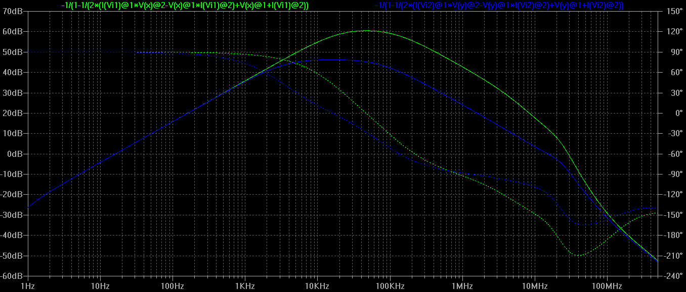

Douglas, on page 137 of the fifth edition you state the following:
Would that this were true: alas, the cascode compensation scheme makes the minor loop unstable according to my SPICE simulations. Shunt capacitance (of the order of 1nF) at the transimpedance stage's output to ground is now required to make the minor loop stable.That describes the ‘ brawn ’ approach to improving PSRR. The ‘ brains ’ method is to use the input cascode compensation scheme described in Chapter 9. This solves the problem by eliminating the change of reference at the VAS, and works extremely well with no compromise on HF stability. No filtering at all is now required for the V-supply rail – it can feed the input stage and VAS directly.
As noted above input cascode compensation is unstable giving a phase margin in excess of 200 degrees at unity minor loop gain frequency (green trace) if the minor loop is uncompensated.
It is preferable to compensate the minor loop, if input cascode compensation is used, by shunting the input to the second stage to ground with 2.2nF in series with 4R7. This lag-lead network introduces a pole at a lower frequency, courtesy of the 2.2nF capacitor, which reduces the unity loop gain frequency while the 4R7 resistor introduces a zero in the vicinity of unity loop gain to further enhance stability margins. Phase shift at unity loop gain frequency in this case is only 119 degrees (blue trace)
Well, that's simulation for you. An indispensable tool, but no substitute for building the real thing. All the power amplifiers I designed for TAG-McLaren used cascode compensation in the form shown in the Fifth edition of APAD. There were no stability issues with any of them.

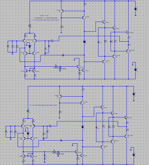

The component values on your schematic are too small to read. Maybe the answer lies in those values.

You can see the component values by downloading the ltspice file that I attached together with the models I used. You'll find they are the same component values used in your Blameless designs.
I still think cascode compensation is unstable unless the minor loop is itself compensated.
C13 and C14, at 100 uF each, with no softening resistance, are a little scary to me from a peak current and a local stability point of view. Is that something you've done in real life and sims? I'll admit straight away, that is an intuitive observation, based on neither simulation nor analysis...I'd just be interested to hear your experience with it...thanks...Dan
The component 'value' of the VAS/TIS degen. resistor (RE) is even smaller, i.e. zero Ohm (you couldn't have overlooked it 🙂 ). Maybe the answer lies in this value.

I'm guessing ... but are the BJTs completely different from Doug's?You can see the component values by downloading the ltspice file that I attached together with the models I used. You'll find they are the same component values used in your Blameless designs.
I note you have made several changes to his circuit ... Oh! I forgot. You make only trivial changes that have no effect on stability or performance.
Which circuit in Doug's book is it based on?
But I'm probably missing your point. Michael, is that second model, the one on which you have 'cured' the instability, an example of what YOU consider good practice and good performance/stability??
If it is, I'm sure we will all be eager to download the .ASC and learn something. 🙂
...with the models I used. You'll find they are the same component values used...
So what? The small signal BJTs used shouldn't affect the result. Surely a man of your stature should know this?🙄
Richard Lee may be reassured that a quick look at the models shows some rather implausible parameters.
Best wishes
David
Really? Such as what? Use any reliable models of your choice and see whether you arrive at a different result.
Well, the very first line has a 2n3904 with a VAF of 1000V, about 10 or 20 times a plausible value. OK, not a transistor in the simulation but a bit of a worry to start.Really? Such as what?
The ZTX796a that you do use has a VAF of 450v that also seems implausible.
The ZTX1056a has a BR of 80, probably should be around 1 to 4.
Mainly a problem at low Vce. But that is exactly what those transistors will have, since they are in the current mirror.
The outputs have implausible VAFs too. This time about 10 times too low.
Probably not relevant in this particular issue but an obvious problem with the circuit.
The BF of one of the outputs is 438, about 3 times more than reasonable.

I didn't use a 2n3904. 🙄 I don't think the Zetex models are a problem; I've used them for years to troubleshoot real circuit problems succesfully.
As I said you can substitute any models you prefer and see whether you arrive at a different result; I would suggest you don't post anything until you've done so.🙄
