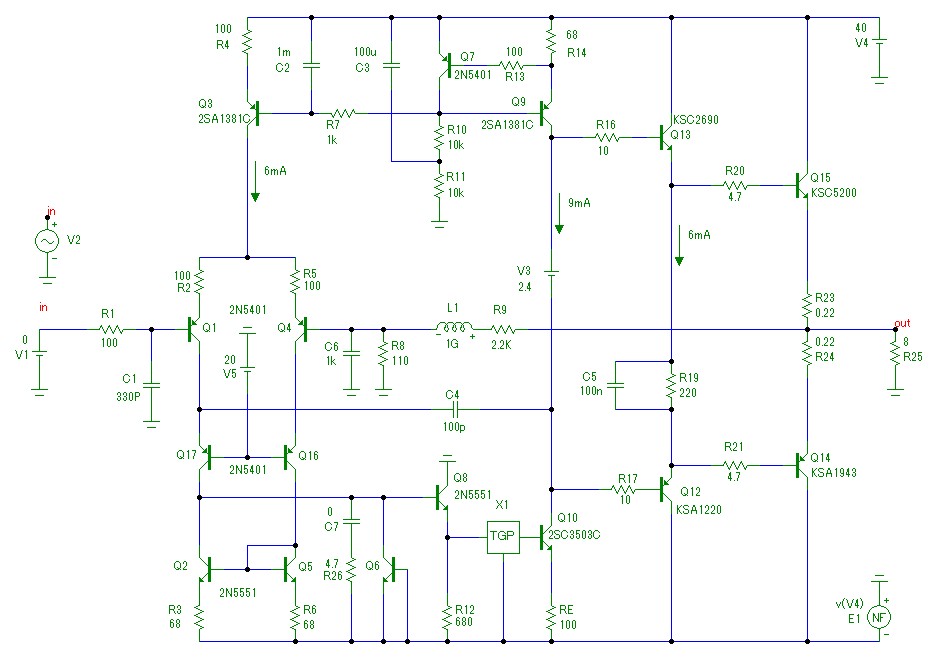

Michael, if you are referring to the schematic you posted here, no simulations are required to explain why you got instabilities in the minor loop. You did not degenerate the VAS (or TIS if you prefer) - which would be highly unusual for any practical implementation.
Degenerating the TIS only compromises minor loop stability margins and has nothing to recommend it.
You can (just) get away with this in a current source loaded TIS, but in fully balanced designs that have the LTP resistevely or mirror loaded you run the risk of forcing an imbalance in the LTP - degen helps to accurately define the TIS standing current.
Degeneration of the TIS has much to recommend it in my view an especially in fully balanced designs.
The TIS degeneration resitor if used should be bypassed with at least 1nF capacitor to prevent it from adversely affecting minor loop stability margins.
Come on now Michael. Thousands. Perhaps millions of amps have been built without this embellishment and without any instability.
Show the sim and then lets decide if it in fact is a real world problem. I doubt it!

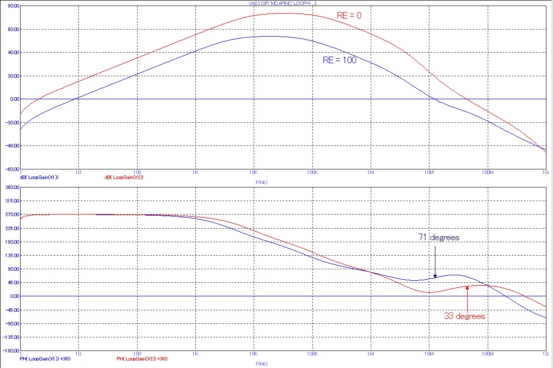

Admittedly, the loss in minor loop phase margin is small, but it is repeatable and consistent. Then again I didn't claim that it was a major problem.
The point is, the assertion made by Cherry, krglee and others that TIS emitter degeneration promotes stability in the major or minor loops is wholly incorrect.
Green trace: minor loop phase shift of 153 degrees at unity loop gain frequency without emitter degeneration.
Blue trace: minor loop phase shift of 161 degrees at unity loop gain frequency with emitter degeneration of 22 ohms.
But, you have to weigh that up against the fact that in non-current source loaded TIS stages without emitter degen the TIS current is ill defined, and worse, the LTP is in all likely hood in a state of imbalance. The LTP imbalance issue applies to all topologies without emitter degen BTW.
How do I know this? Because I have used the emitter degen resistor to balance the LTP and as a consequence, reduce overall system distortion.
Try it. It works.

Well Michael, time is not the most precious resource for a poor EE student, so I ported your post here to PSPICE in our lab. I re-captured exactly your schematic, used the exactly the same values (although I have some concerns, like why in hell are you running the pre-drivers so hot at 25mA) and used exactly your models, as posted.
Attached are the results. For zero ohm TIS degeneration, the minor loop is definitely unstable, with an ULGF of 28MHz and a phase margin is -23 degrees. For 50 ohm degeneration, the minor loop is marginally stable with an ULGF of 22MHz and a phase margin of 1.5 degrees. Finally, for a 100ohm degeneration, the ULGF is down to 17.6MHz and the phase margin is some 22 degrees, which is acceptable for the minor loop.
Draw your own conclusions.

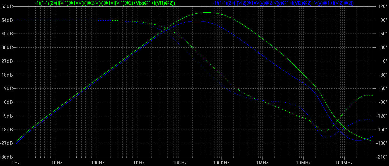

Hi Andrew,
Please look here for some more plots the of gain and phase response of a TIS inner loop, one with no TIS emitter resistor (red curves) and one with a 100 Ohms emitter resistor. With RE=0, the loop is marginally stable (PM=33 degrees), though with RE=100, the circuit is more and also sufficiently stable (PM=71 degrees).
E.

I have no idea why you're getting those results, as I have no idea how you run your minor loop gain simulation.
Does Pspice have a loop gain probe? If so, on what principal does it work?
Can you please use the same scales I used?
Cheers.
Cheers.

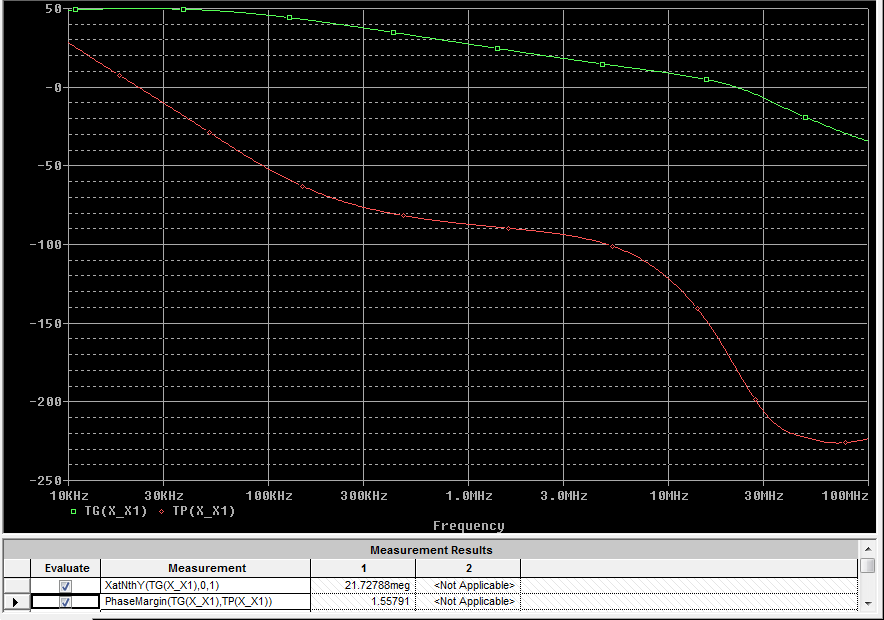

I use a Tian probe. I also tried the Middlebrook method (duplicate the schematic, etc...), to exactly the same results (as expected).
I can't be bothered to redo everything only for your convenience of rescaling 😀. The results, as they are, are more than conclusive.

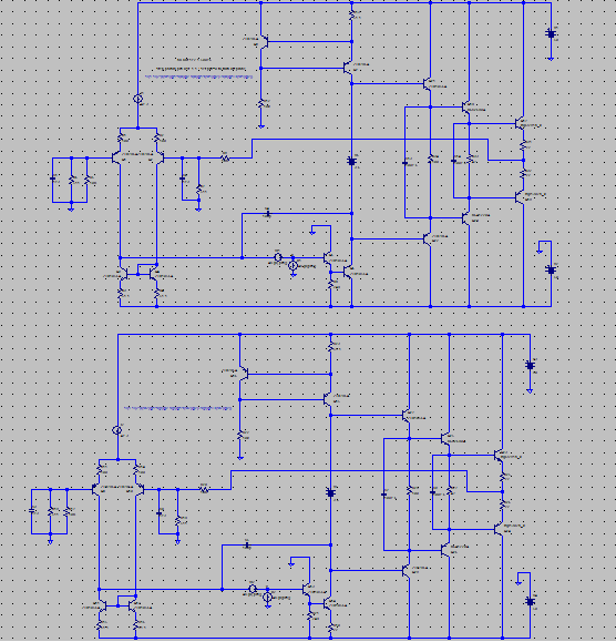

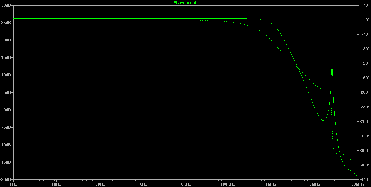

Last night I simulated two different amplifiers, each with and without the Miller compensation fed to the emitter of the cascode transistor. I used my models.
My results indicate that there is cause for concern with the cascode Miller compensation (CMC) approach, but the impairment to stability depends on the particulars of the amplifier in which it is used.
In particular, it appears to depend on the speed and HF gain of the output stage. A more pedestrian output stage, like a double, will load the VAS at the high frequencies where this occurs to the point where it crushes the gain of the local loop. Putting it another way, the load of the output stage in any given design may effectively act to compensate this minor loop. A lightly loaded VAS will, on the other hand, invite this form of instability. Think about the AC beta at 20-40MHz of an output double using ordinary transistors and the point is clear. Even with no external load, the output Zobel will create a load.
The first amplifier had a cascoded BJT LTP IPS loaded with a current mirror and a 2-transistor single-ended VAS. It had an EF Triple output stage and two pair ThermalTrak output transistors. It had a ULGF of 1MHz. With conventional Miller compensation its closed loop response fell off smoothly out to 100MHz. With CMC there was a distinct “shoulder” in the roll-ff in the vicinity of 34MHz. This shoulder caused the amplitude to be about 7dB higher at 34 MHz than with the conventional Miller compensation. There is something going on there, but how serious it is may be up for debate.
The first take-away here is that, as I stated in the thread for my book, it is very important to simulate and measure the amplifier out to well above 10MHz, perhaps to 100MHz.
I observe that minor loop instability at high frequencies will usually be visible in some way as an anomaly in the closed loop response. Above the ULGF there is decreasing difference between the CLG and the OLG anyway. This assumes, however, that it is not masked in some way by output filtering or wiring. We are, after all, talking about frequencies in the 10’s of MHz.
The second amplifier was a MOSFET power amplifier with a cascoded JFET input LTP loaded with a current mirror and using a 2-transistor single-ended VAS. It had a single pair of vertical MOSFETs that were preceded by BJT EFs. The roll-off of this amplifier above ULGF was again relatively smooth, monotonic and well-behaved when using conventional Miller compensation. With CMC, however, it had a very nasty peak in the 25MHz region, as depicted in the attached plot.
The bottom line here is that YMMV with CMC and extra caution is required when using this compensation. Simulation of the amplifier is advisable. Wideband measurement of the amplifier is also important. It is also important that the widely varying AC characteristics of the VAS and output stage over signal swing be taken into account.
So simulation and the real world are both right in their own way, and complement each other in the design process. Also, Mike and Doug are both right in different ways. It is in fact very likely that Doug’s amplifiers do not have this problem. But we cannot make a generalization that CMC is always OK with respect to minor loop stability.
