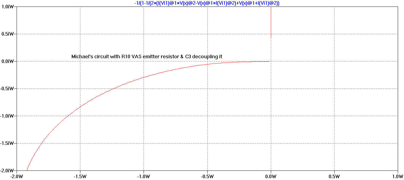

I now count at least 4 people who have posted SPICE simulations of this useful property of VAS degeneration. Perhaps we are all cerebrally challenged and only you know how to use SPICE properly. You certainly seem to be the one that is most reliant on SPICE to the exclusion of 'real world' considerations.Further, I have demonstrated that your beloved TIS degeneration, recommended by Cherry supposedly to enhance major loop stability, is completely useless, and, in fact, merely degrades minor loop stabilty.

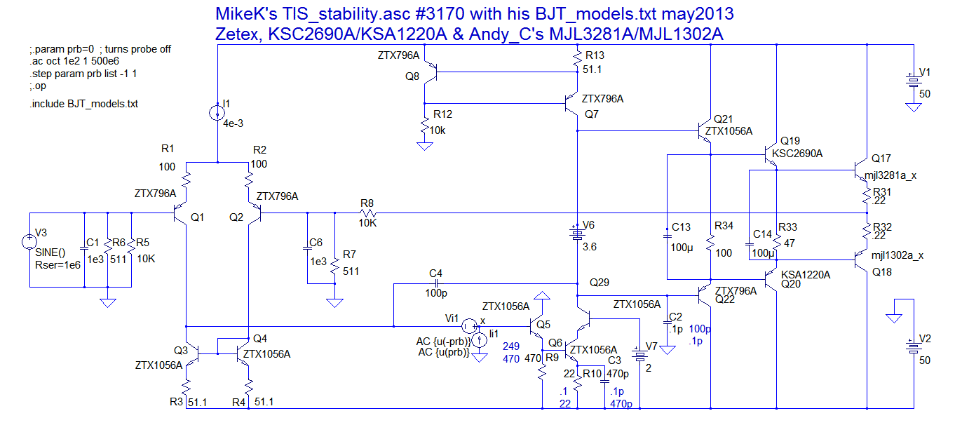

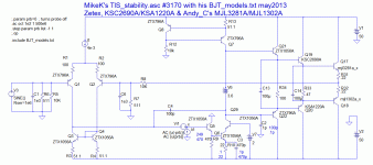

I did better than that. I used YOUR circuits & models that you posted in #3170 bob-cordells-power-amplifier-book-317.Have you actually tried to replicate or otherwise perform my simulations with the "correct" circuits and models of your choice? Hell No!![]()
I promised you and Bob the results but I didn't post them cos the example (like all of yours I've seen) had poor choices of currents & operating points such that stability & THD were marginal. Mea maxima culpa 😱

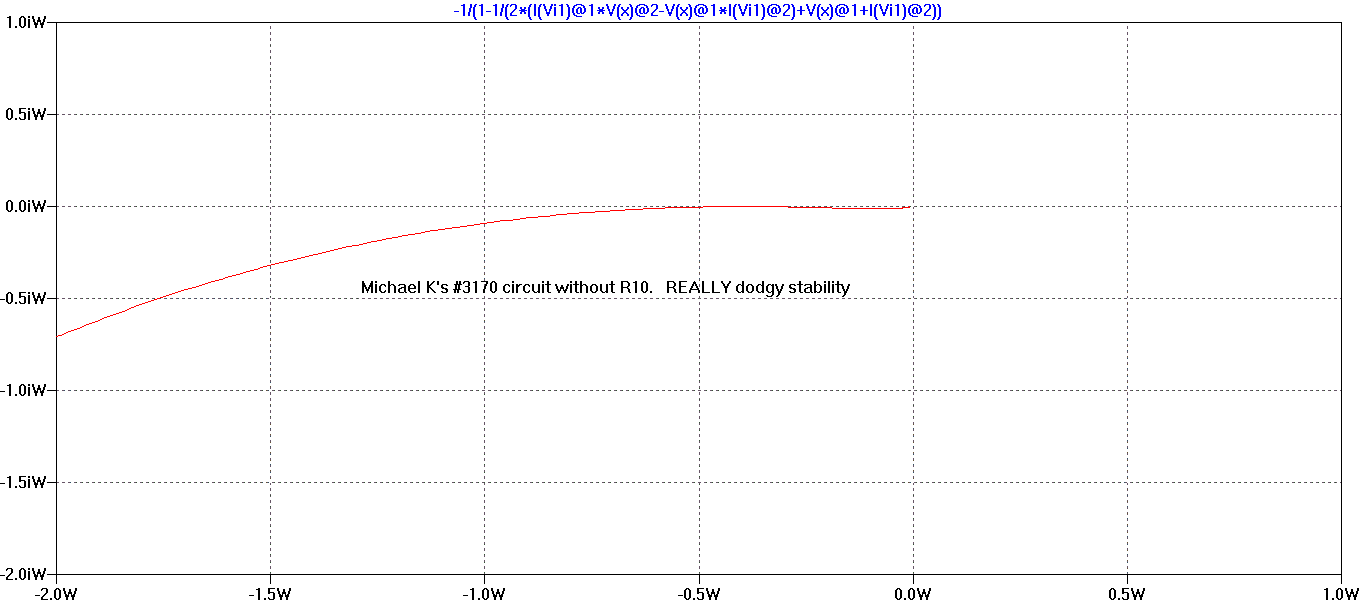

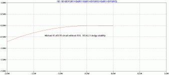

This is the Inner Loop.
You'll note without R10, the VAS emitter resistor, the stability is seriously wonky. Is this the case with ALL your designs? Adding the emitter resistor and my lucky decoupling cap C3, improves stability.
Should point out that the context was suggesting to Bob that decoupling the VAS emitter resistor was another useful string to the stability bow. Some of us are always on the lookout for new & better dodges to improve stuff ... rather than degrade stuff. BTW, the effect of VAS emitter resistor & judicious decoupling is apparently a 'Bode Step' to da pedants. I prefer to think of it as a kink to Nyquist.
I didn't do more work on this as your design (Unobtainium devices, no Zobels or output Inductor etc) would at best, be marginally stable with real loads and have poor distortion. It's performance is easily beaten by a much simpler, more stable, 'real life' circuit using my favourite 'pure Cherry' or even lesser compensation methods. 🙂
I just ran your sim. and found that Michael does have a point.
If R10 is simply increased from 0.1 to 22 ohms then the stability does deteriorate.
Of course the increased value of R10 does allow freedom to increase C3.
But it does appear that the simple increase in R10 does destabilize that circuit with those models.

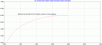

Ha! Guru Zan is a pedant 🙂Well, a Bode Step is a rather specific response function, not just any arbitrary kink.
OK, a Bode Step is an arbitrary kink in Nyquist that improves stability 😀
Please lobby LTspice to include dis fancy stuff. Den please Guru Zan, prepare da Idiot's guide to Nichol for us unwashed masses. 😕 I think some of the big $$$ SPICEs do dem.... find Nichols plots more convenient for this kind of work and I have started to think so too. You may want to try them.
Damn. Caught out by the Head Prefect. Dis was Michael's attempt to dis one of Bob Cordell's circuits.I just ran your sim. and found that Michael does have a point.
I wish Michael's models were better, now I have to decide whether to spend the time to determine if it is someone's error, a quirk, or more fundamental.
Yes. I knew but was hoping no one would notice 😉 I didn't keep my other sims of Michael's stuff cos they all gave awful THD & stability.
As I said, the original intention was to suggest yet another stability dodge to Bob.
