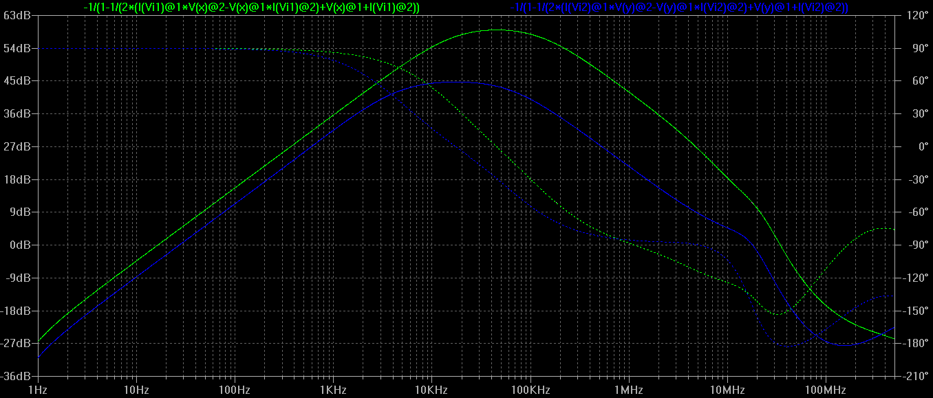

I use a Tian probe. I also tried the Middlebrook method (duplicate the schematic, etc...), to exactly the same results (as expected).
I can't be bothered to redo everything only for your convenience of rescaling. The results, as they are, are more than conclusive.
Hi Waly,
I have run the simulation again with your inordinately large value of 100ohms instead of my 22ohms and I've found that the phase shift at unity minor loop gain frequency without the 100R resistor is 153 degrees (green trace), and with the 100R resistor in situ the phase shift is 145 degrees. A slight improvement, but an improvement nevertheless.
It would appear an excessively large value of TIS degeneration resistor is required to reduce the minor loop transmission significantly so as to effect a marginal improvement in phase margin.
![scratch2 :scratch2: :scratch2:](https://files.diyaudio.com/forums/images/smilies/scratch2.gif)
Certainly, with the more usual 22R resistor there is no such improvement in stability margins.
Note that the Middlebrook method you refer to gives errors at HF. Also see attachment below for my derivation of that particular method.

The TIS degeneration resitor if used should be bypassed with at least 1nF capacitor to prevent it from adversely affecting minor loop stability margins.
If larger can one have the best of both worlds ? For example if 1 uf would it coincide with the area which the book illustrates that distortion rises . I recommended to a friend 27 R + 1 uF for him to simulate . This was for a secondary reason as I fell it suits the LTP current mirror better as it raises the VAS Vbe a little ( about 0.2V at 8 mA ) . The Vbe can be as low as 0.55 V which is very close to the saturation voltage of the mirror if including swamping resistors .
I can see if the stability is better with lets say 100 R a capacitor might make it worse . Worst of all worlds perhaps ?
