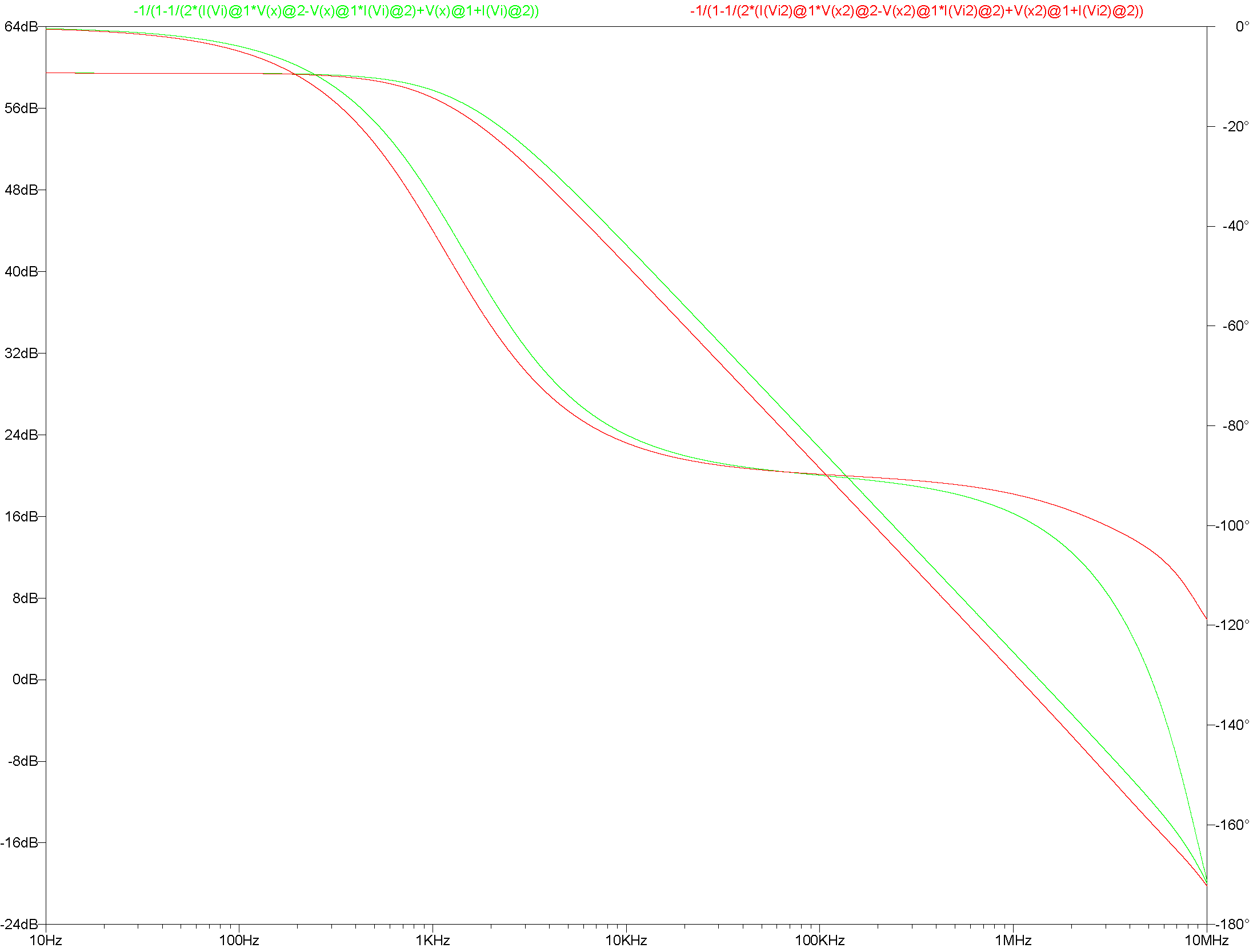

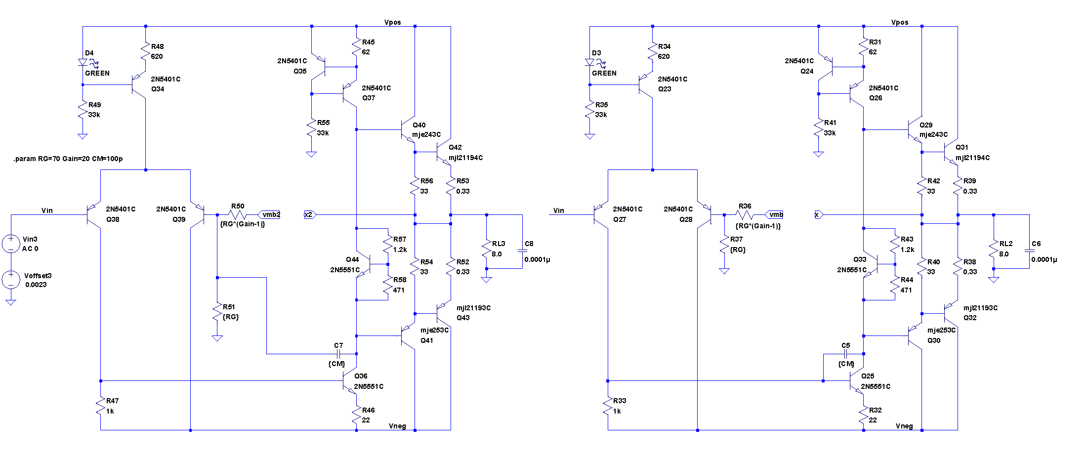

Micheal,
I take it this is not what you are taking about?
I've kept the compensation capacitor the same and adjusted the feedback resistors equivalent resistance to give nearly equal loop gain.
Green is around the vas, red is returned to negative input.
Circuit was borrowed from Bob Cordell's web site (and it should be close to original form), thanks.
-Antonio
Cascode the second stage so that its base-collector intrinsic capacitor does not affect the results. Also, shunt the input to ground with a large cap., viz. eliminate the voltage sources at the input, and do not alter the feedback resistors from one iteration to the next. Loading the output is not really necessary in this case. Make sure it is the major loop gain you are simulating in fact.

Simulation used a compensation capacitor of 100pF but can add the cascode or remove the parasitic capacitance if you really think its a significant detail.Cascode the second stage so that its base-collector intrinsic capacitor does not affect the results.
You want me to replace ideal sources with a large cap ?Also, shunt the input to ground with a large cap., viz. eliminate the voltage sources at the input.
I didnt, both circuits have the same resistors. I set the values to have both loops nearly equal, with input compensation the feedback resistors set the crossover frequency (no loading intended).do not alter the feedback resistors from one iteration to the next. Loading the output is not really necessary in this case.
Likely the issue of miscommunication, where exactly would you like me to measure your major loop (and with what conditions left on the global loop)?Make sure it is the major loop gain you are simulating in fact.
-Antonio
