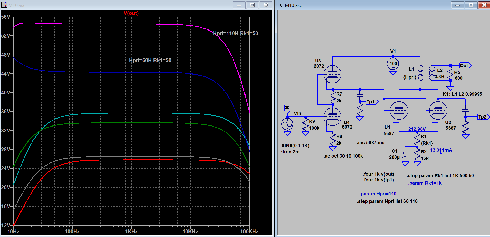

Effective supply of the 5687 is about halve of 300V 🙁
Even worse!😀

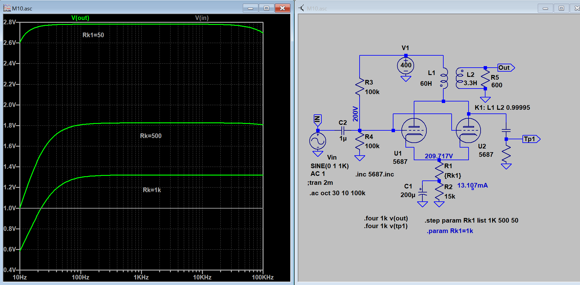

Could you elaborate a bit more on the voltage gain of the 5687 stage?
I understand that the gain is lowered because of the unbypassed 1k cathode resistor, but by how much? (I am not good in interpreting sims...)
A gain of 1.4 (25:18???) seems very little.
Here is the linear plot, the level on left hand side scale divide by the input (1V) is the gain. i.e. from top 2.7, 1.8, 1.35 with Rk1 55, 500, 1k respectively. This is based when the primary reflected impedance is about 10k with 60H primary, and voltage step down ratio: sqrt(60/3.3)~=4.6 (inductance H ratio is same as impedance Z ratio)
That is the voltage at the plate is divided by step down ratio, the gain is lost.
Your points are well taken, but it is what it is... AN designed it that way.It only says step-down ratio. If that is turn step down then it's no good. Nothing tedious. With just 300V supply and limited inductance it cannot be HiFi for general use. A HiFi preamp is supposed to give typically at least 2-3 V RMS with THD of 0.1-0.2% or less from 20Hz to 20KHz. That's the minimum! This is not going to be the case if 33:1 is the turn ratio and run the tube at 10 mA.

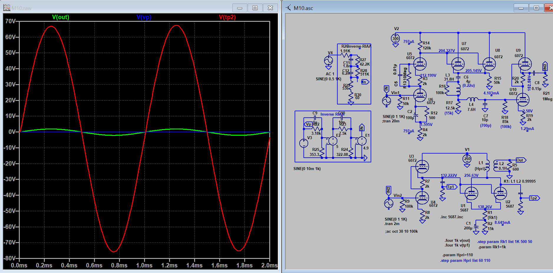

As I see it now, the output stage (that is 6072 SRPP cascaded into 5687) before the output transformer has a gain of 20 x 5.6 = 112. 5.6 is your simmed 1.31V x 4.26 (winding ratio of 60H:3.3H = 4.26).
With the 33:1 winding ratio as per Audio Note's specification, with 1V input of the complete output stage, the output voltage will be 112:33 = some 3.4 V. Actually a bit higher because the gain of the 5687 will be higher with the higher load impedance presented by the 33:1 transformer.
Critical point remains the grid voltage of the 5687; the tube will distort with 20V on its grids.
Besides it will not be able to produce an anode voltage of 112V.
So IMO the output stage design has serious weaknesses.
Could you sim the complete output stage and see what happens?

Yes I see that the grid can't swing as far when the plate inductance is very high, distortion set in well below 20V.
Here SRPP stage included (gain=20) and 2 primary inductance are used for comparison. Highest gain is about 55 when pri inductance is 110H and Rk1 50 ohms.

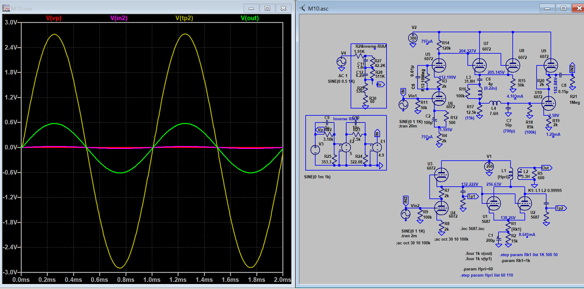

Here is sim included the riaa unit, psu not included. Some values are adjusted maybe to tube model in use. Those interested can sim PSU as an exercise.

Now to use step down ratio of 33:1, we assume that the pri inductance is 110H, and sec inductance is 0.1H, correct? so here go the sim (hope it does not hurt any one feeling), a sim is sim.

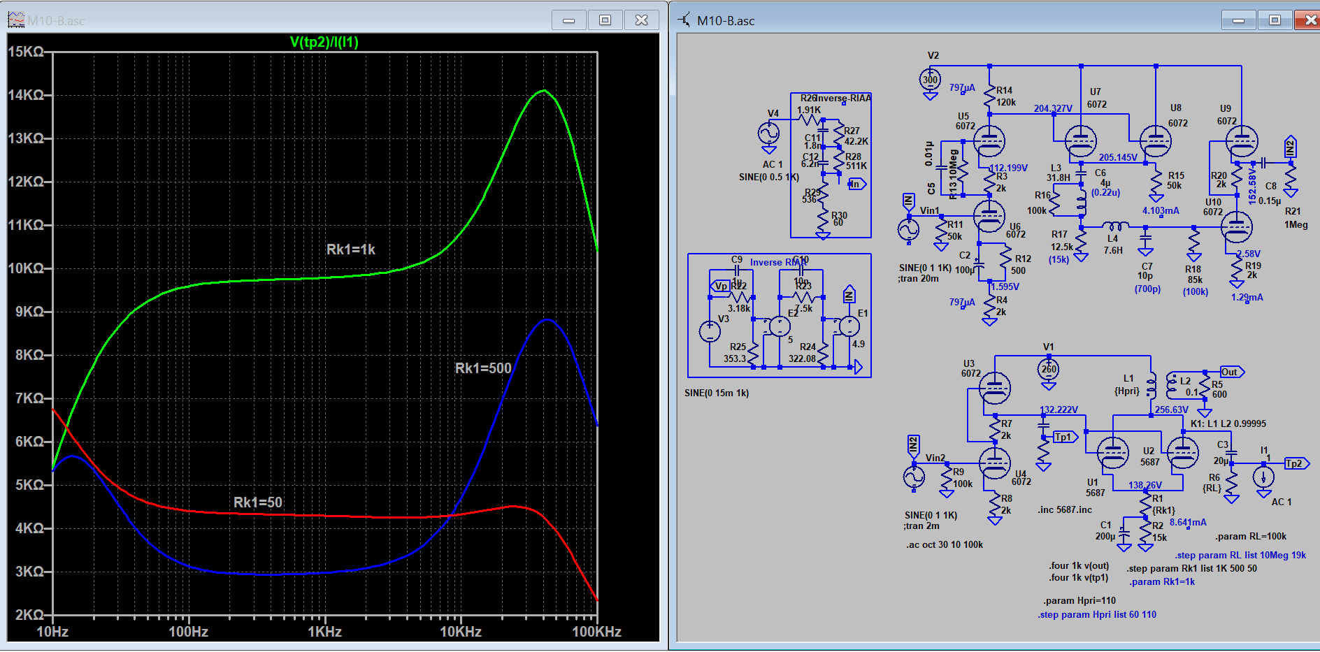

Some people have asked with is the output impedance of M10 twin 5687 output stage, here is sim result. The dip in impedance in bottom end may explain the lack of bottom end freq response. This is overall output impedance for T=33:1 step down transformer reflected impedance and tubes output impedance.
There is an error in M10.asc I posted earlier: C5/0.01u near U5 should be bypassed to ground instead, thank you.
I am not able to make much of this 🙁
What is the output impedance of this thing measured at the output?
