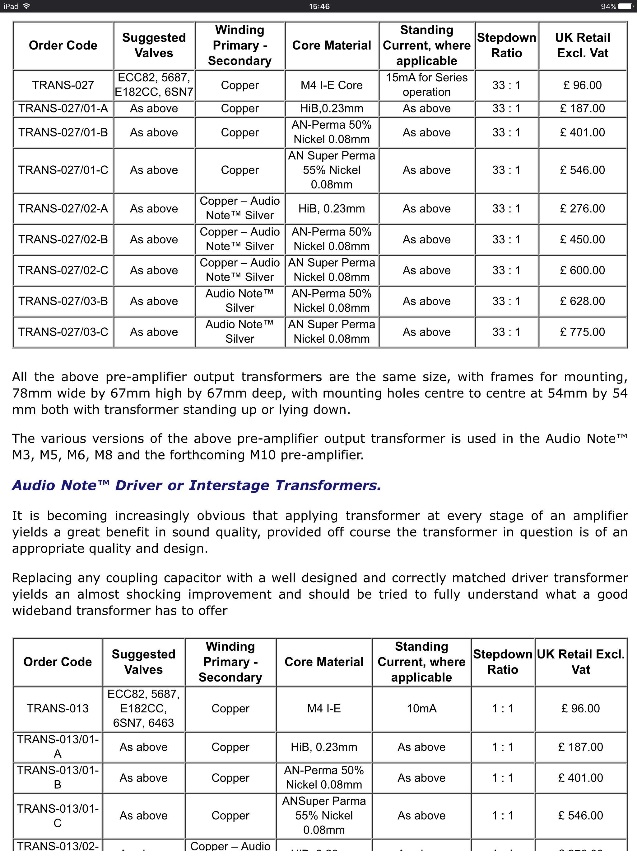

The output voltge will depend on the primary inductance. If you want 3V rms output with 33:1 turn step-down ratio, 10 mA anode current and reasonably low distortion down to 20Hz you need at least 250-300H regardeless of what it is implemented up-stream the output stage. It has nothing to do with frequency response or gain.

I don't believe there is 33:1 turn ratio. 110H primary inductance is measured by someone using LCR 200H meter, most people has trouble reaching 40H. I just realise that schematic design may have further reduce the bottom end response as posted

Then if you say that the declared output voltage of the M10 is 3V rms I really doubt the TURN ratio is 33:1. I said at the beginining this more likely the impedance ratio otherwise, without taking losses into account, the 5687 should provide AT LEAST 99V rms at the primary which is simply impossible with 300V supply....

Then if you say that the declared output voltage of the M10 is 3V rms I really doubt the TURN ratio is 33:1. I said at the beginining this more likely the impedance ratio because, without taking losses into account, the 5687 should already provide 99V rms at the primary which is simply impossible with 300V supply....
Do you agree that the unloaded gain of the output stage (6072 SRPP cascaded to 5687) is more than 300?
When 33:1 is the impedance ratio, so 5.7:1 winding/voltage ratio, what to do with the enormous output voltage??

The output stage has almost unity gain, (25/18 =1.4 in sim I posted) and 6072 about 20, 1.4*20=~30.
It only says step-down ratio. If that is turn step down then it's no good. Nothing tedious. With just 300V supply and limited inductance it cannot be HiFi for general use. A HiFi preamp is supposed to give typically at least 2-3 V RMS with THD of 0.1-0.2% or less from 20Hz to 20KHz. That's the minimum! This is not going to be the case if 33:1 is the turn ratio and run the tube at 10 mA.

With just 300V supply and limited inductance it cannot be HiFi for general use. A HiFi preamp is supposed to give typically at least 2-3 V RMS with THD of 0.1-0.2% or less. That is not going to be the case if 33:1 is the turn ratio and run the tube at 10 mA.
Effective supply of the 5687 is about halve of 300V 🙁
