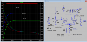

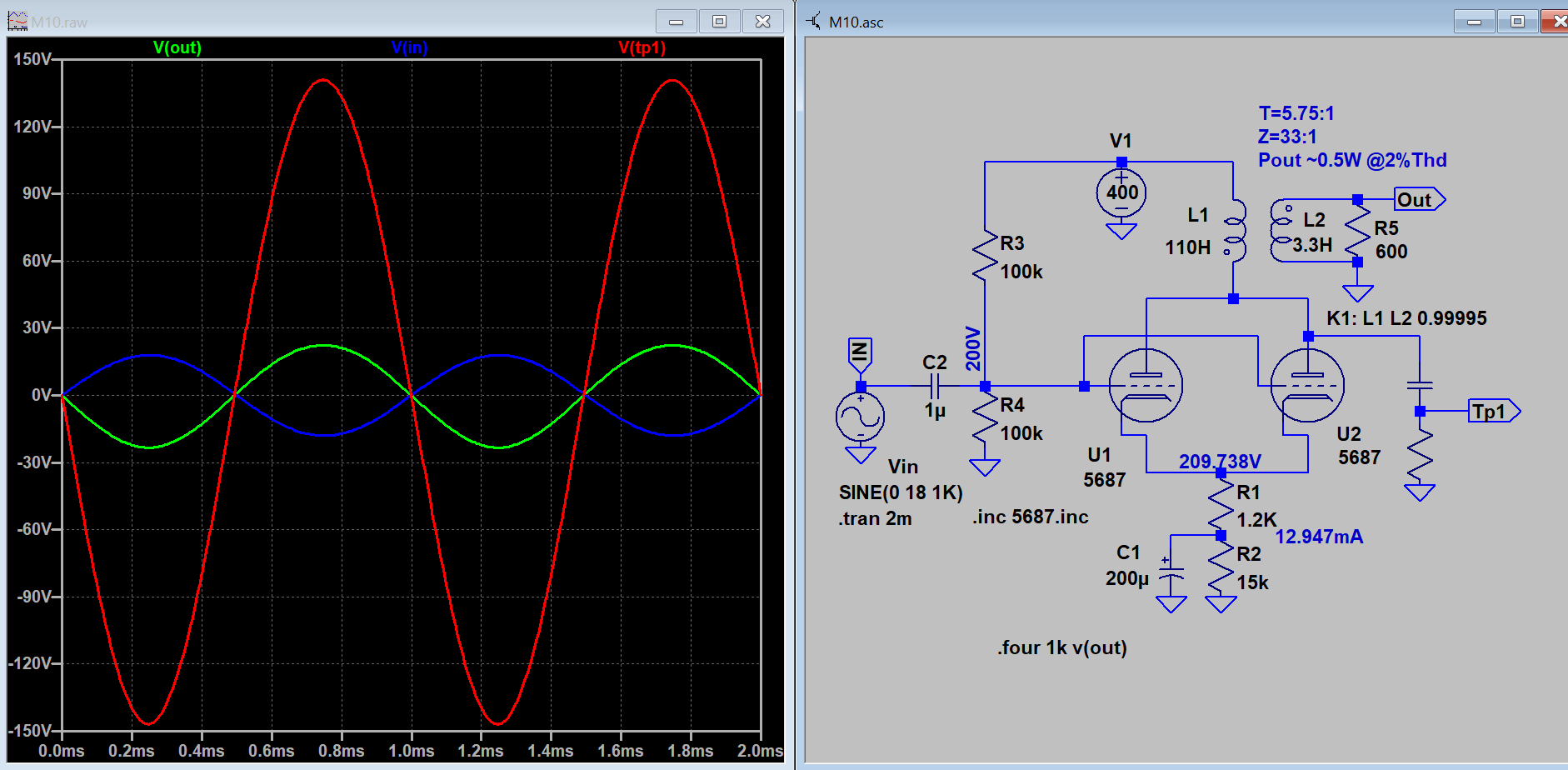

Any help with the sim?
T=5.75:1
Z=33:1
Pout ~0.5W @2%Thd
That's over 17V rms into 600R. Are you really going to drive a power amp that is that bad?
Your result is also high distortion because you run each triode of the 5687 at 6.5 mA only....not really linear. The primary swing for 0.5W output is about 280V peak-to-peak.

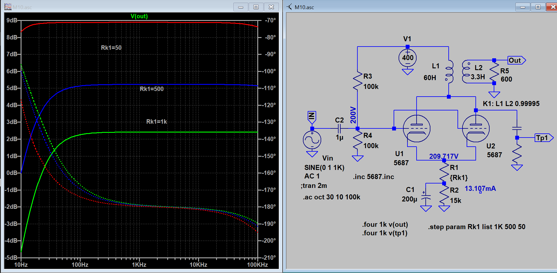

The output transformer is 33:1 turns ratio, which seems OK as the gain of the line amplifier (6072 SRPP cascaded to paralelled 5687) is more than 300.
Checking the schematic, loading the output stage with 600 ohm is optional .
Source impedance for the output transformer is some 1 k (parallel 5687).
Loading with 600 ohm or not, a primary inductance of some 40 H would have been sufficient.

There is no need to run simulations. The max primary voltage (sinusoidal regime) a tube running at 10 mA can give into 40 and 60H is 4.44*L*Idc*f. So this is 35.5 and 53.3 V rms, respectively. However this is the absolute max and will be affected by a lot of distortion because the tube is not really linear over the whole range. Then step-down by 33:1 and you get 1.07 and 1.61 V rms, respectively. In practice it is even less because of losses!
