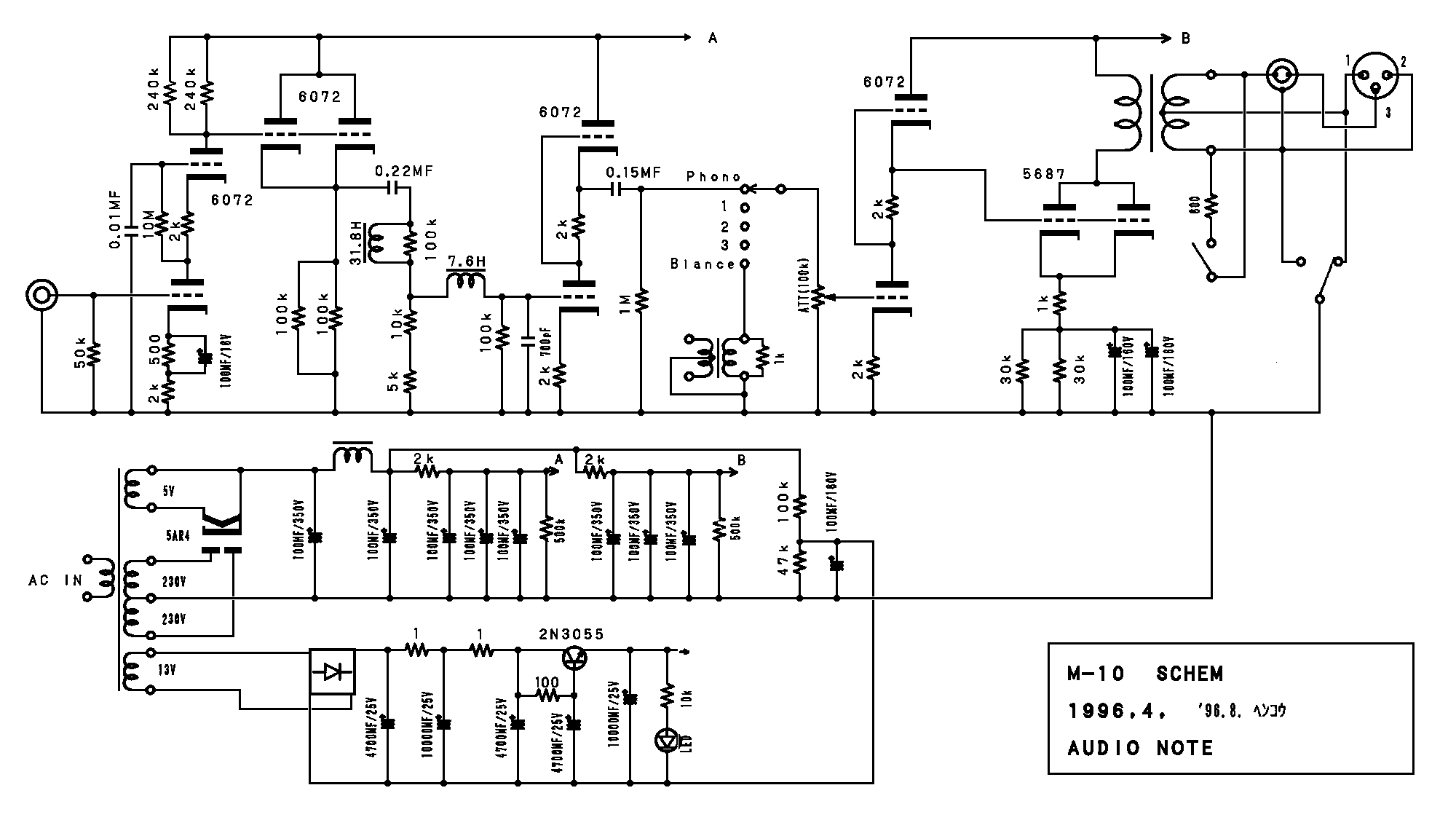

Some remarks if you want to copy the complete design:
- phono stage gain is 36 dB (x 63);
- with 5 mV phono input, output signal of phono stage is 315 mV;
- you need at least 20 dB (10x) of gain in the output stage to drive power amplifiers;
- the 6072 SRPP/5687 will provide you with the necessary gain, but there are problems with input signal to the 5687 grids, the high anode AC voltage of the 5687, and last but not least the output transformer;
- better skip the 6072 SRPP in the output stage;
- there are several options for a better output stage: for example single tube like E810F, 6C45, D3a with 5:1 step down output transformer. Or, if you prefer to use 5687, use one halve for voltage gain and direct couple it to the other halve being a cathode follower (can be done with output transformer, but a simple capacitor output might work equally well).

I haven't gone through all the posts in this thread so I don't know if anyone mentioned that the schematic in post#3 is from Audio Note JAPAN, aka, Kondo, before the divorce from Audio Note UK. Audio Note Japan cannot use the name Audio Note legally outside of Japan. Before the forming of the UK company, many circuits of ANJ were circulated in diy community, including the legendary Ongaku 211 amp. Some of these circuits were published in Sound Practices in the 90s. The posted M10 schematic is from Kondo Japan and has nothing to do with the circuit by Andy Grove of ANUK that bears the same name.

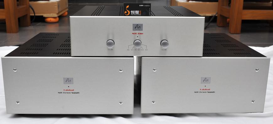

Audio Note JP ≠ Audio Note UK
Again, there are TWO different beasts of a preamp called M10. The orginal poster jerrylong posted a schematic of a M10 that was designed by Kondo in Japan, clearly dated in the schematic at 1996. Audio Note UK was formed after that and introduced a preamp that also happened to be called M10. Due to legal issue, Audio Note Japan later renamed the company as Kondo. The two preamps are designed by different people, by different companies. The British company is simply called Audio Note UK.
They are different preamps. ANJP uses 6072 & 5687 tubes and ANUK uses 12AU7 & 6463. Jerrylong needs to decide which preamp he wants to clone. He first posted the Japanese schematic and then jazbo8 posted a quote by Peter Qvortrup of ANUK about their M10 transformer. And then Jerrlong posted a discussion in a Chinese forum about ANUK M6 transformer. All of this only adds to the confusion.
You can go back talking about circuitry and transformers. All I'm saying is that the schematic posted is NOT related to the transformer Peter Qvortrup was talking about.
Please return to your regular programming.
Audio Note Japan (Kondo era) M10
Audio Note UK M10
M10 Line Signature
