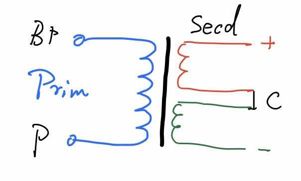

Sum up the discussion above:
1, forget about 33:1 turn ration(it's for AN_UK)
2, the parallels of 5687 made the impedance of OPT prim Z1=15K, and the second Z2=600R
3, Turn ratio N=(Z1/Z2)^1/2=5:1(for RCA output)=5:0.5+0.5(for XLR output)
3, The inductance of prim L1 will exceed 100H
4, The number of turns of prim N1=4511(with tested coil with 2855 has achieved conductance 41H)
5, The diameter of prim is 0.13
6, The number of turns of second N2=4511/5=902
7, The diameter of second is 0.25, with 4 wires paralleled
If these species are correct and I will design the arrangement of the prim and second

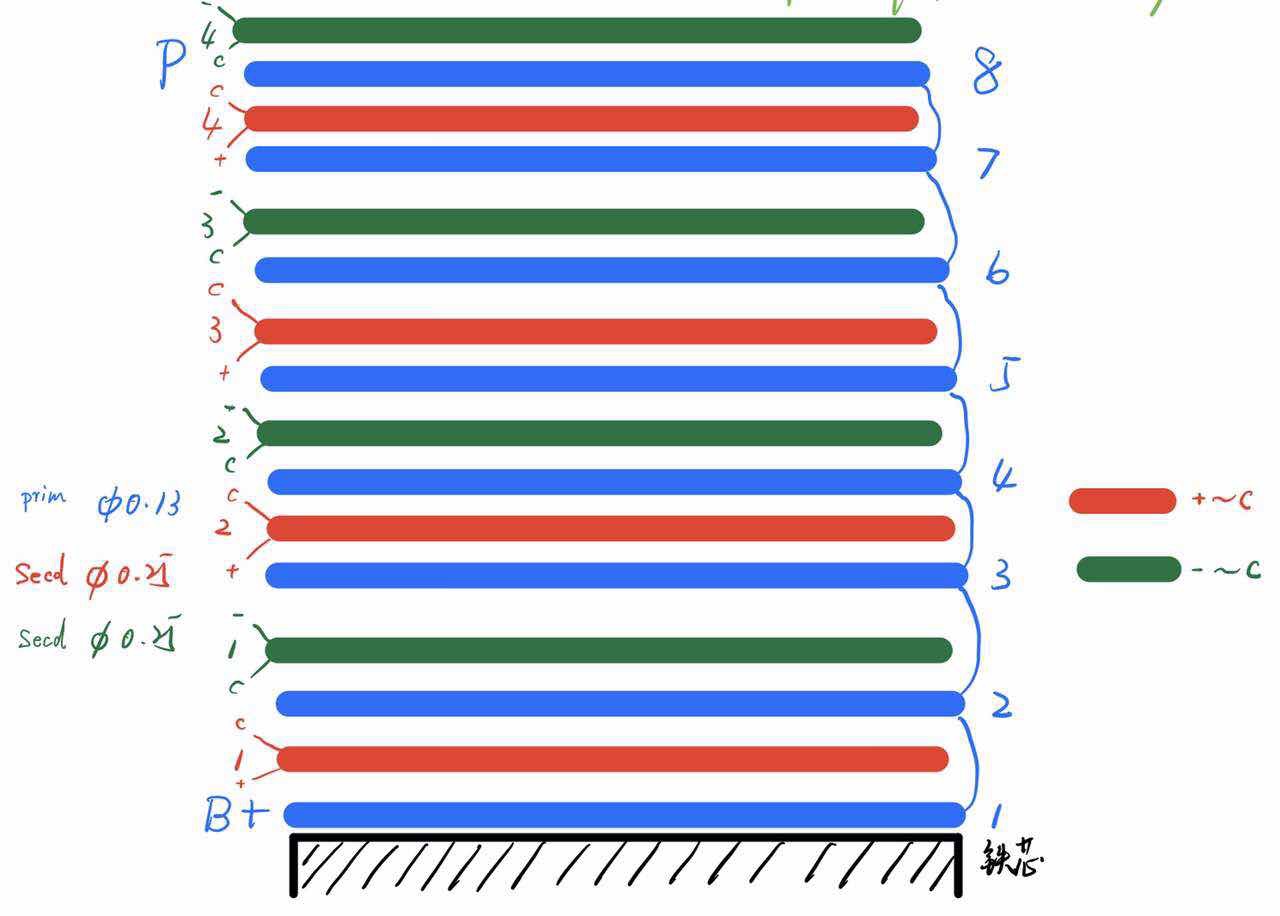

This is the coil arrangement I planed
8 layers of prim and 8 layers of second
Better if you do 9 primaries and 8 secondaries. The first and the last primaries will have 1/2 turns. That's symmetric. It's easy if the first and last primaries have, for example, 1 layer and those in the sandwich have 2 layers... or 2 and 4.....or 3 and 6 asnd so on....
Yours is not.....because it looks like the first primary has the same turns as one in the middle but is only coupled on one side. The last secondary has the same turns as one in the middle but is only coupled on one side.
