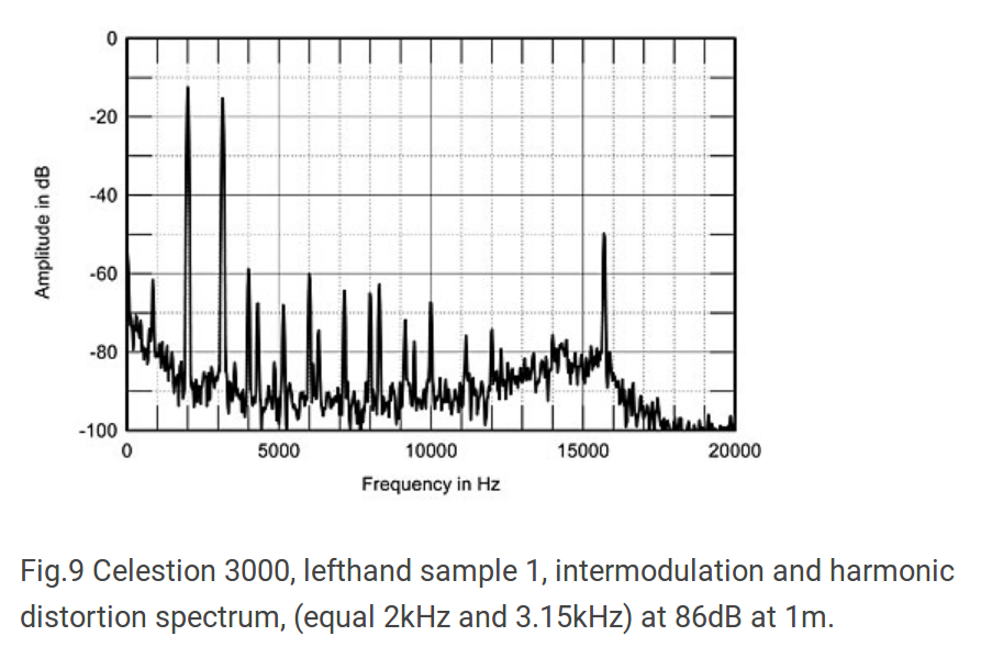

I suppose it might be that the THD figures are so poor that no manufacturer wants to bring attention to them. 😀
I'll try to find some online. If so, Pavel may need to up his distortion levels.
Of course, as with amplifiers, the type of distortion is important not just the totality.
From: Celestion 3000 loudspeaker Measurements | Stereophile.com

We should clear up the idea that there are "types" of nonlinear distortion, that THD is a different thing from IMD. They are not, both are symptoms of the same underlying system nonlinearity using special signals. They both derive from the exact same disease.
What is important is to understand how the various orders of the underlying nonlinearity are a factor, because that's where the truth lies. The higher the nonlinear order the greater its audibility will be. In terms of HD that means that the higher the harmonic the more audible the underlying system nonlinearity will be.
