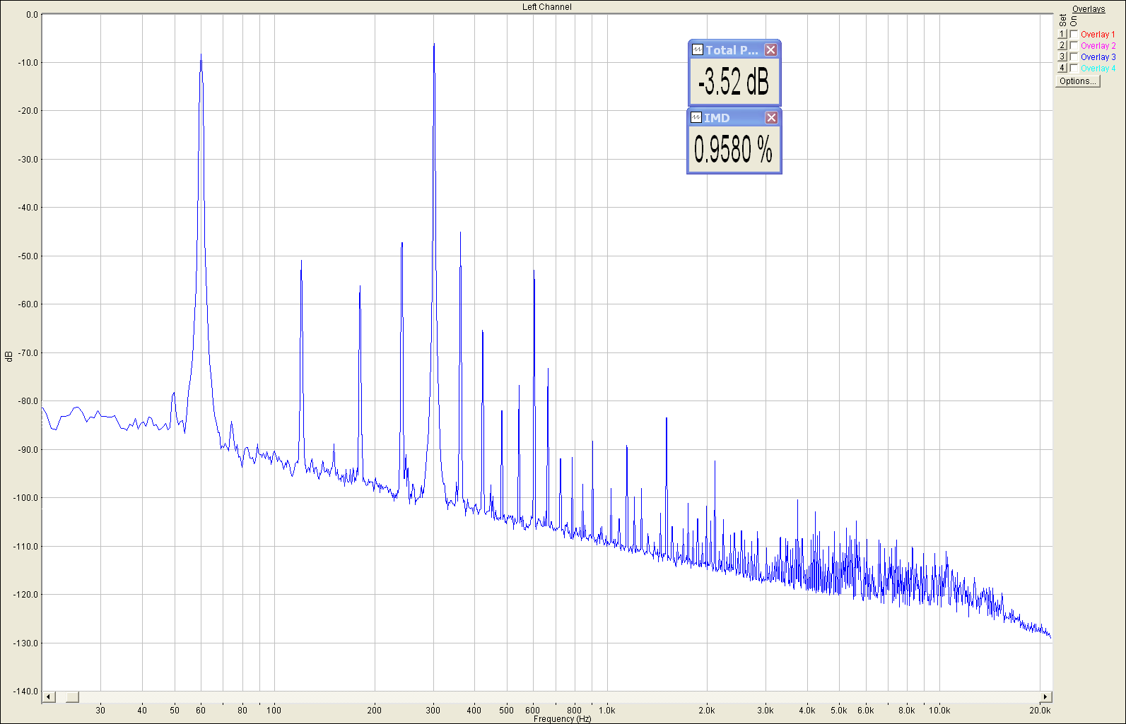

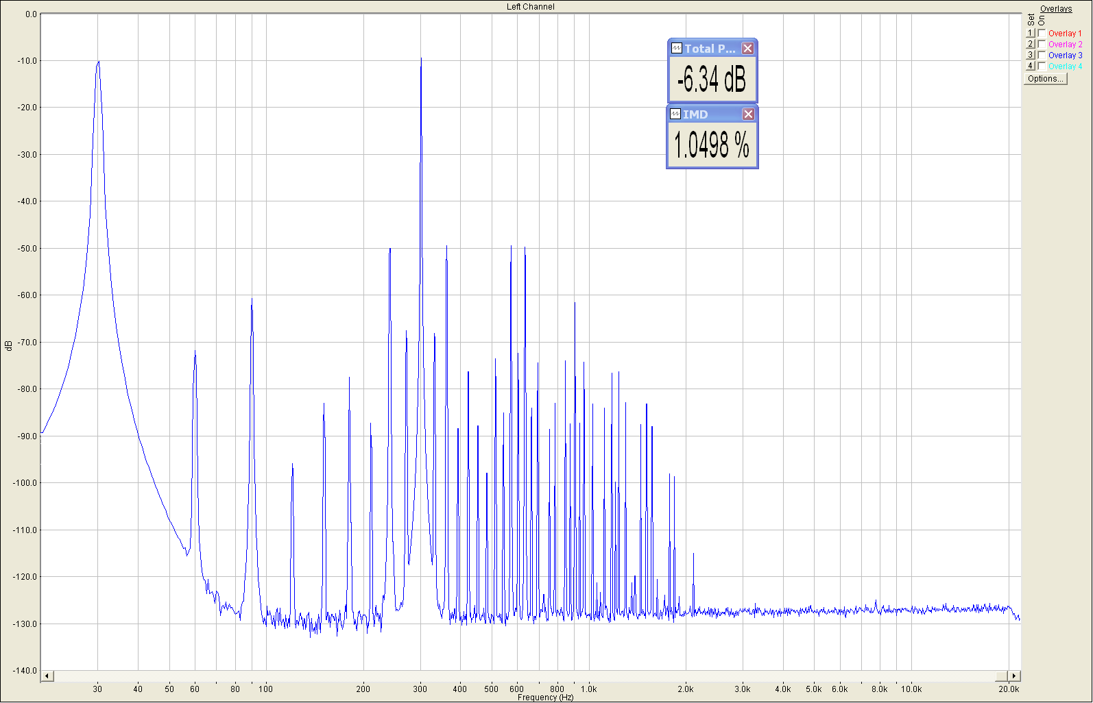

Great! So to discern real speaker IMD was more difficult for you than the simulated one. It is possible, as distortion of the real speaker was lower than that of the simulated one.
The high tones added seem stronger to me on the 30+300 test.
And, for me, the 60hz sine is more distracting than the 30hz.
I have done this test with MDR-V6 headphones.
This is absolutely correct. Please compare the spectra of 30+300Hz mathematically distorted file and 60+300Hz file recorded from the speaker. You will see that the 30+300 with math distortion has more and higher IMD components in the medium freq range, where the ear is most sensitive.

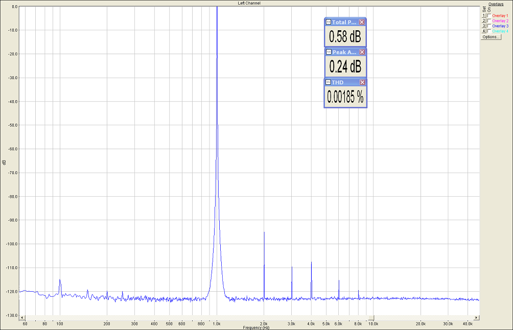

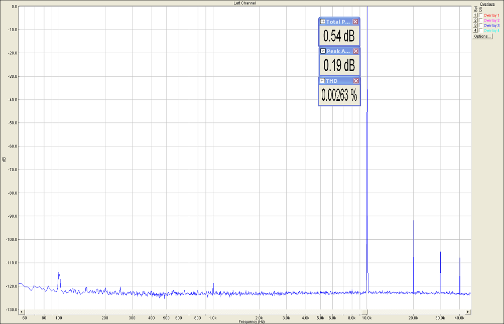

B - by measurements at speaker terminals, with the amp used in this test, I am below 0.002% of nonlinear distortion speaking about H2 and H3, higher harmonics negligible.
Re audibility, there was another test
Test your ears in my new ABX test
with much worse amplifier, the test was targeted on crossover distortion, and none of the participants was able to provide a positive ABX result when comparing a source file with the one recorded through path consisting of D/A, amplifier loaded with speakers and A/D. In case you are interested, please visit the linked thread. my apologies, I do not want to spend much time repeating everything that was already written. There were the tests not only with music, but with pure tones as well. As long as no one is able to give the proof of distinguishing any of the recorded files through the amp, I am not feeling like discussing the recording path.
4 ohm 32W 1kHz and 10kHz attached.
