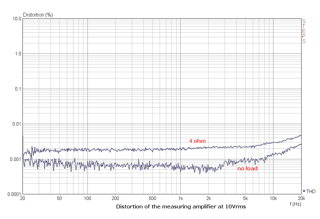

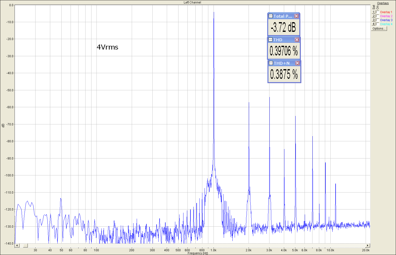

I do not think it makes much sense to argue without proof, so I decided to prepare some test signals to check audibility of speaker nonlinear distortion. With my setup, I am able to remove quite effectively the ambient noise of the room and also microphone path noise, so I am able to get high dynamic range even from the recorded signal. You will see it in attached plots. Distortion of the amplifier that feeds the speaker under test is very very low, as you can see from the attachment as well.
It is very difficult or rather impossible to prepare a valid test with music samples, this way, it means by recording at acoustical side. So I have prepared 3 sets of test files with sine frequencies. Every set contains a source digital file and a recorded file with ambient noise and microphone noise removed.
1kHz sine at 4Vrms

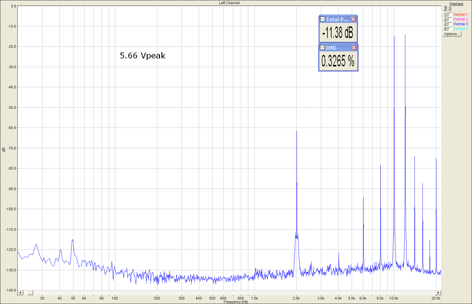

10kHz+12kHz twin tone IMD at 5.66Vpeak
http://pmacura.cz/speaker10+12k.zip
This is a test on intermodulation, be careful not to use very high gain, because the test signals are in the top octave of human audibility range.

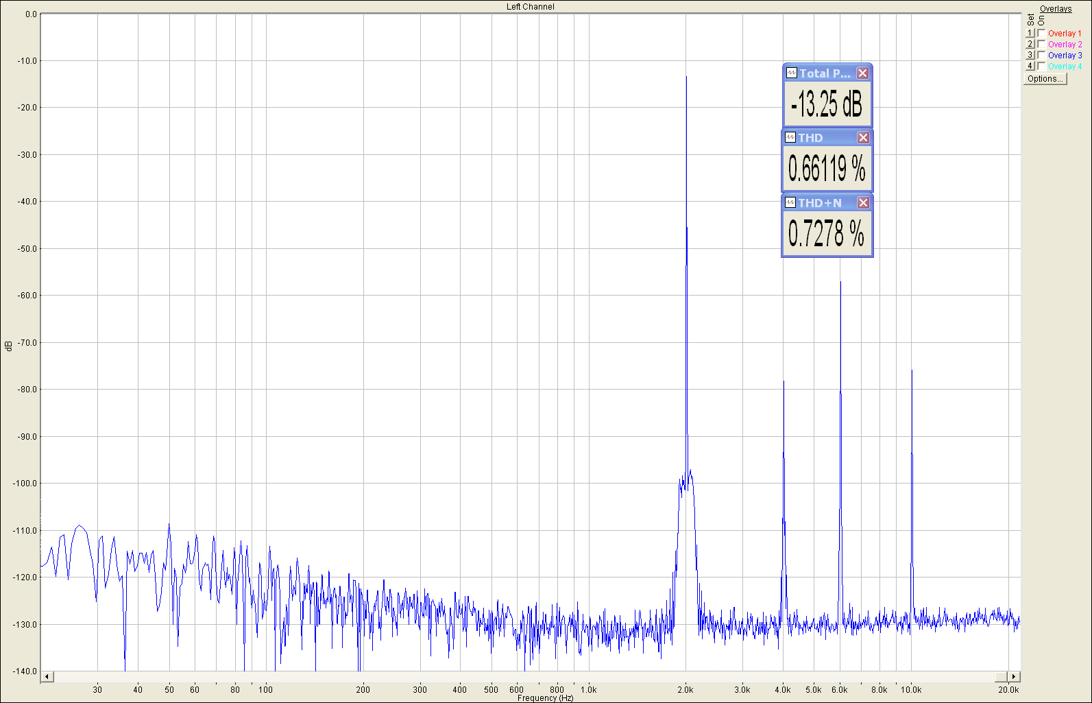

2kHz sine
http://pmacura.cz/speaker2k.zip
This was recorded 2 years ago and I believe that at 2.8Vrms, but I am not absolutely sure. However, the speaker under test has the highest level of distortion at about 2kHz, though distortion profile is different. That is the reason why this test was posted as well.

I was able to get a positive and repeatable result for the 1kHz and 10+12kHz tests. I have troubles with the 2kHz test. And how about you?
Attached are the spectra of the recorded files and amplifier THD vs. frequency plot.

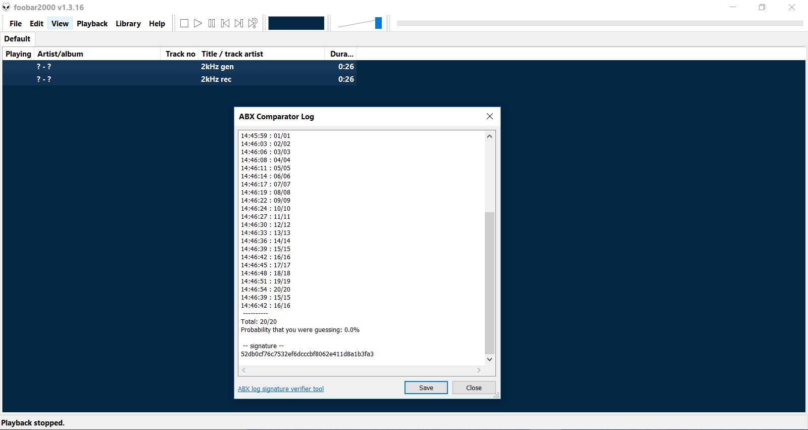

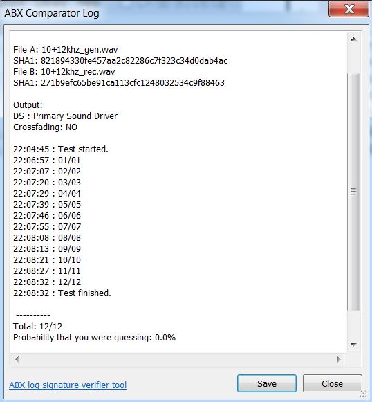

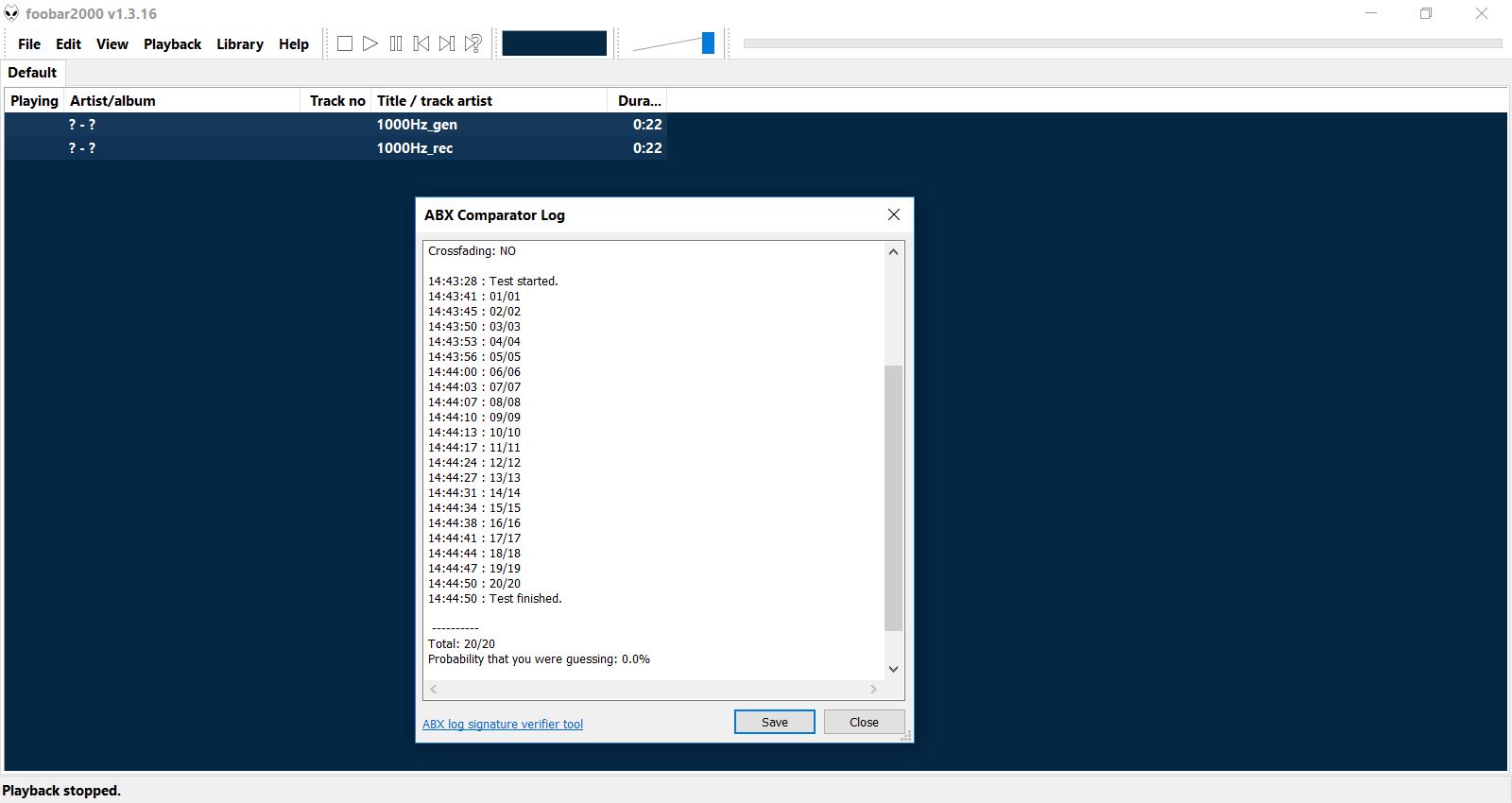

Interesting. OK, let me start the ball rolling, I had just one attempt at each file:
(Edit... if you look at the second image you will see there are 22 samples with 15 and 16 appearing twice. That is Foobar, not me ;))

Great result Karl, I think no need for you to torture your ears with further trials :D.

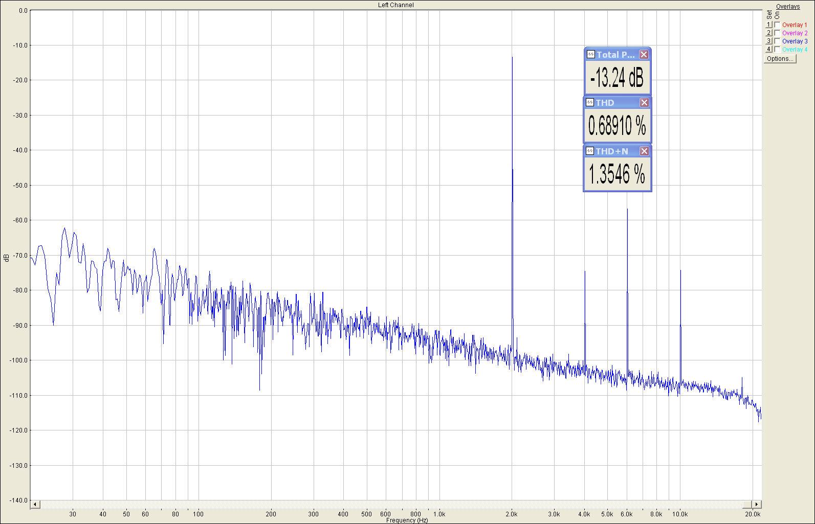

There has to be one reference and this reference is always the pure clean signal.
Removal of the ambient noise is the only chance, as you will never get 2 runs with same ambient noise. As Scott Wurcer likes to say, there are never 2 same runs from the one vinyl record. This test, with speaker in the room, is even worse for repeatability of the ambient noise. The noise removal does not change harmonic content, as you can see from plots with and without ambient noise - attached.
The 2kHz recording is 2 years old and is in 44.1, you are right. But it should not matter, because 2kHz reference is also 44.1. The necessary condition is that the reference and recording must be at same Fs and bit depth.

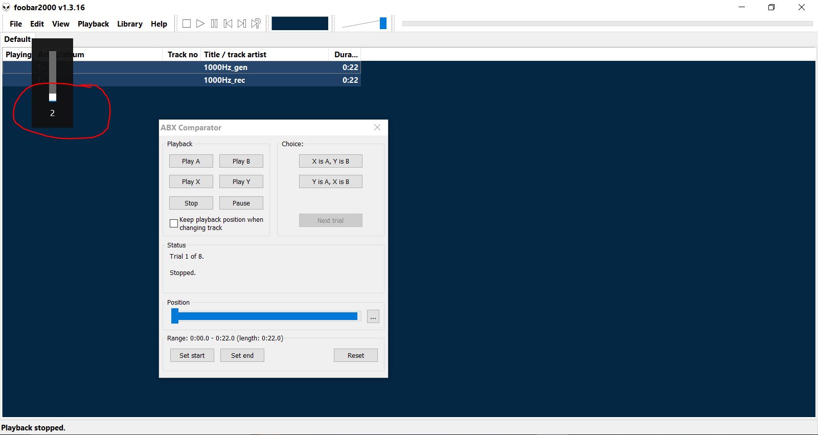

For the 1kHz test, try to play with volume. The generator file volume to be lowered until the limit of ear intrinsic distortion, must sound clean. Go to the limit until the ear starts to distort and remain just below. Then, the 1kHz recorded through speaker will have audible harmonics and 1kHz from generator will remain clean.
I found both the 1 and 2 kHz files are 100% distinguishable using just a volume level of '2' while the 11 + 12 kHz file needs a level of '4' to be 100% reliably differentiated. By way of comparison your Bach file was played at levels in the 60's and Marcel's files in the 40's.
