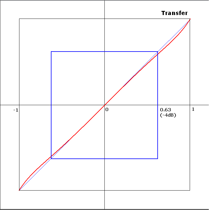

Thanks to all who posted the results on sine tones.

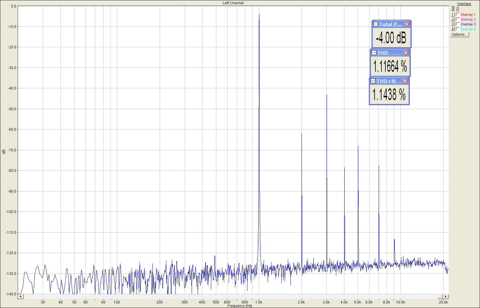

I have prepared a test with real music. Distortion has been added mathematically, which is always a pain, because in the real speaker the distortion depends on frequency and higher amplitude may excite further distortion, non-harmonic. Both I am unable to simulate.
The distortion profile used is attached and applies only for amplitudes as in the plot. For smaller amplitudes, distortion is decreased, which is similar to normal speaker.

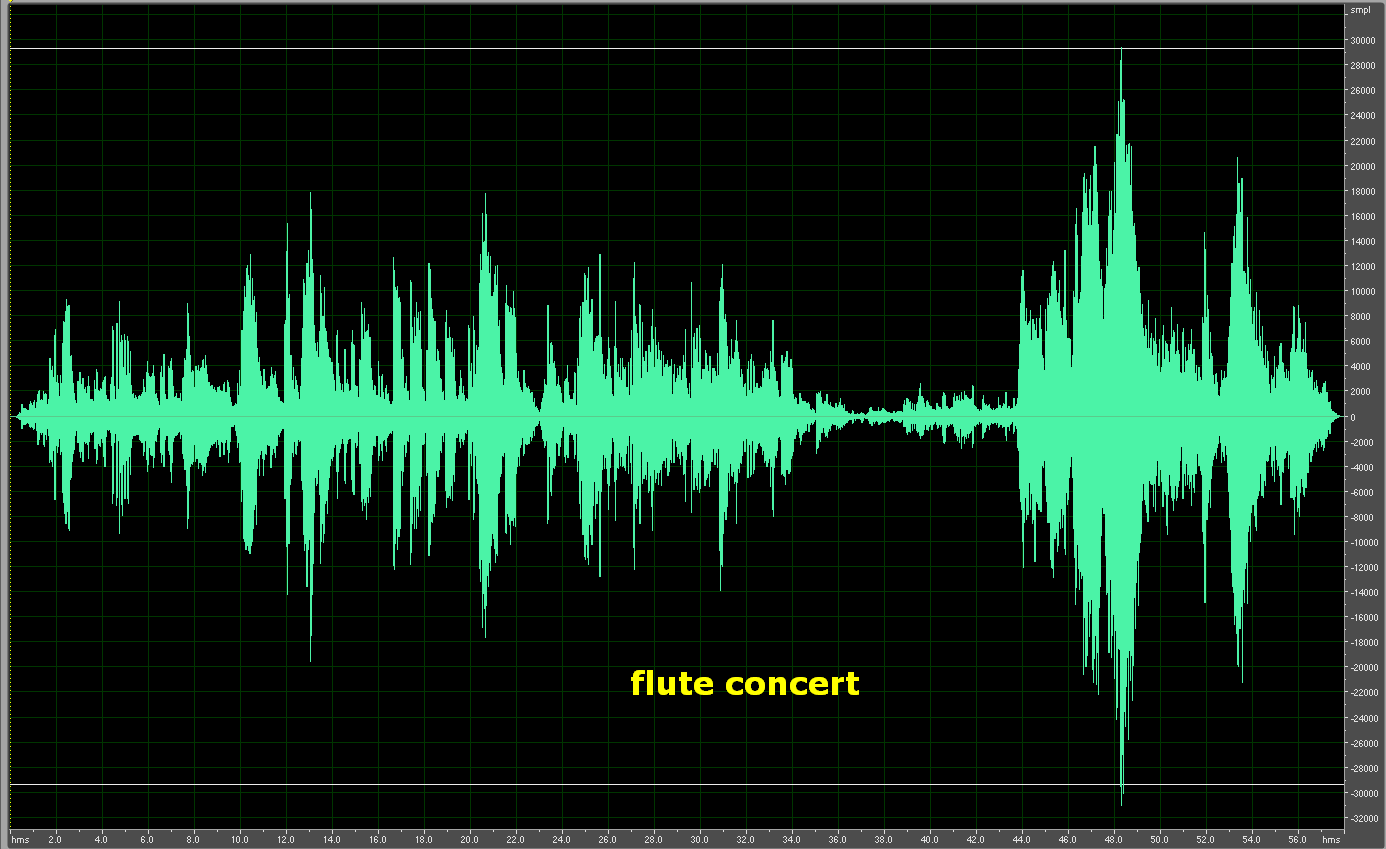

It is a flute concert and forte is in the second half of the sample.

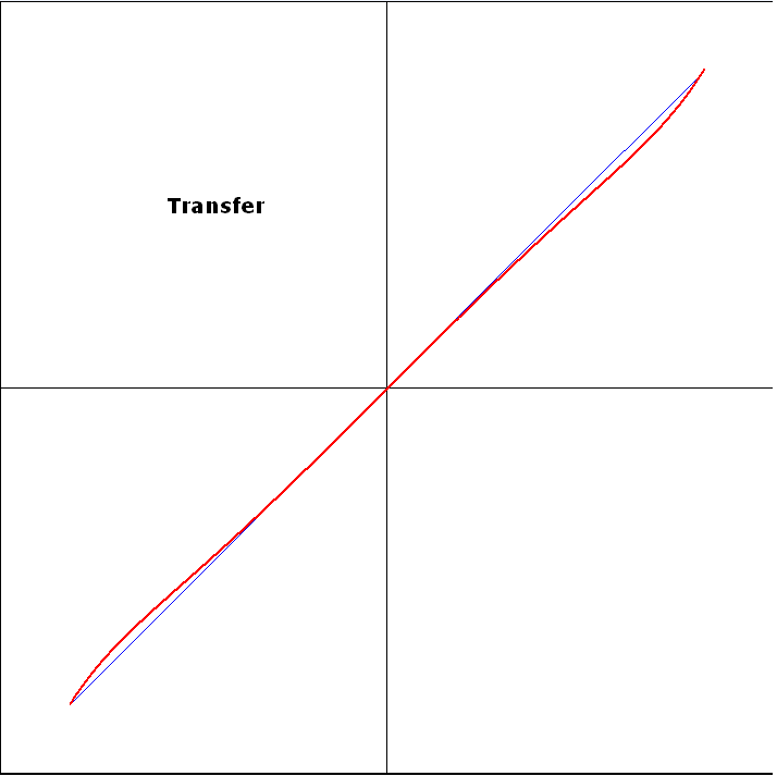

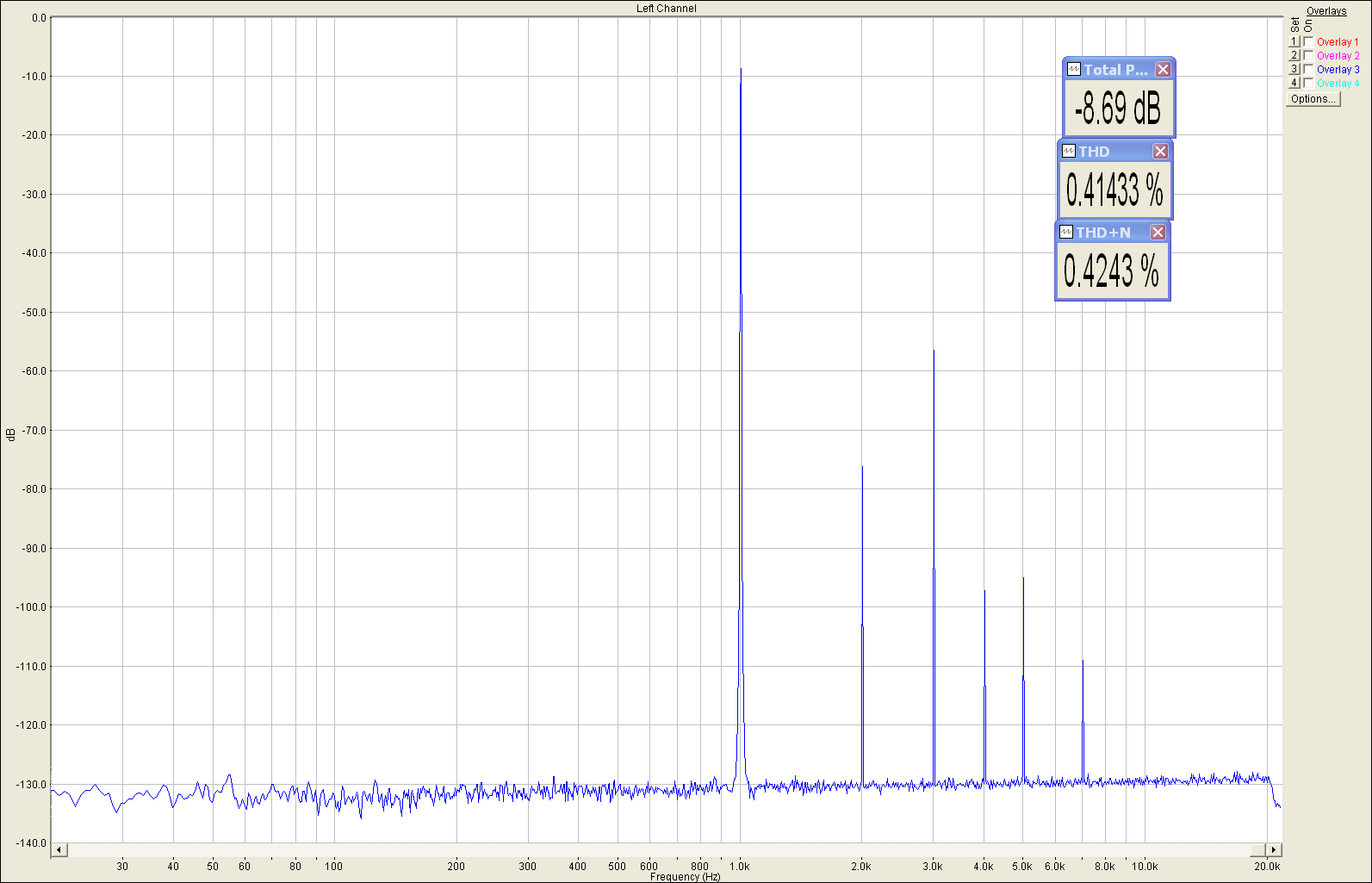

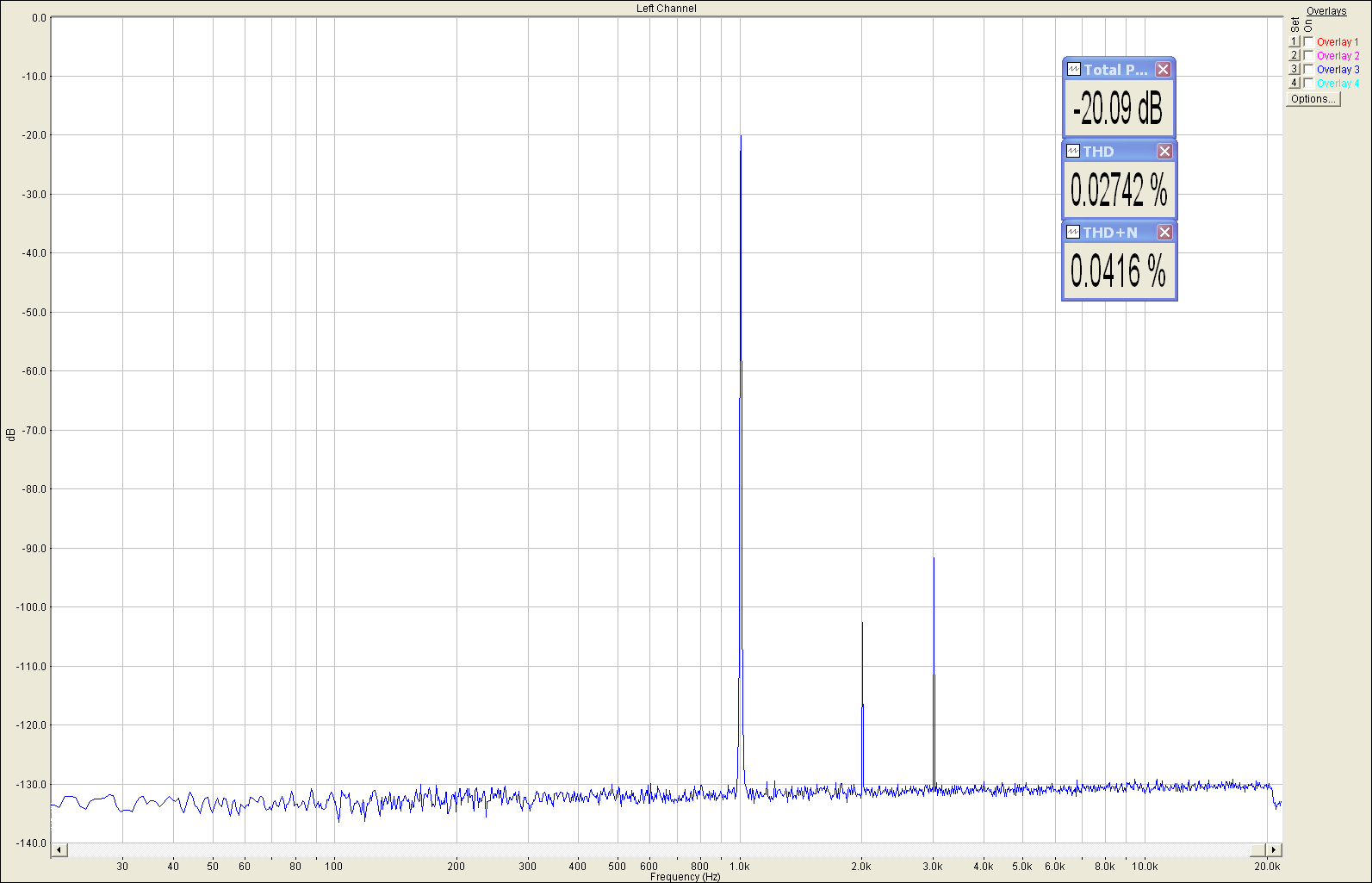

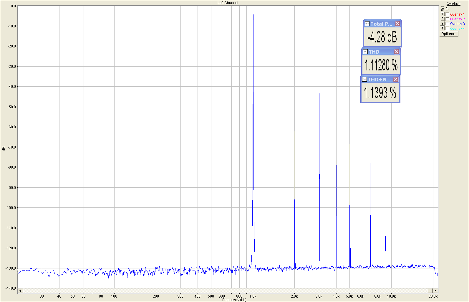

See how the distortion is fading away (esp. high order components) as the signal is decreased ....

You'll have to convince me there exist (serious) speakers that are expansive and compressive. Not to say there aren't any but how about monotonically decreasing non-linearities before the exotic stuff.
Well, this should settle the matter. Scott and Geddes and any others who dont seem to believe one can hear much of anything in the way of distortion. I would guess they have not spent much time critically listening.
Dick you should go to Burning Amp sometime, I'm sure you would be a big hit.
The test music sample amplitudes are in the decreasing portion of the nonlinearities, of the nonlinear transfer curve, as you have probably noticed in the post 45

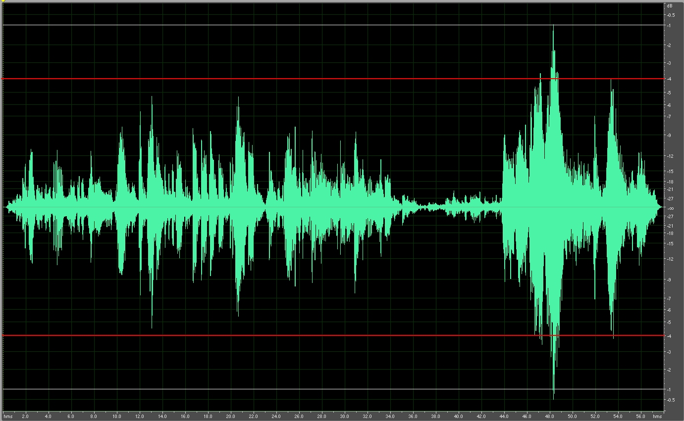

Almost the whole flute concert music sample has amplitude less than -4dBFS, except for one short drum passage near time of 48s, you can see it attached. The transfer function used in the test is definitely monotonically decreasing for amplitudes equal and smaller than -4dBFS. This can be seen from the transfer curve plot and also from harmonic distortion plots taken at amplitudes -4dBFS, -8dBFS and -20dBFS approx.
I was asking Mooly which part of the concert he was listening to in his ABX, and he answered that the flute part, so he was definitely well below -4dBFS, where the transfer curve nonlinearity is monotonically decreasing, as you are asking for.

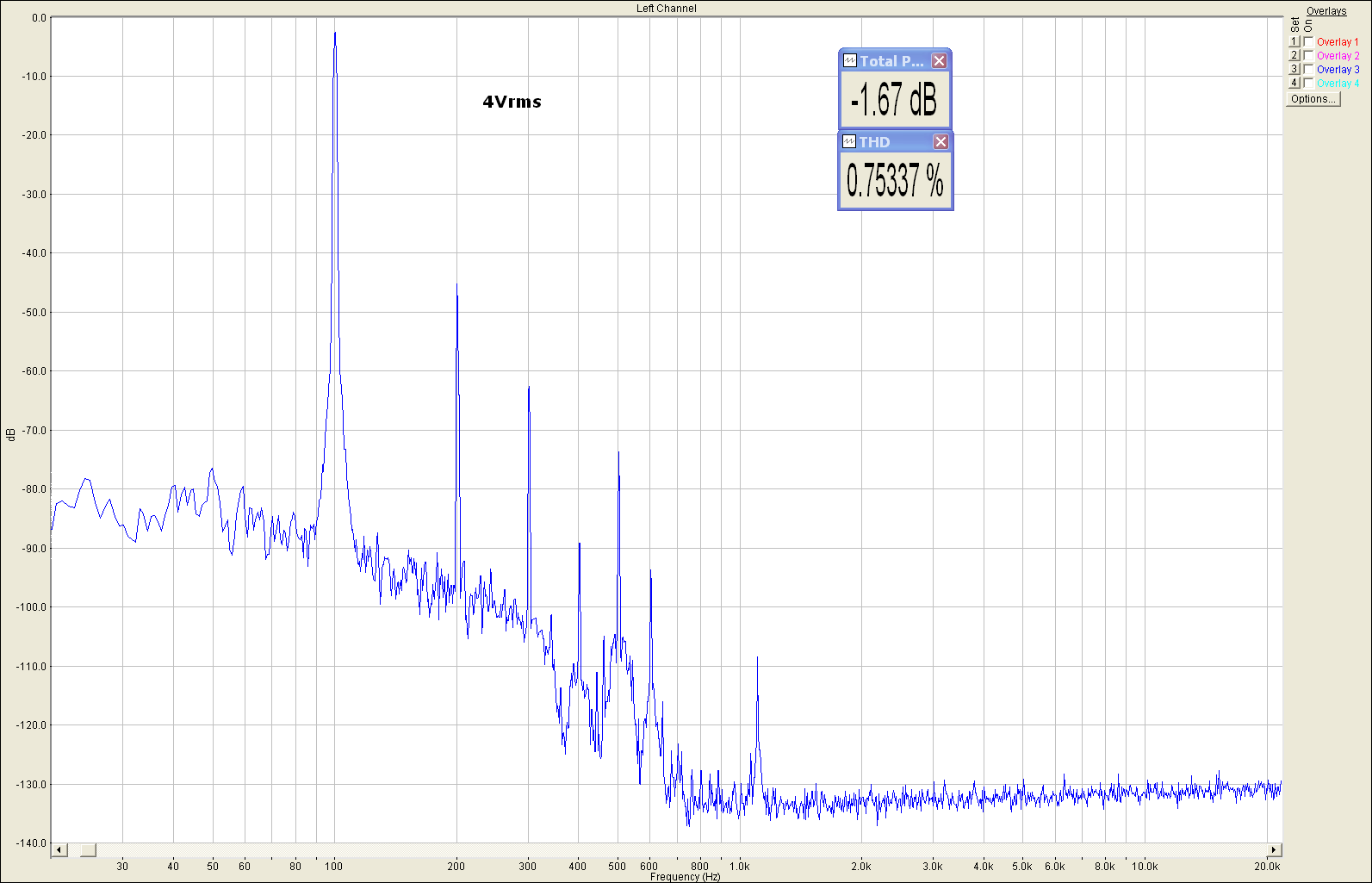

I agree that speaker distortion is highest at low frequencies up to 200Hz and I was fair enough not to put 50, 100 and 200Hz waves recorded from speakers to this test, though I have all of them measured and recorded. I am also sure you are aware of my measurements of speaker distortion comparing voltage drive and current drive.
Current drive of speakers and speaker distortion
The only reduction of distortion was found for a woofer in a closed box.
Unfortunately I am not able to simulate frequency dependent nonlinear transfer curve. So I took a midrange distortion as a basis for my experiment, which I consider fair. With hugely enlarged distortion from the woofer the result of the test might have been much worse, i.e. much more audible.
I do not feel like defending group X or group Y, I am just interested in explanations and understandings of our hearing.
Despite that, 100Hz test added, at 4Vrms.
http://pmacura.cz/speaker100.zip
I assume it would not be as easy as it might look like. Please do not use small PC speakers which would suppress the 100Hz frequency due to their LF roll-off.
