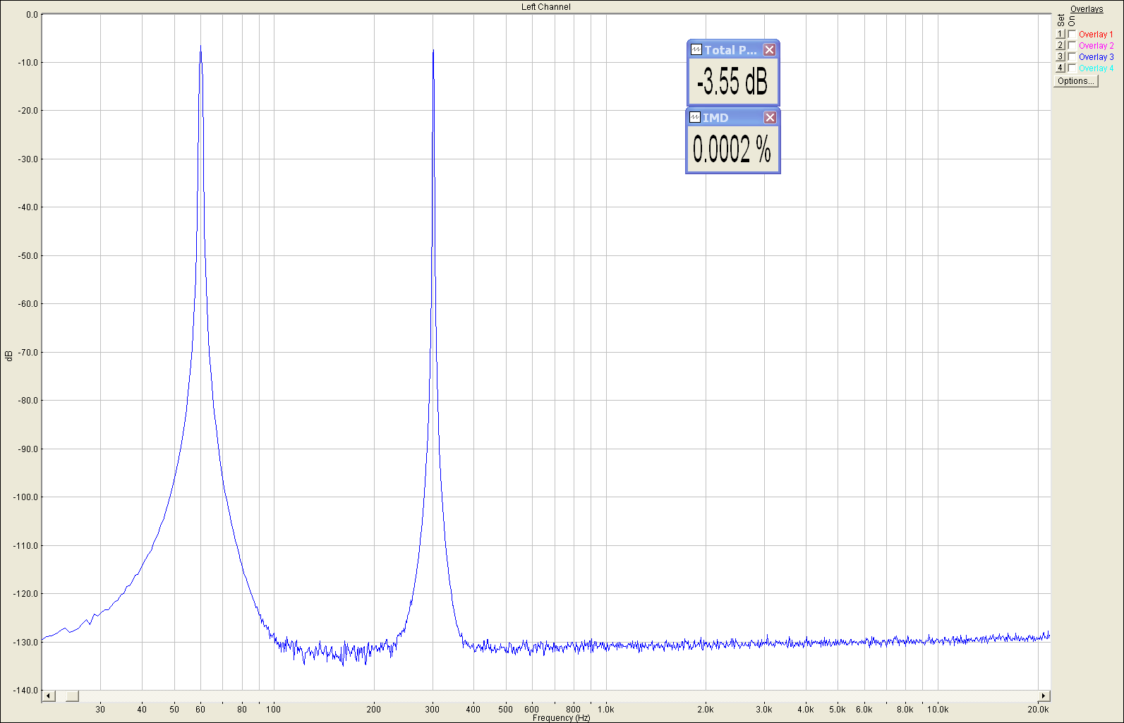

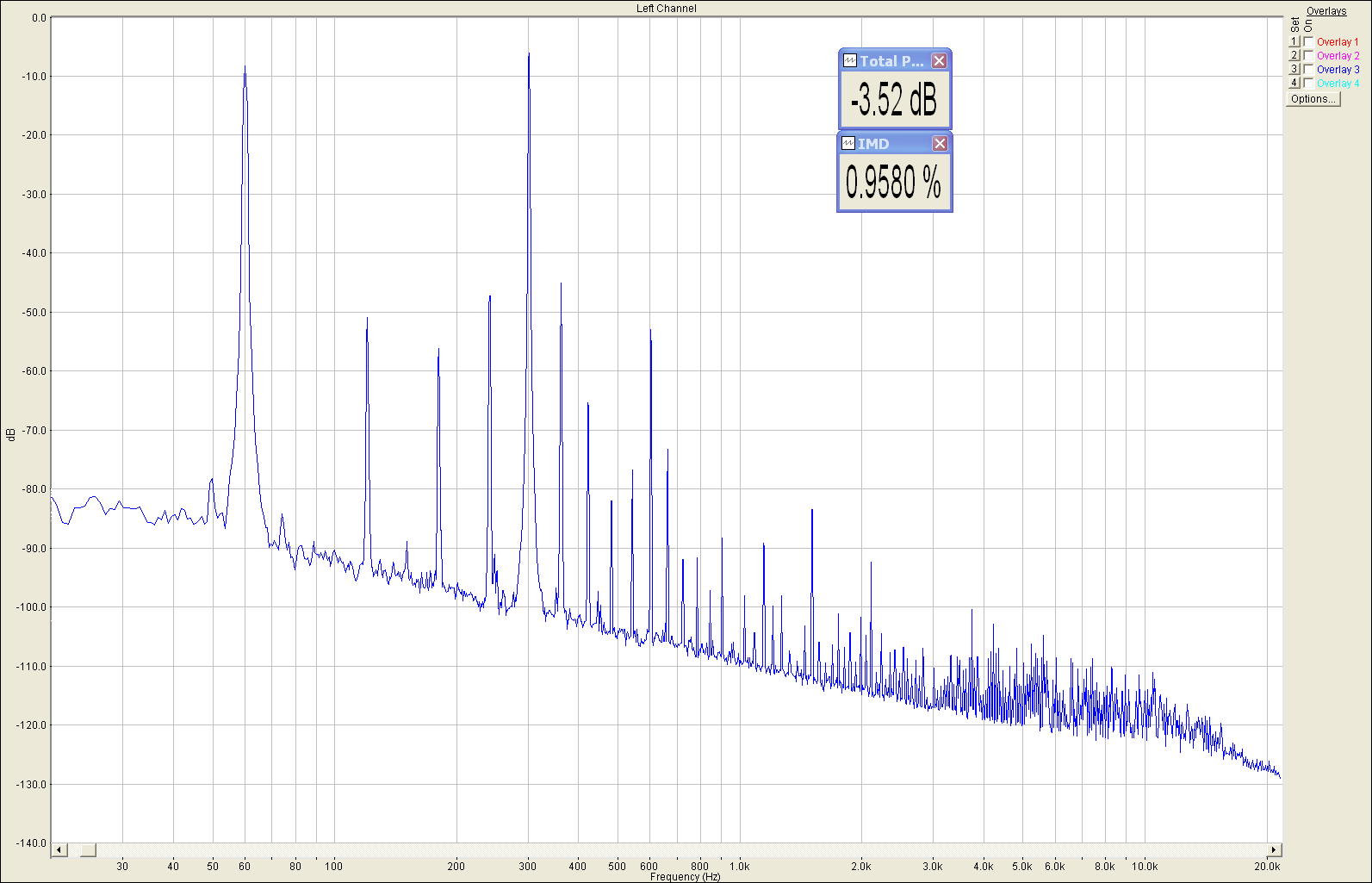

OK, in case that anyone is still interested, there is a test on 60Hz + 300Hz intermodulation
http://pmacura.cz/60+300_speaker.zip
Again, there is an original digitally generated file and a recorded file from 7" woofer, at about 10cm distance, at 4Vrms signal level.
It seems to be almost indistinguishable, so try yourself and let me know your result, possibly supported by a positive ABX protocol.
I originally wanted to use a 30+300Hz tets, but the linear amplitude error from the woofer made it unusable.
Edit: spectra attached. This time I have not removed the room and microphone noise.

The previous 2 files (flute concert and 30+300Hz) had a non-linearity that was described (by transfer curve plot and spectra at various amplitudes) in post
Audibility of speaker nonlinear distortion - test
The distortion was added by Keith Howard's software.
The latest test, 60+300Hz, is an original vs. recorded from 7" woofer.
Also, the list of test files is continuously updated in the 1st post of this thread.

I auditioned the 60+300 samples on my hifi at moderate volume. I could not reliably distinguish them even when knowing which one was which. I recruited an 18 year old to blindly audition as well and the ability to distinguish was 2/3 at best, with a "feeling" that the distorted might have more fullness in the bass in some way. But essentially, so far, no statistical difference. This was in my lounge with some other household noises going on and the whir of a PC. I haven't tried using headphones.
I'm guessing Mooly will find a difference once more...by injecting his own "bootstrapping" distortion? 😉
I would be interested to know the actual mathematical equation(s) you used (as opposed to the transfer function graph).
At higher volume it was easy to tell. One had a more distinctive high frequency buzz to it.

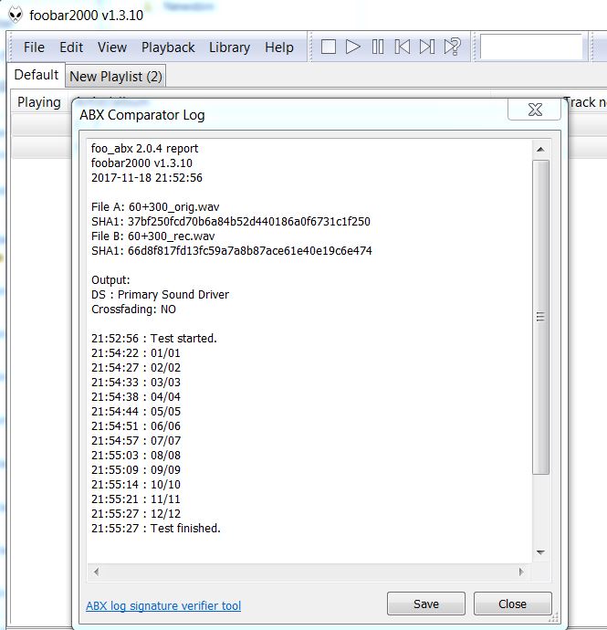

foo_abx 2.0.4 report
foobar2000 v1.3.16
2017-11-18 12:50:54
File A: 60+300_orig.wav
SHA1: 37bf250fcd70b6a84b52d440186a0f6731c1f250
File B: 60+300_rec.wav
SHA1: 66d8f817fd13fc59a7a8b87ace61e40e19c6e474
Output:
WASAPI (event) : Digital Audio (S/PDIF) (High Definition Audio Device), 16-bit
Crossfading: NO
12:50:54 : Test started.
12:51:34 : 01/01
12:51:51 : 01/02
12:52:14 : 02/03
12:52:36 : 03/04
12:53:07 : 04/05
12:53:25 : 05/06
12:53:43 : 06/07
12:53:57 : 07/08
12:53:57 : Test finished.
Total: 7/8
Probability that you were guessing: 3.5%

There is quite a noticeable difference with these. With earbuds, the bass is far more prominent on the original than on the recording.
Code:
foobar2000 v1.3.16
2017-11-18 18:20:28
Output:
DS : Primary Sound Driver
Crossfading: NO
18:20:28 : Test started.
18:20:39 : 01/01
18:20:48 : 02/02
18:20:53 : 03/03
18:21:02 : 04/04
18:21:09 : 05/05
18:21:17 : 06/06
18:21:24 : 07/07
18:21:35 : 08/08
18:21:35 : Test finished.
Total: 8/8
Probability that you were guessing: 0.4%
