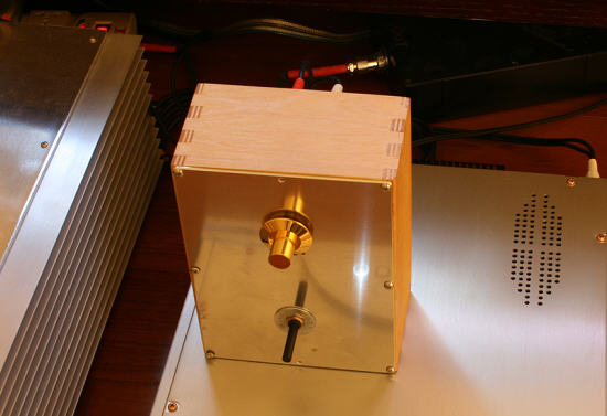

Babowana said:OK, now I completed a new set up for my new living space where
I am free alone.
The power is my F4 of 8W+8W. Do you need any info about F4?
The speakers are again ATC SCM7. I had to buy one more pair as
wife and children forced me to leave the same pair at home.
Wow . . . the F4 delivers big tube sound to the speakers almost
without adding or deleting the tube charactors. Fantastic!
Different taste . . . but I also like my MOSFET pre with F4.
The reason why I am using tube pre here is due to eye attraction . . .
I do not know when I return myself to the MOSFET pre tho . . .
