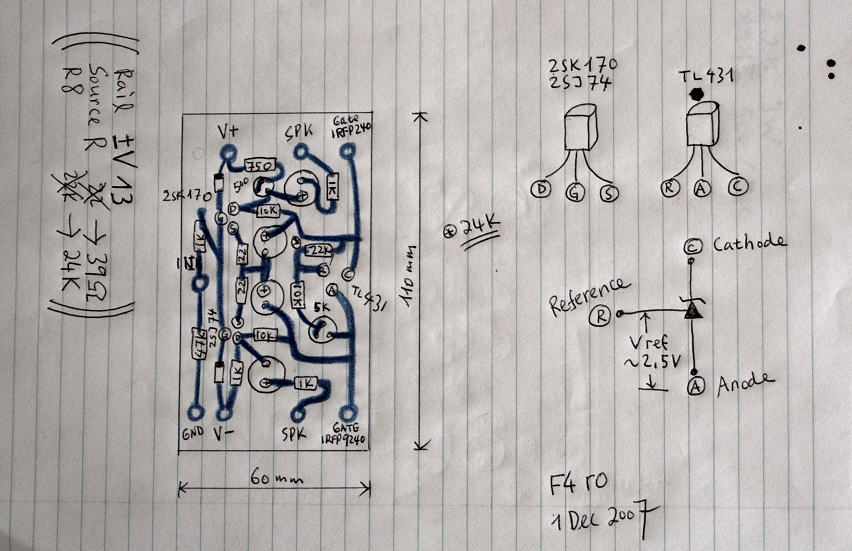

jupiterjune said:Did I see a hand painted circuit board for this F4
You could see the attached photo.

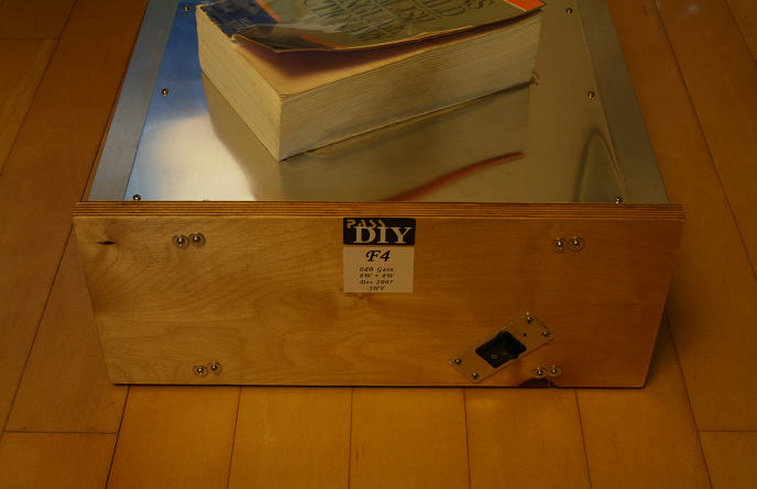

Babowana said:o, I wish I had one piece of Pass DIY logo . . .
Papa,
I'm sorry for having given up the J-Low.
Today, I found the two Pass DIY logos taken from the J-Low.
I re-used one of them to complete my new F4.
I promise that I will never give up both "Zen5 with Input JFETs"
(Babo Zen) and "F4" 🙂
:darkside"
