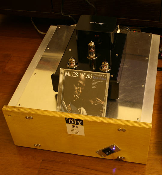

I have already talked about this tube pre briefly. It has the same circuit of the first two stages of Marantz 7 line stage, but with different types of tubes and different values of resistors and coupling capacitors.
Last night, I have changed the current feedback resistor value of 15K to 30K. It has been done to incease the voltage gain of the pre. The gain has been 17.5dB before when the pre has been connected to the input impedance of F4, and now changed to 20dB. And, I have also replaced two metal resitors with wire-wound ones.
F4 seems to be satisfied with this mod. The sound is changed louder and bit more relaxed. Of course, my ears are satisfied too. The latest version of ATC SCM7 do real good job . . .

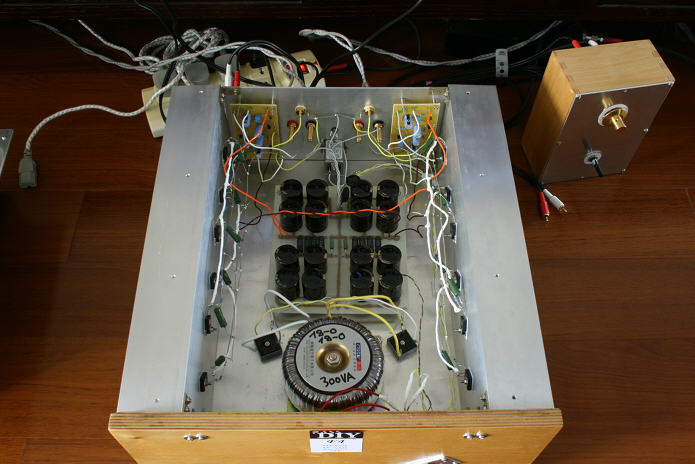

Nothing is forever..
I replaced the transformer from two 12Vac secondary 400VA with
two 18Vac secondary of 300VA.. I just wanted to see whether
there would be any change in sound from ATC SCM7 (power hungry?)..
Now the rail voltages are increased from about 13V to about 20V..
I also replaced Jfet source resistors of 39ohms I have used with
22ohms as the original..
The bias is lowered, i.e. from 1.35A/Ch to about 1A/Ch.. This is mainly
to keep the heat sinks temp to the similar level.. I must be an
outsider of the group who advocate higher bias..
The 300VA trans shows no single problem in feeding current to ATC
SCM7 speakers.. If the speaker is the power hungry one, then it
must be meaning of voltage hungry.. not current hungry..
Through this tweaking, mmm.. I do not feel any noticeable sound
change.. At least to my ears, no change.. just keeping nice sound..
