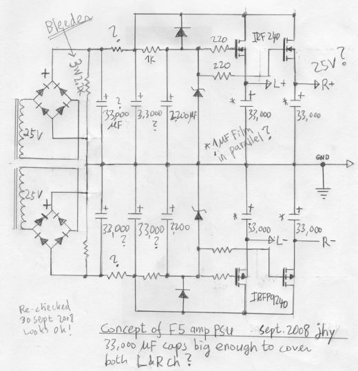

Re-attaching the PSU concept, including the bleeder. . .
Now considered better?

As I do not receive any comment from you, I like to go with this PSU for my new F5. The reasons are as follows:
1. I like to use the 2nd-hand 2x25VAC 500VA EI-transformer. With this PSU, I could cut off the rail voltages down to abt +/-25V and, at the same time, I could have better voltage regulation.
2. One PSU could cover both channels, saving four psu caps of 33,000uF or slightly smaller ( the size would depend on the availability in the shop).
3. This PSU does slow satrt (with 1k and 2,200uF).
4. This PSU has a bleeder (of 2.2K3W) that could drain the heavy caps in short time when the amp is turned off.

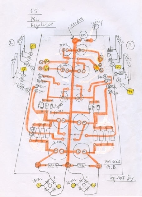

I have just finished my plan of PCB for the PSU, waiting for my 3rd chemotherapy treatment injections. I wil post the Sketch of this PCB one week after the 3rd treatment. . . 🙂
Here you are.
My F5 PSU PCB is quality of a hobby-grade, not commercial-grade.
As this is a DIY, I just made for my own DIY, without thinking about any beuty too much on it. . .
The pcb shows six jumper wires marked with dot line. . .
Any comment? Thanks 🙂

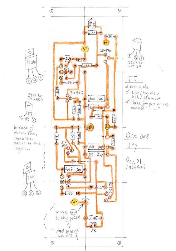

My F5 AMP PCB is also a quality of a hobby-grade. . .
including three jumper wires. . .
Few of diyers dislike the jumpers. But, for me they are OK because
they are just the same as resistors of almost zero ohm, which are
arranged on the pcb as many other resistors.
The NTC is arranged near to the drain pins of the MOSFETs. . .
Any comment?

Very Nice
I have been waiting for a while to make this amp but no boards. Your doing far better than I could ever dream of doing.
Comment:
Down the bottom, where your 'link' comes from the V- rail, maybe you could make this junction your main input point for the v- supply(and remove the other rail running up the back).
Then go directly up from this point following the line of the 'link' to where your v+ joins onto the v+ rail, that 'T' junction. Maybe make this your main v+ supply point. You would have to make a 'link' underneath, that would come up to those two resistors though, like you have for the V- rail at the bottom.
That will still look neat as the v- & v+ will be inline, but opposite. Then you will have some space on the side of the board that could be cut down so the FET's could be closer the edge. and easier to mount......
Does that make sense?
Maybe not a good idea, I have never made a board up so ignore this if it all sounds stupid.
Regards
Brett.
Sorry.....been beat'n to it..
Zen Mod said:
local decoupling PSU caps ?
you can also cut that V- trace , and left it on bottom of drawing (pcb) , so you'll have V- down and V+ up
Are you referring to PSU or AMP PCB? I guess that you are referring to AMP PCB.
Please note that I'm using one-sided PCB, not double-sided. . .
Anyway, I see your point. Thanks for the input!

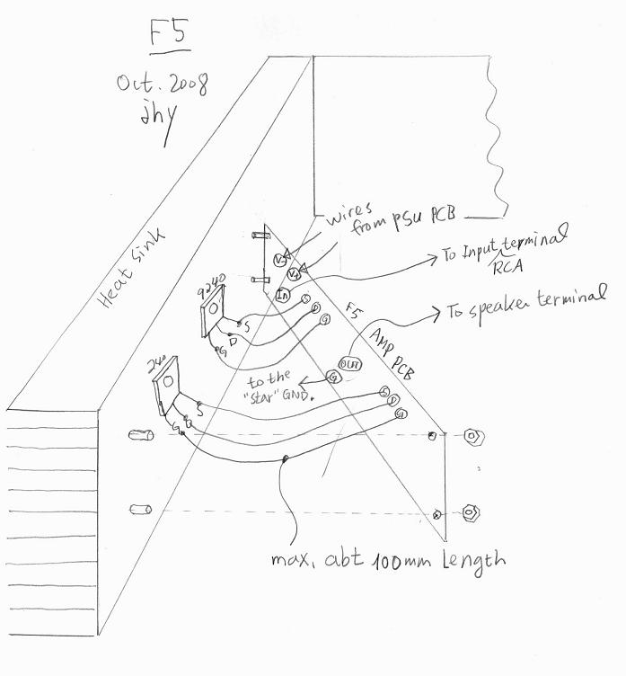

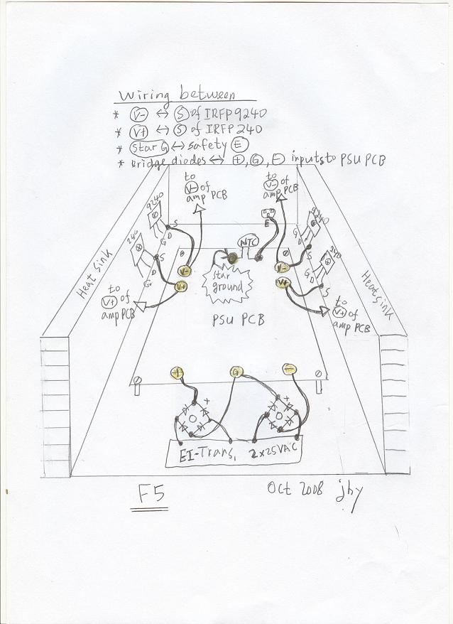

By the way, I'm attaching another sketch showing the connection
points between the PSU board and the neighbouring components. . .

enzedone said:
What about cutting that track running on the other side. Just make a trace running directly up to the (1K?) next to the 2SK170. Then where the 100K(?) going to ground is, make a "link down to the other side of the 2SJ74. That would also cut some width off........ sound o.k?
Sounds stu. . .? No, no.
You have good and valid points. . .
I will change some part(s) of AMP PCB based on your comments. . .
By the way, I will arrage the MOSFETs and the AMP PCB vertically
as shown in the attached drawing.
